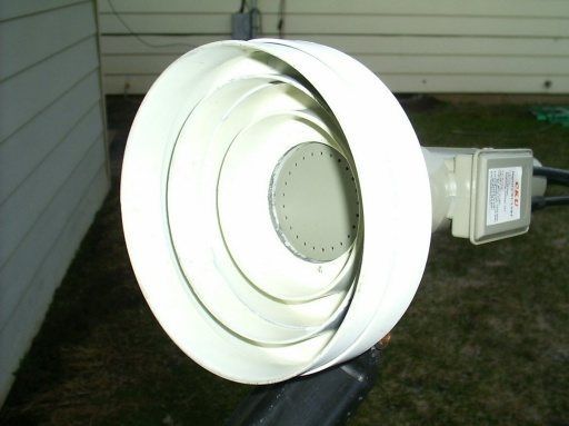

You are best to use a conical scalar ring if you have one, but I feel its still worth trying with a regular scalar if that's all the OP has!
