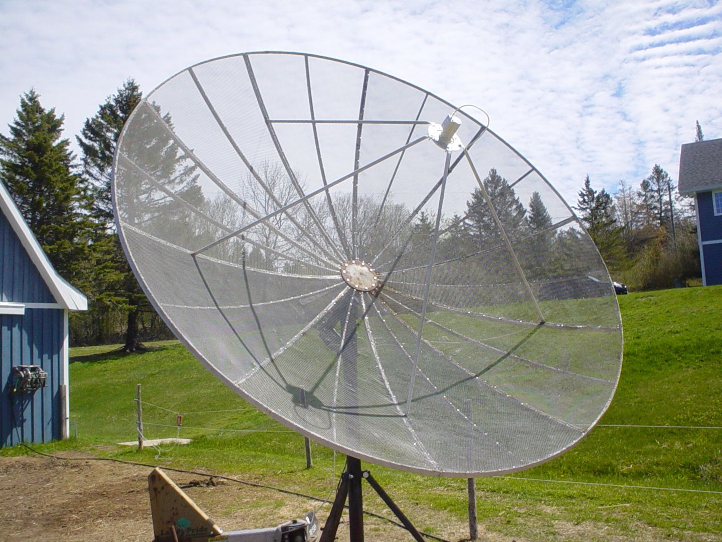

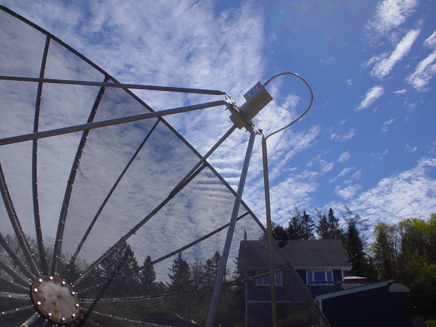

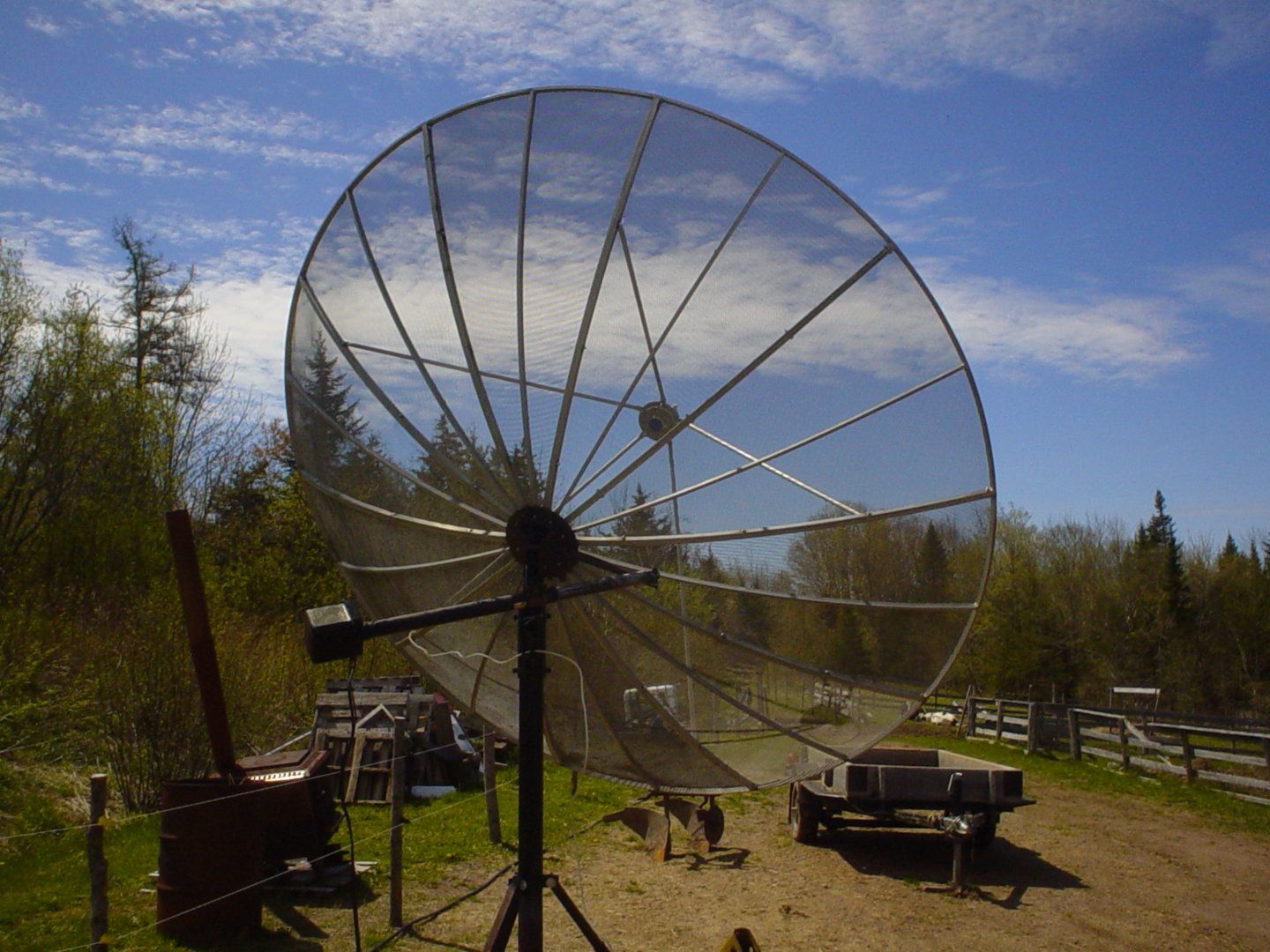

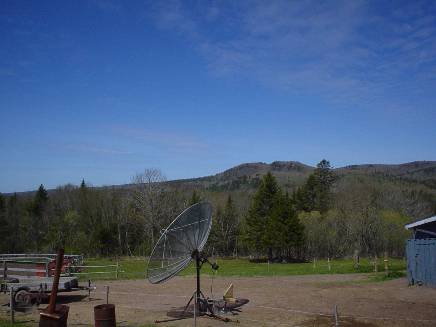

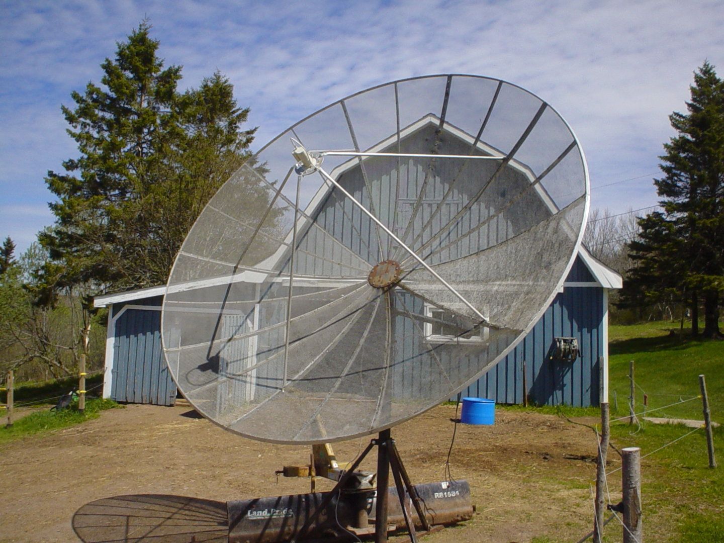

Well I finally got my 10 ft mesh dish back together and working.Put a new C-band LNBF C1W-PLL lite Wideband 3.4 - 4.2GHz that I got from Brian and it works very well.Really pleased.Even watched a little bit of Green Acres on Galaxy 17.Still have some more tinkering do do with it but it is 95% there.Need about 200 feet of good coax to run to the house now.Even have a few pictures of the final resting place for this old dish.Love this new hobby!Thanks!
