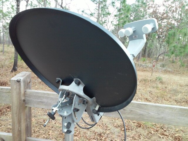

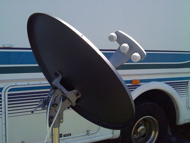

Are you sure about that? If the dish was a 1000.4, then it should have come with either an EA DP 3-LNB or a DPP 3 LNB assembly. I have a DP 3-LNB assembly that was originally installed on my 1000.4 and which I used for years with my DPP33 to feed a 722 and 2 612's. I believe there was an extremely rare WA DPP switch made for a 1000.4, but I can't imagine that is what the O/P has. Plus, the only switch that reputedly works with a DPP LNB assembly is the DPP44 (which turns the internal switch off), not the DP34 which the OP has in there. Correct me if I garbled any of that. IMHO we need to know what that LNB is before we waste more of the OP's time. He can do that if he follows your instructions to remove the switch, and my instructions to use the 722 to tell us what kind of LNB is up there.
I have both EA and WA LNB's for my 1000.4. Both are triple horn DPP's and were originally used with a 211K before I upgraded to an H2.

Huh. I don't see any 3-feedhorn LNB/switch assembly other than the EA DPP one that got replaced with the hybrid when I got the H3. What is in my drawer full of old Dish stuff is a WA DP twin, and a bunch of DP duals, which I had when I was mixed-arc. So you might be right about the DPP WA LNB that the OP has. Yeah, that installation was bungled badly if the OP can only pick up 110/119.

Another thought occurs to me... Perhaps the installer (whoever that was) used the EA LNB on the WA. Might that get only 110/119?
It could, and that may explain the low signal strength, since the spacing between the satellites is slightly different, so that LNB is not optimized for the other arc. It is the same principle as using the old Dish 500 LNB's for EA. It works, but it is not ideal.
