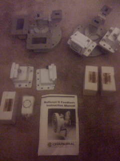

I got the switch that Anole recommended and made the modification for power.
Would anyone else have any other suggestions for installing an orthomode feed?

(try: your two C-band LNBs to the non-22khz inputs, and your two Ku-band LNBs to the two 22khz inputs)
Thanks for the advice. I will have to dig out those old posts. Trkracr offered his help a year ago...he's local. I might have to look him up if I run into trouble. But really...after reading most threads, I should have it. Thanks again for the props and incouragement. Here is a pic of my package! Whoo hoo! $40 per Bullseye II...unheard of!!! Worth the wait in shipping!
