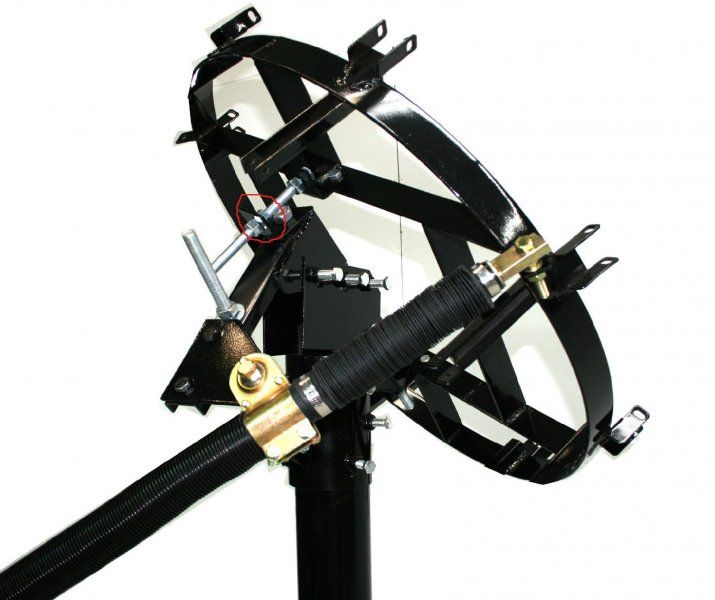

I'm going to use it for the arch that plate is the one that will have to bend 90 degrees?
What is the 90 degree plate that I have to bend, if I use it to have the full arc?

The 90 degree plate is for declination, at the top of the mount. You will know it when you see it. Once you bolt it on, use a couple of adjustable wrenches to bend it down for your area. (It's no big deal, but should be done.)

Thanks
sure, all your antennas 12ft come with the focus wrong,and I will have to drill
the good thing that in my city the winds are almost null there is not
and when there are, they are not so strong
you can mark me in the image the part that I will have to fold,to get the whole arc
I do not know, if it's where I put the mark on the image

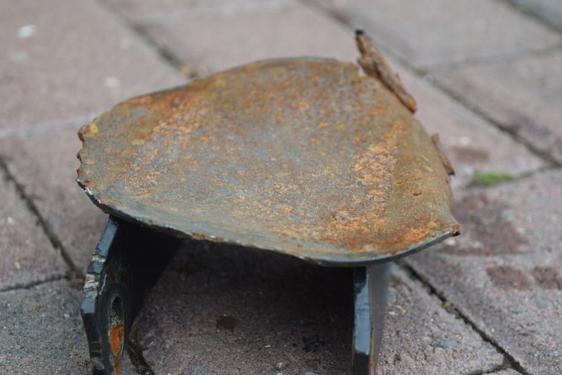

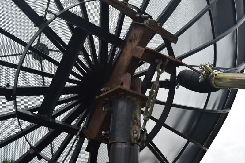

I bought one of these a few years back.. During a winter storm, the metal mount bent and sheered (ripped the metal like it was paper) and by the end of the storm the dish was laying on the ground. I ended up finding a used mount and Frankenstein'd it in, and threw out the Tek2000 junk mount. This last summer i replaced the 3 bad panels, and i have the dish in tip top condition again.
From those pictures you posted it still looks like their beefed up dish is not beefed up enough! My dish tore itself apart in about 30 mph gusty winds. I would highly suggest welding the heck out of it if anyone is going to keep the original mount unless your dish is completely protected from winds.
The picture below is the Tek2000 dish with my hacked in mount before i painted and cleaned it up.
Here is a failure picture of the original Tek2000. Note, that it is the cap plate that tore off from the pipe sleeve that slides down on the pole. .. It wasn't thick enough, and from those pictures, it doesn't look like they addressed that.

That part that I mark, I see that they place it in two ways, as it is in the image that I mark, or towards the front, what would be the correct one?
I can't say this will "get you the full arc". This is for modifying the arc needed for your area. Bending the plate just makes it easier to work with. If you don't, you'll have a hard time putting the bolt through the next plate as it will sit high, causing you to loosen the two bolts to give you the leeway to get it in line.
The orientation of the "circled" plate is really backwards. Why? Because you want to lessen the strain on that bolt by turning it around and shortening up the bolt's exposure to stress. (That was a good question.) I didn't really show it, but on my first pic, I have it reversed (the right way).
