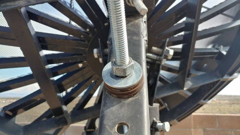

What's the purpose of the bracket up top by the dish that is protruding out? Why is that happening? Why are the bolts constantly loose after moving the dish?

Its the bracket higher than that closer to the dish. I can track fine from 34.5w to 135w. The problem is on top of the pole. 3 holes on each side. Why does that bracket stick so far out and the bolts don't touch anything? Do ya need a better picture?

yes i could not tell what is what, i need much better pics back away to close is not always good show about 10 pics if you want my help
The two metal pieces with the three bolts on each side are supposed to be vertical. They must have gotten bent out during shipping. Be careful about those welds if you try to bend them back vertical. They are intended to put pressure via the bolts on the elevation arm so it doesn't rock side to side when the dish is swung to one side.

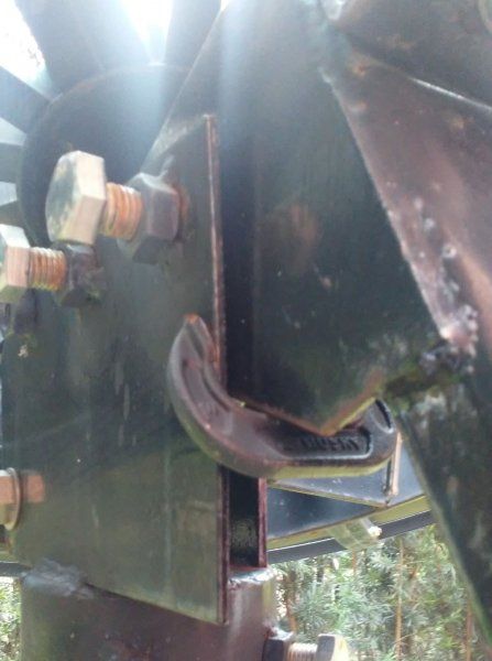

I have an earlier version that only has one vertical piece. I ended up putting a C clamp on it to hold the mount in place.
So, if bending it back might be riskfull, maybe another option would be to use longer bolts, to apply the pressure needed?

Thanks everyone. They are not vertical. I could tell that the swaying of the dish could be a problem especially on windy days
Sent from my VS995 using the SatelliteGuys app!
I have had a similar problem with my dish. The metal used on the saddle is not that thick on the vertical sides. So when you screw down the three side bolts when you hit the elevation arm and continue to screw the vertical saddle mount starts to bend away from the elevation arm. The manufacturing flaw isn't that it wasn't made vertical but that the metal used is too thin. This has been addressed in the latest version of the dish I believe. What I did was to re-bend it close to vertical and once the bolts make contact to only screw it in an additional half turn. I do like the idea of using an external c-clamp to pull it in on the top and it's something I will consider.

Here is a picture of my mount and clamp. This dish was from 2015 and only has one vertical piece.
You could get a wider clamp and go around both sides if you have the newer mount.
Reactions: MikeI
