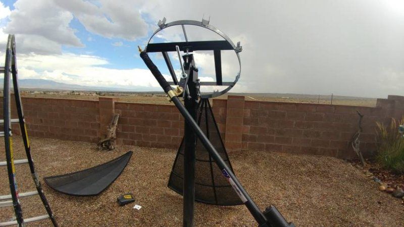

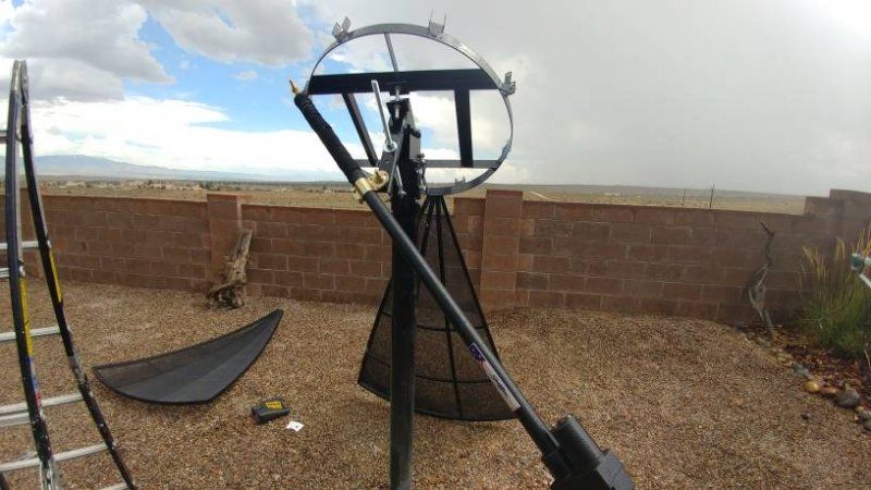

I want to let the cement cure for 5 days before putting any significant weight on it or tortional stresses but I did figure I could install the saddle mount, elevation mount and polar screw with the brass bushings. Here are the first two pictures I took of this part of the installation along with a question.
That first pic is pointed up towards the sun a bit so it's a little washed out but my initial question is the gap between the top nut and the washer. Is that going to cause a problem? Looking at the angles involved I don't see how to avoid that nut and washer not lying flat on the elevation arm and if I shifted to the bottom hole on the saddle mount I think it would make the angles even worse.

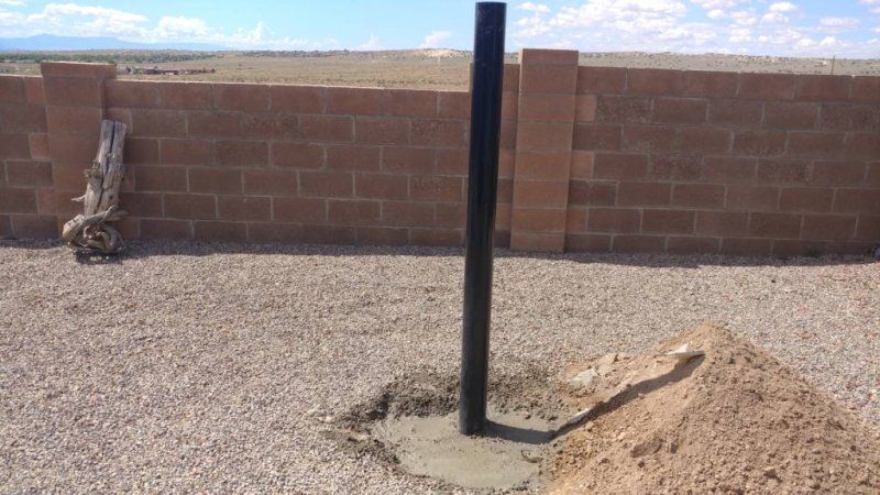

Did you bury the pole 2.5 and left 5 ft above ground? I measured 81 inches so there's not much wiggle room for space different from that? How much clearance do you have at the end of your arc from the ground?
East for me is low so 40w is 10 Dec above horizon. Any problem for you that low east or west? Thanks
Yes. I measured 30" from the end and buried it to that point with about #500 of concrete and added another bag down the pipe after the cement set. I can't go that far east/west so can't help you. My true south satellite is 87w and there is nothing on c-band east of there that I can get now. On KU I can go to 62W but the other c-band sats between that are aiming at South America. On the West because of trees I can get to 121W right now. When the leaves fall off the trees I can get to 129W. Doesn't bother me that much because everything I want to watch is usually between 91W and 107W so I'm happy. As far as if clearance is enough ask me in the springtime. I'm going to have to do a lot of snowblowing under the dish because there is only about 18" between the bottom of the dish and the ground and I can get that in one storm up here.

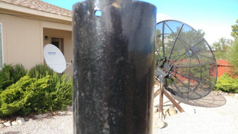

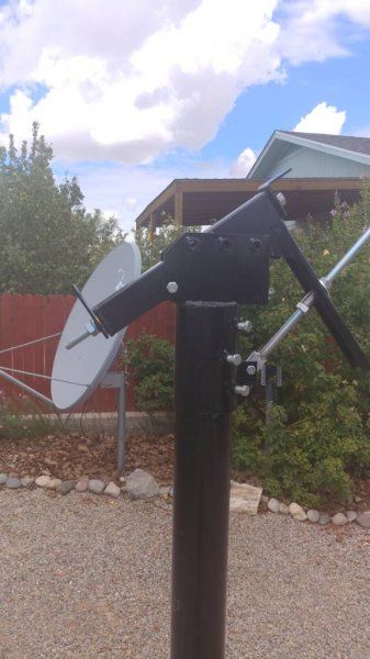

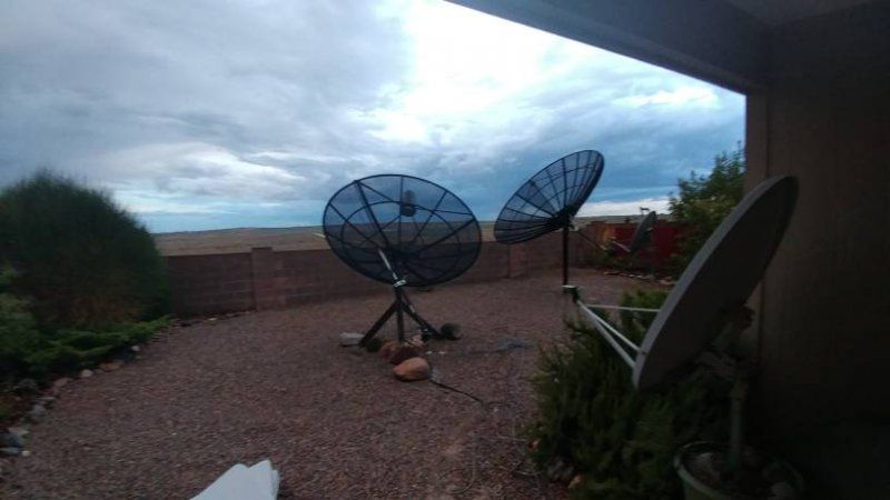

Thanks. I buried mine today. Does the hole at the top mean anything. I didn't see It til the concrete was poured. I used all 14 bags. It gets windy here in NM especially in the spring. My due South is 107w. Picture looks crooked but the lowest I have on the Inclinometer is 89.8. Dead center on top with the bubble thing they sent so I think,I'm good.
Reactions: iBoston
The "hole at the TOP" was probably meant to be on the BOTTOM, with a bolt through it so the pole can't spin in the cement during extreme winds.
Did you drill a hole, and is there a bolt or something through the pole and buried in the cement? If not, "oh, oh!"
If he got the pole from Tek it's got wide wings welded to the bottom to keep the pole from rotating. I'm jealous of his wide open area for his dish. Should be able to see the whole arc.
Yes from tek. There are wings on the bottom so that got buried of course. There's just one hole on the other end. I checked the mount thingy in the garage and didn't see anything that would match with it. I will take a picture after work.

The pole looks crooked, but it looks parallel to the wall behind it. Probably just the angle of how the picture was taken that makes it look crooked.

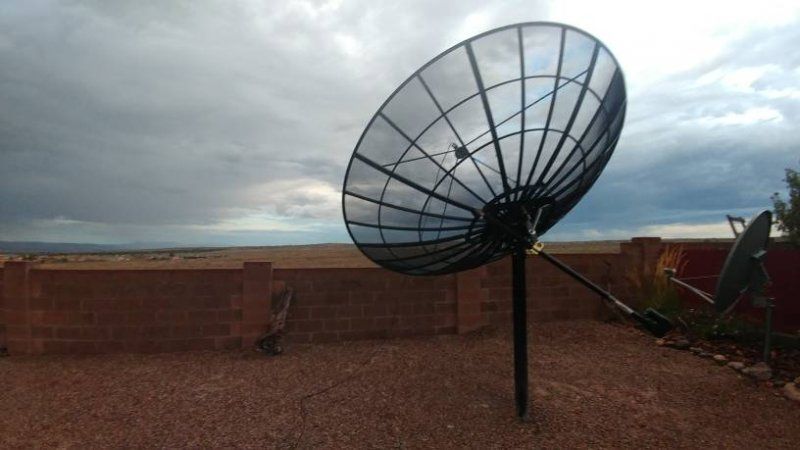

Did you assemble the dish on the mount like Tek's instructions say or did you put it together on the ground and then put it on the mount? I tried one panel at a time on the mount and it didn't work too good for me.
