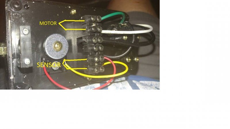

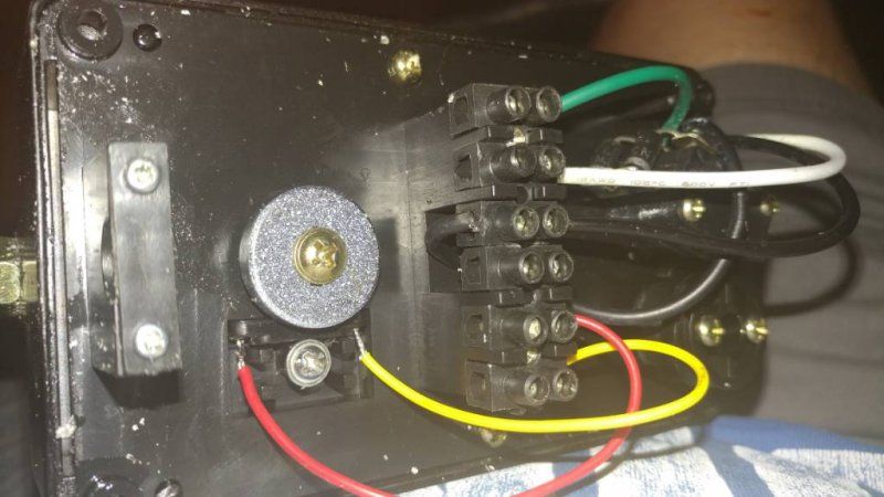

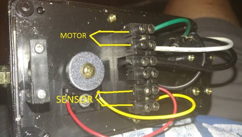

Did anyone get their 36 inch motor for the 10 footer? What color wires are the motor and sensor? Is white and green motor and yellow and red the sensor? which one is ground?

Are 2 wires a heavier gauge? If so, those are the motor M1/M2 wires. The lighter gauge are sensor S1/S2. Typically, the distribution shield drain wire is not connected to a ground at the dish, instead connect it inside to the controller ground or to an equipment ground (grounded to structure ground). Connecting the shield to the motor/dish just introduces noise and voltage potentials.
Also, be sure to bond the dish to your structure ground to avoid voltage potentials. Having multiple grounding points without bonding them often creates problems and it is best practice to balance any voltage potentials.
Superjack motors historically have issues with the brushes prematurely failing. They can get quite noisy as brushes fail, but otherwise not a problem. Another distributor used to sell these and the motor brush braid leads are not made of fine flexible wires and tend to break at the solder wick points. If you have positioning /count issues and suspect excessive motor noise, install a capacitor across the motor terminals (inside the actuator). This will limit the noise from feeding the distribution line and entering the sensor circuit.
