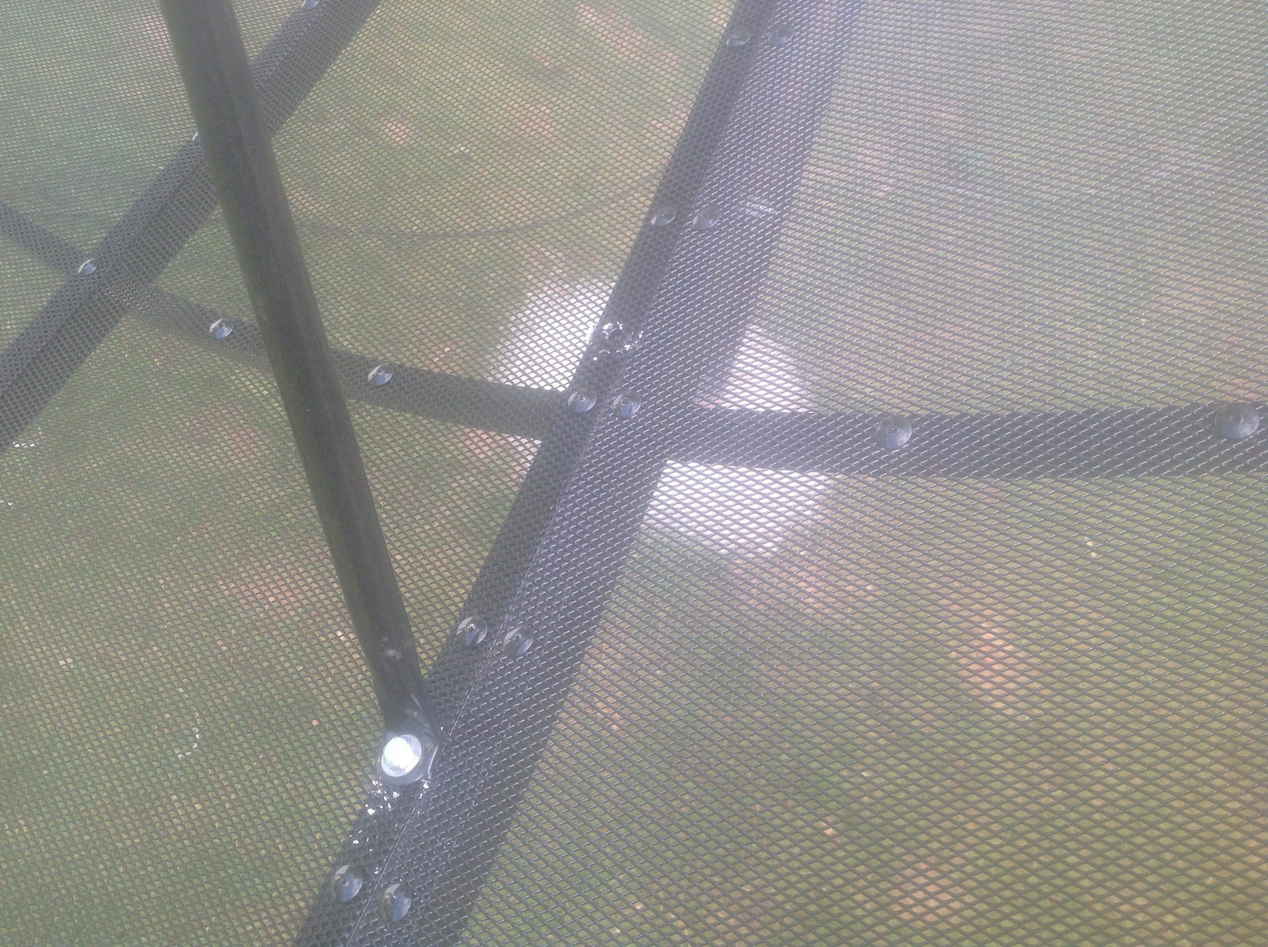

Newbie here - admittedly coming in with a lack of information and a thirst for knowledge. Can someone enlighten me on the wire mesh panels that are being used? What is the gauge on this material? Also - is this a woven wire cloth - something like a what I can buy at Belleville Wire Cloth or am I way off base? I cant make this out in the pictures and I am unable to get a real answer to this online...
Any and all information on this topic is appreciated - I realize for some this may be one of those - "no-brainers"!
:welcome to SatelliteGuys flooringguy23
Most mesh is made from "expanded metal" not a woven mesh. The best is perforated metal. The tighter the mesh the better the Ku performance.
