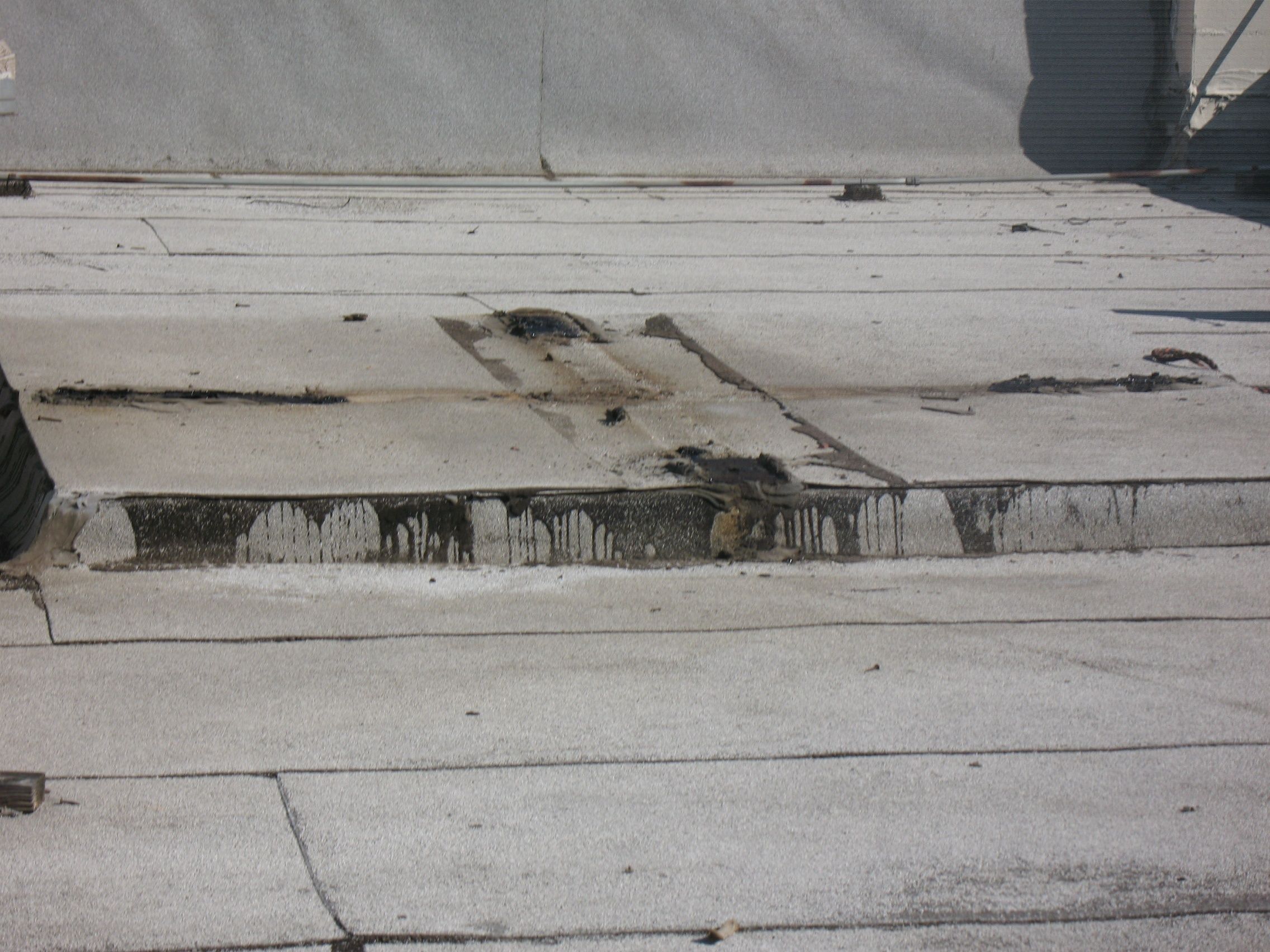

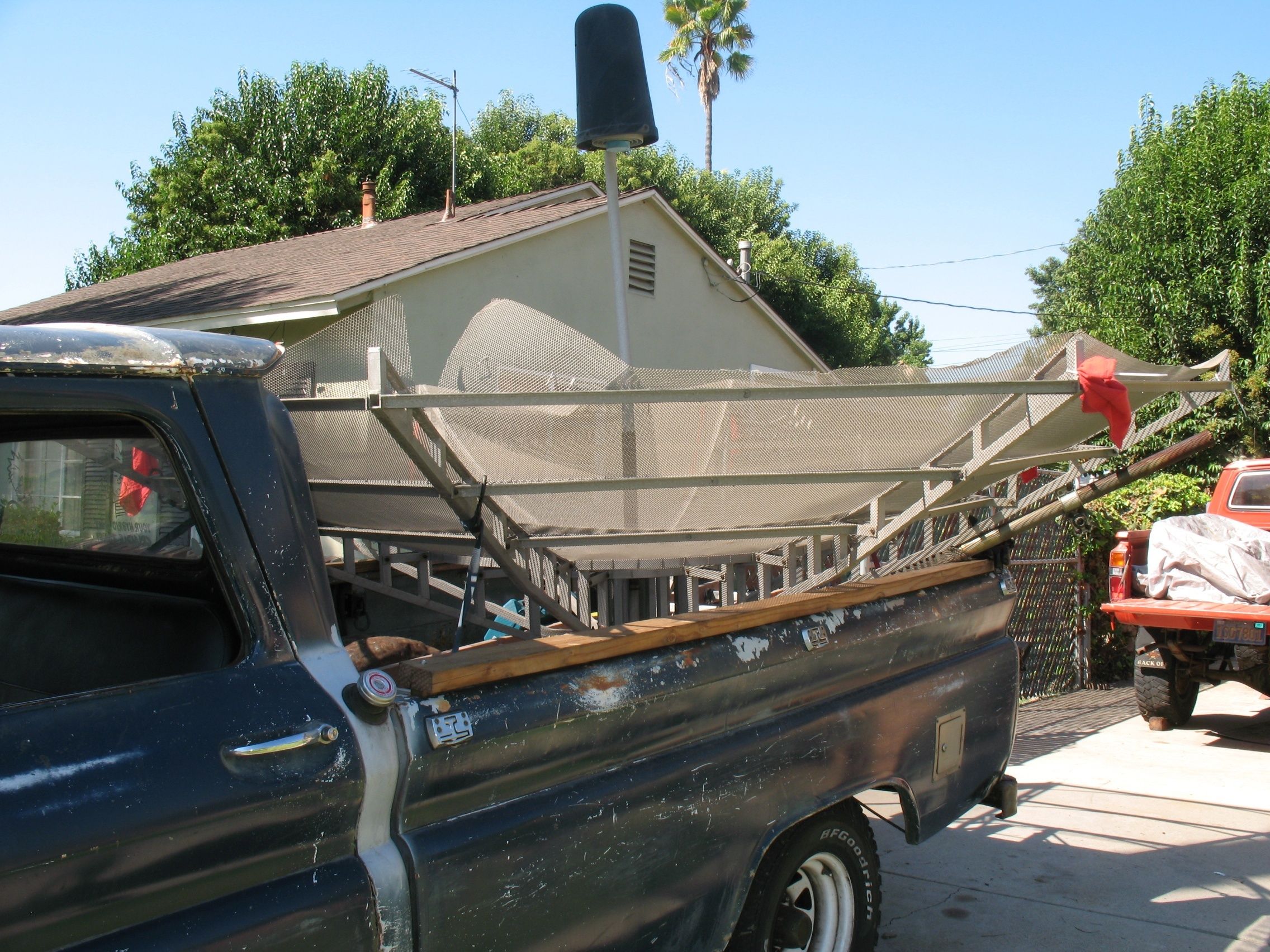

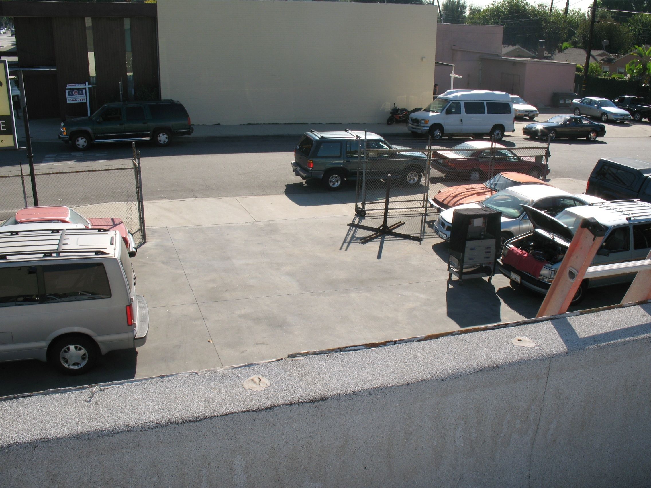

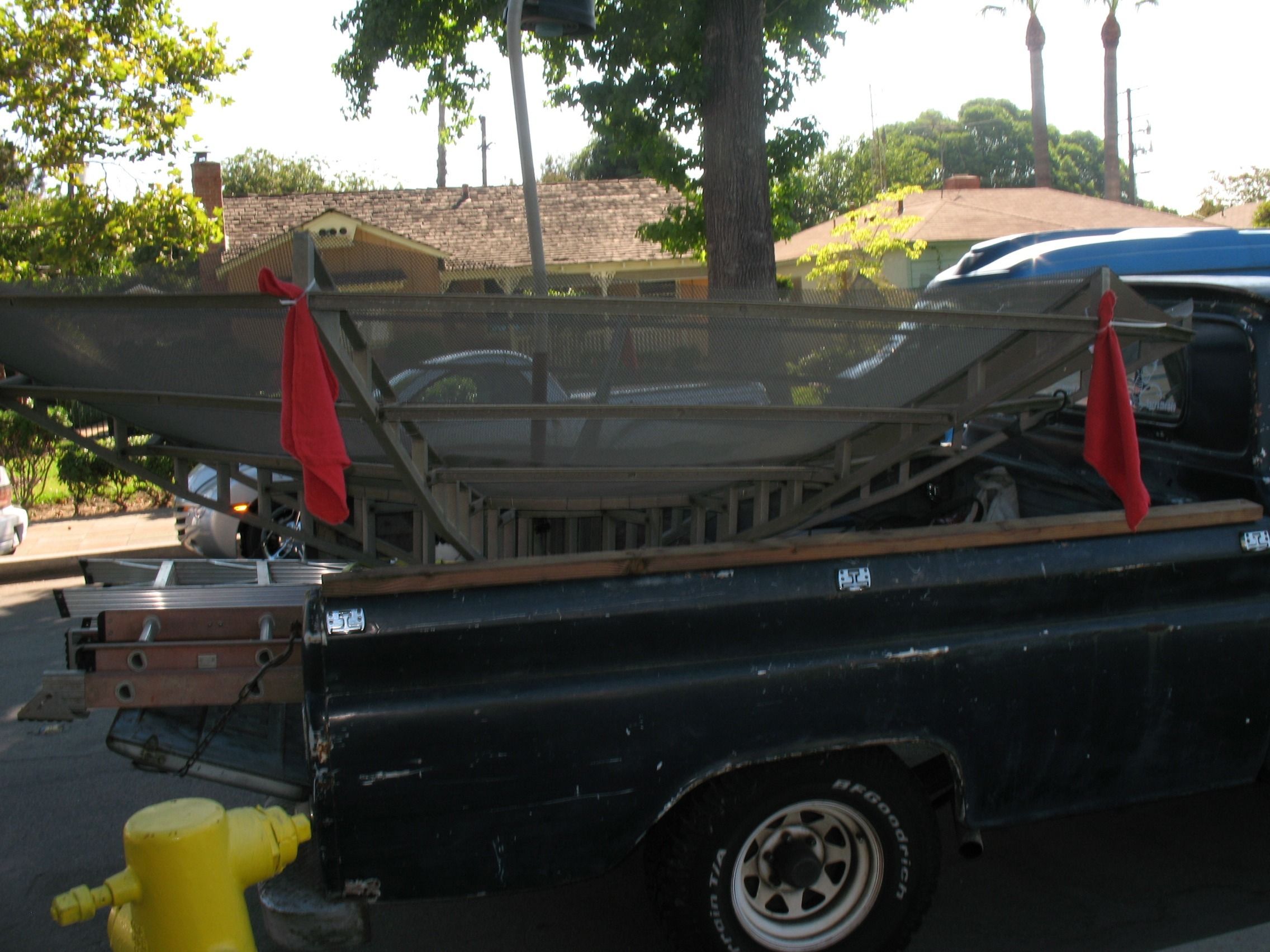

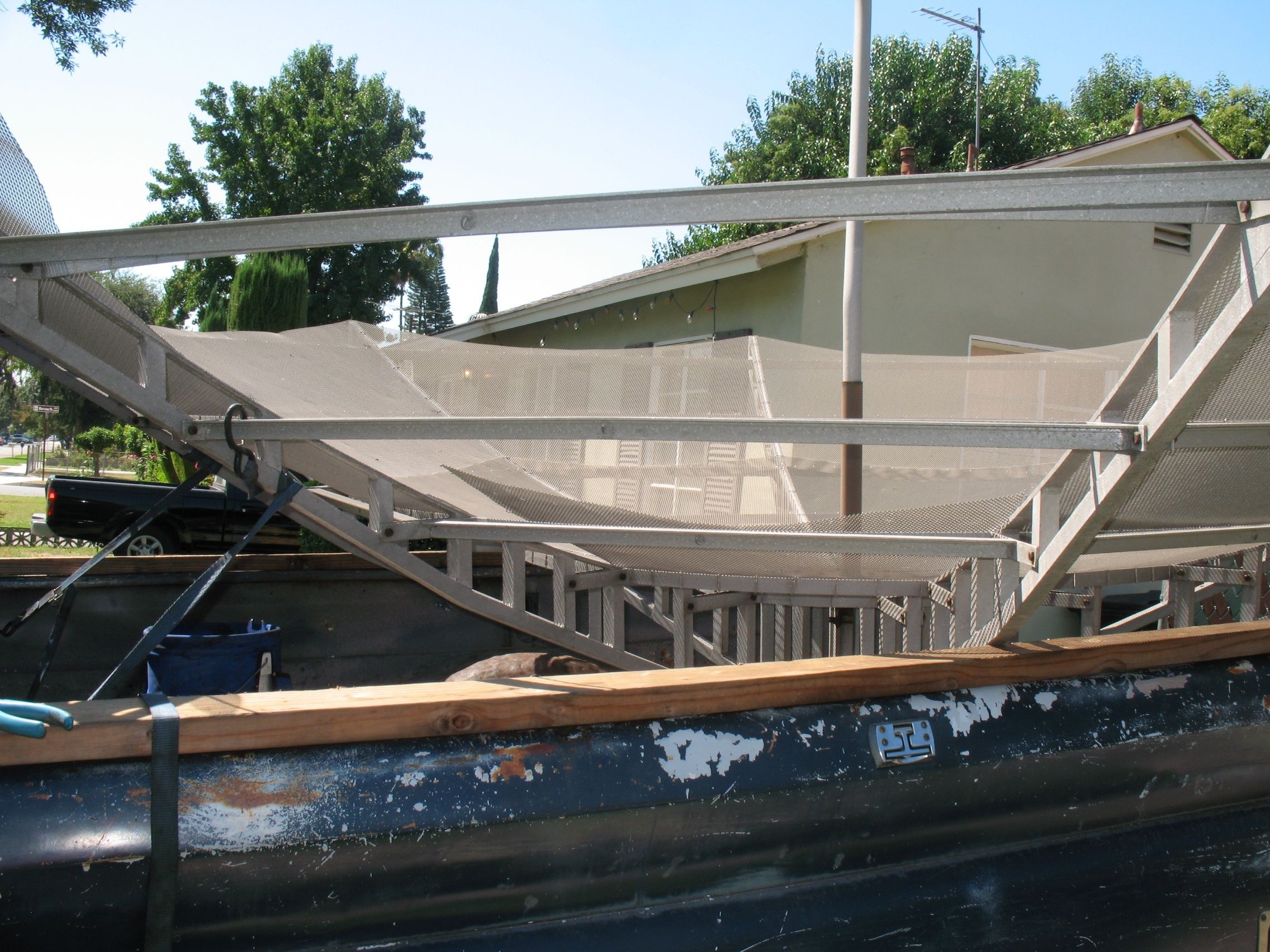

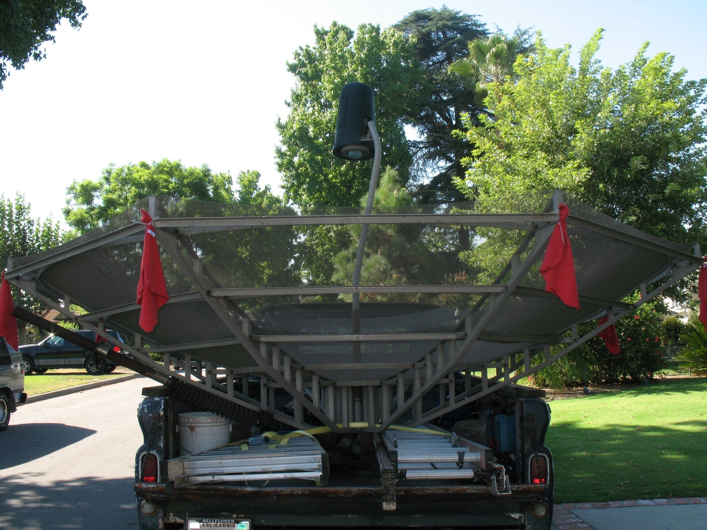

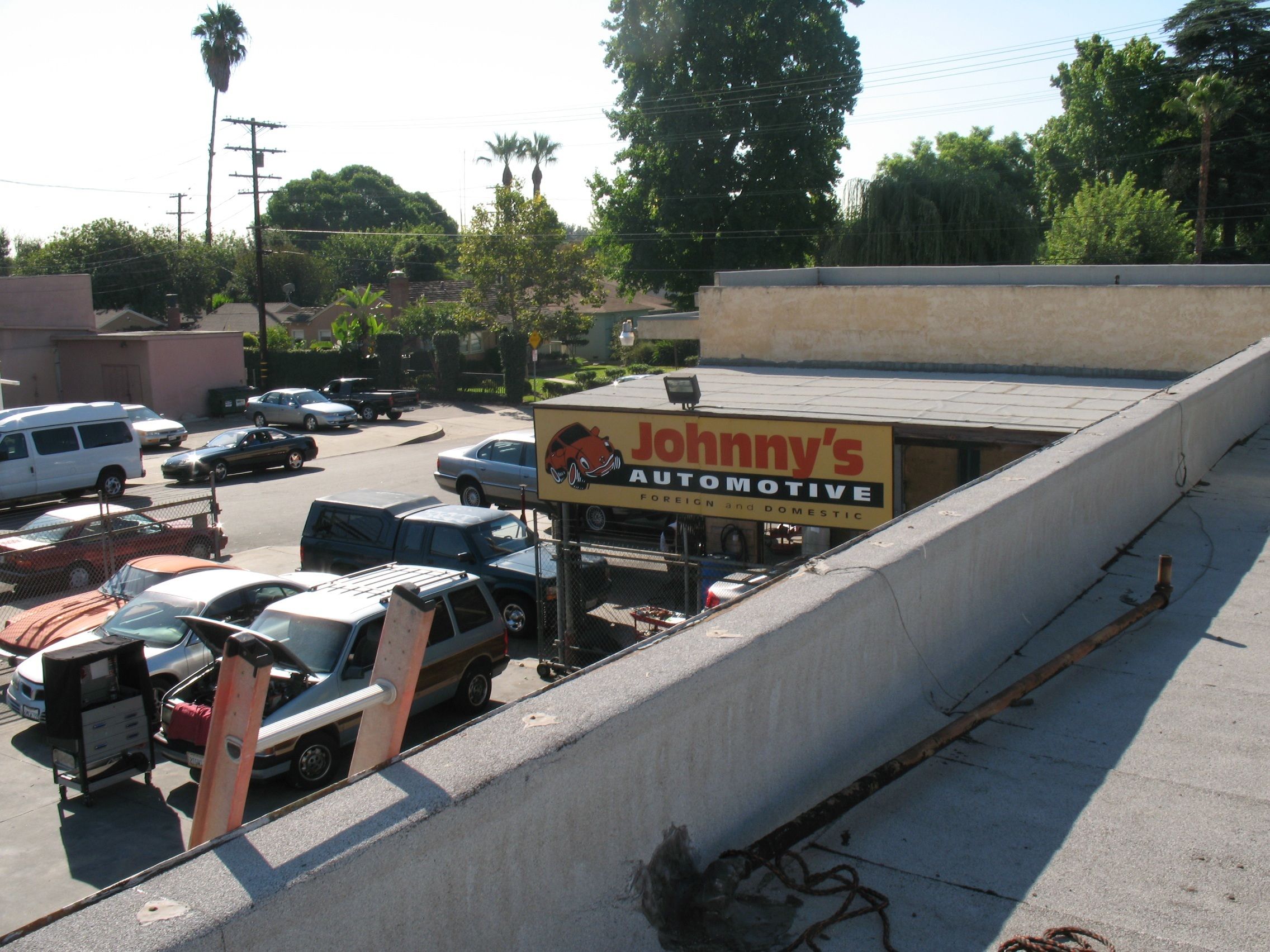

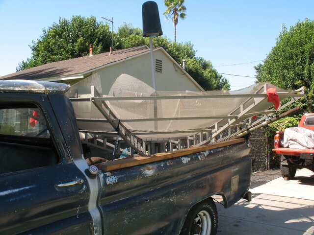

picked the dish today
I didn't get any pics of the actual lift this morning. The crane operator insisted he had to get down to Cerritos by 10 am so I was forced to hurry & neglect the pics.
It went smoothly he providing two 14ft slings to lift the dish. I spread the load between two frames 4 apart from each other. Loosened the polar mount bolts on the pole, removed one elevation turnbuckle bolt allowing the dish to tilt down then twisted the mount back & forth while the crane lifted.
We set the dish on its back in the bed of my 65 Chevy fleetside, then picked the penetrating pole. From start at 8:30 am to finish at 9:30 am one hour. Tie the dish down & re flagged the overhanging edges. Drove home with emergency lights on( only 5 miles).

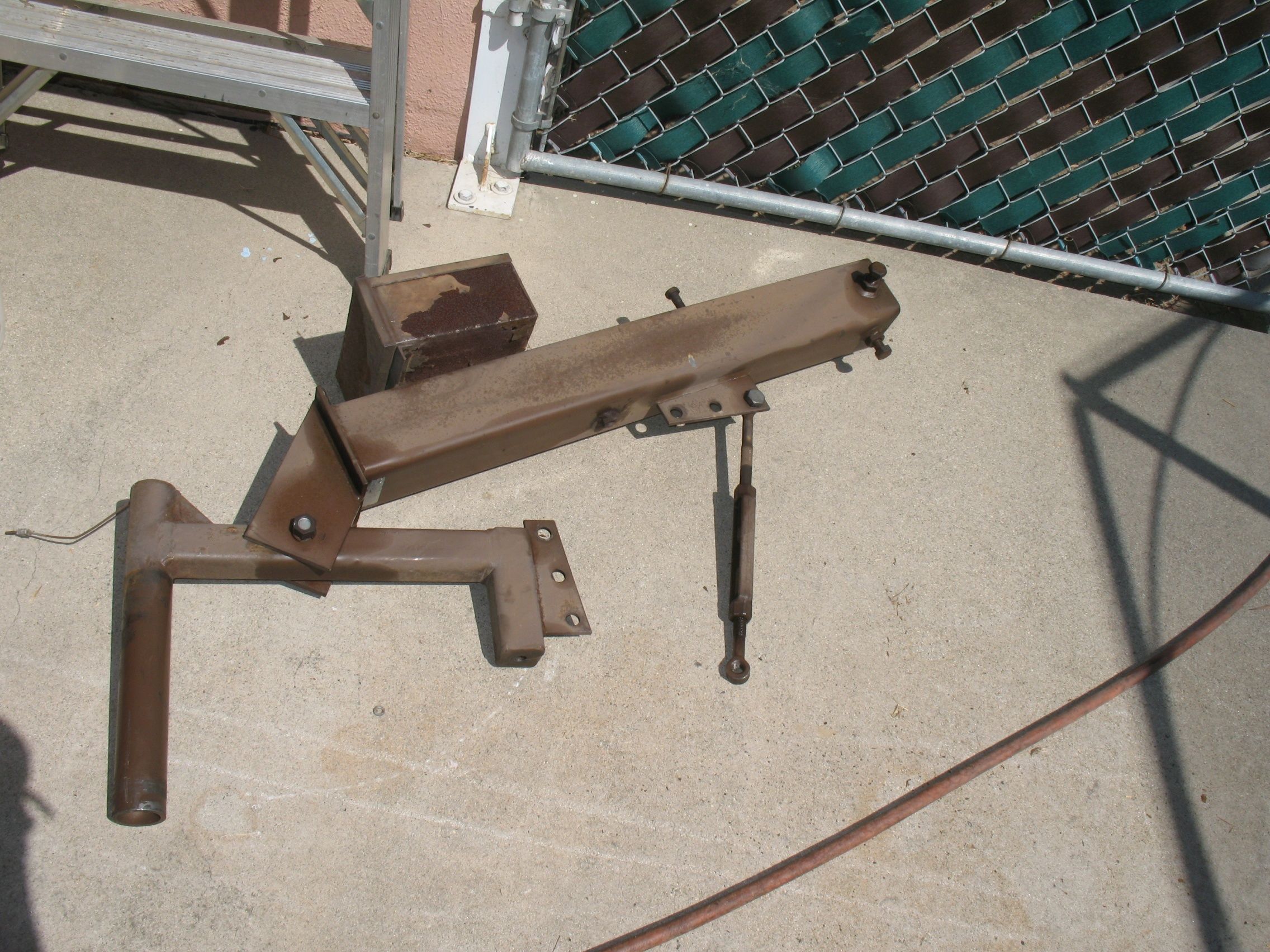

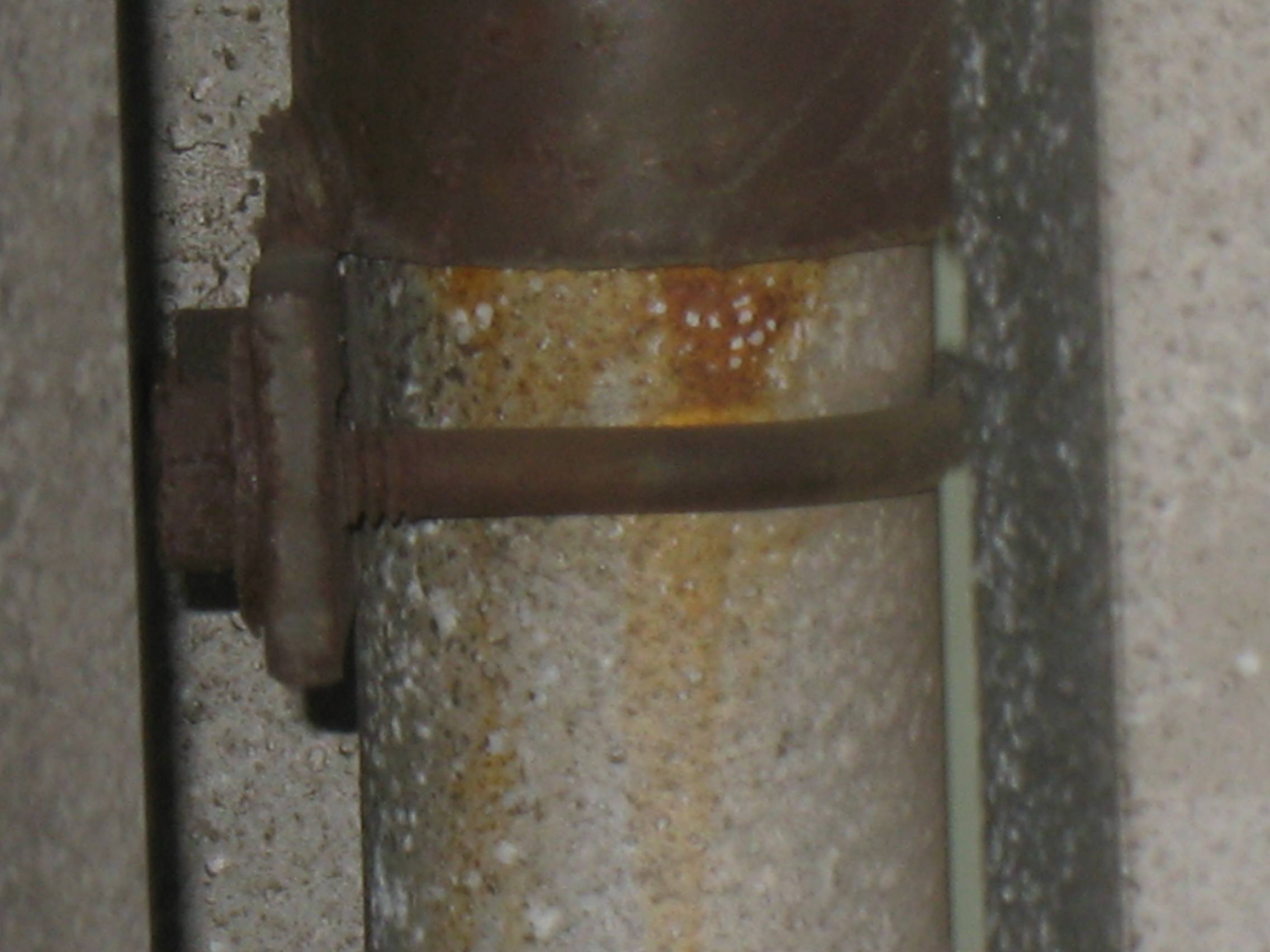

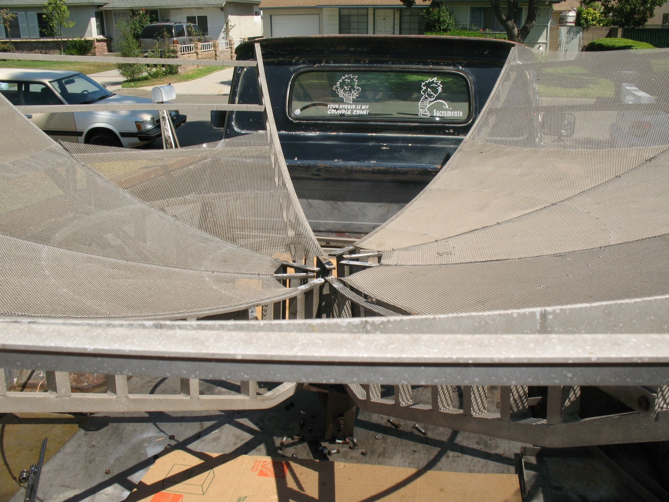

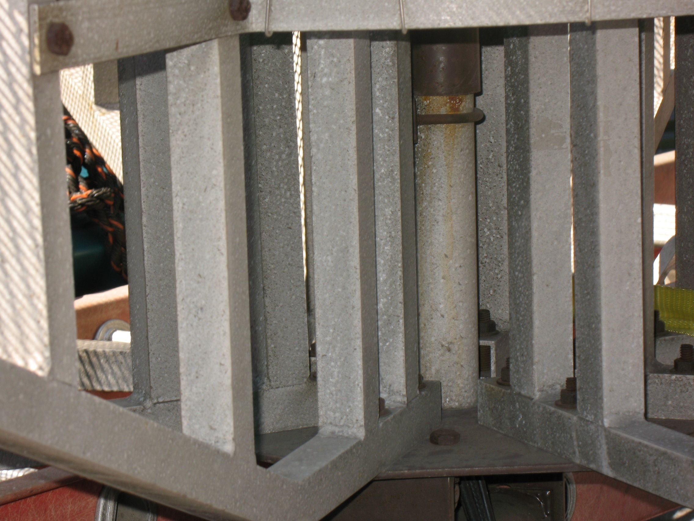

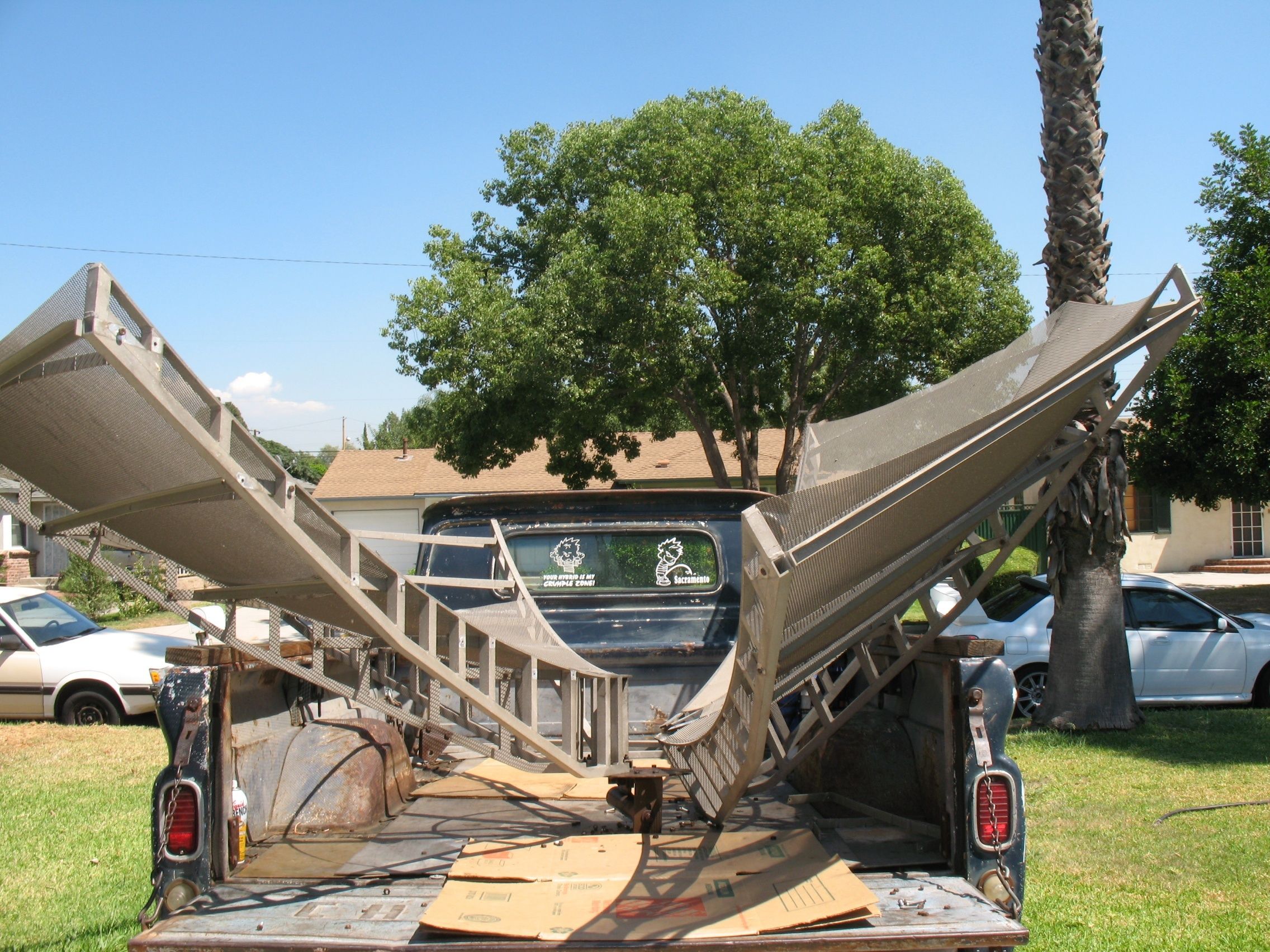

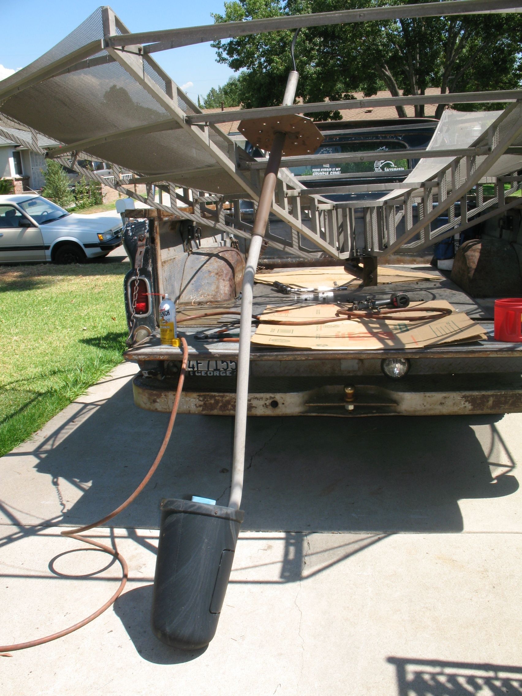

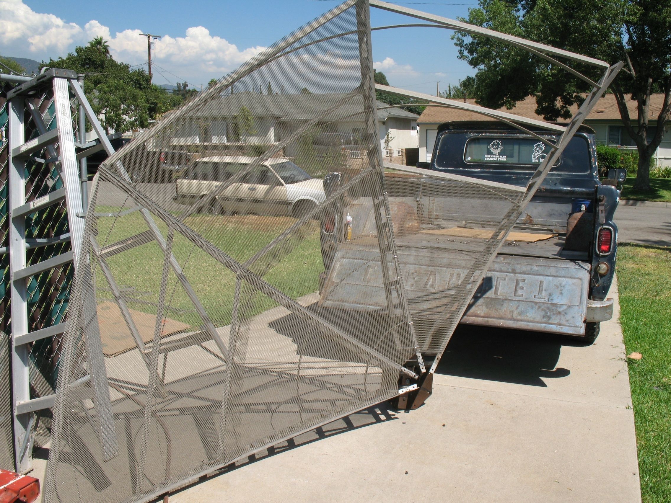

Got home by 10 am & began breaking the dish down. Removed 4 panels from opposite sides.
This dish has all the stainless j clips but the hardware is only ordinary(and very rusty) steel.
Tried removing the u-bolt holding the buttonhook in place but the tube simply would not slide out so I unbolted the reflector side center plate buttonhook & all. Unbolted half the rear plate bolts so it would come apart in halves. Then removed the braces between the frames of the halves & let it flop to the bed of the truck(4 inches). Lifted each half out over the lowered tailgate & into the backyard for further dis-assembly later.

I cannot make up my mind if I would rather have 12 footer
or the 8 footer hauling it!!! :cool:
On your back window is that kid taking a wizz on a
Dishnetwork or DirecTV satellite dish??? :D
Great job and keep those photos coming!!!... :up
