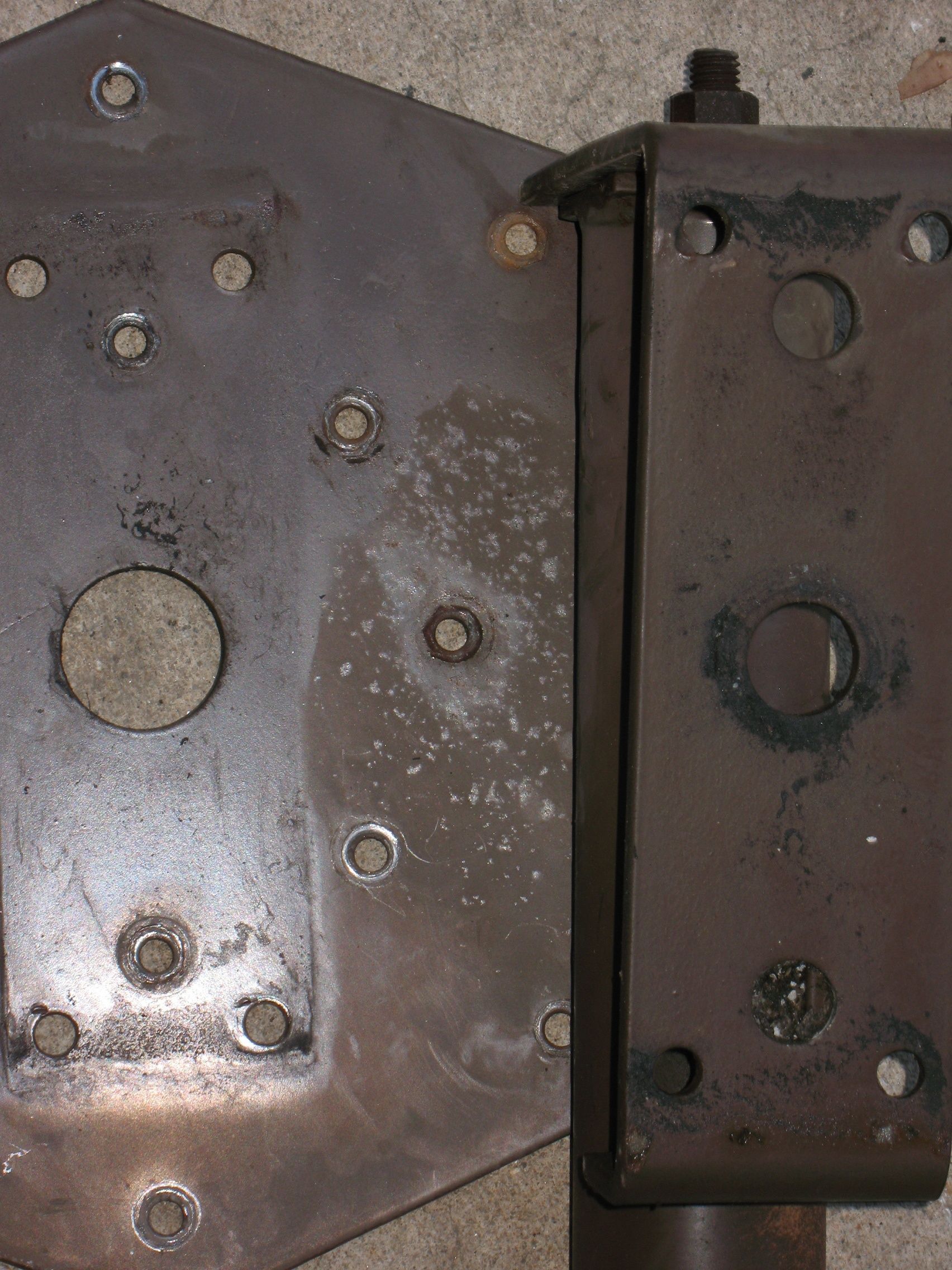

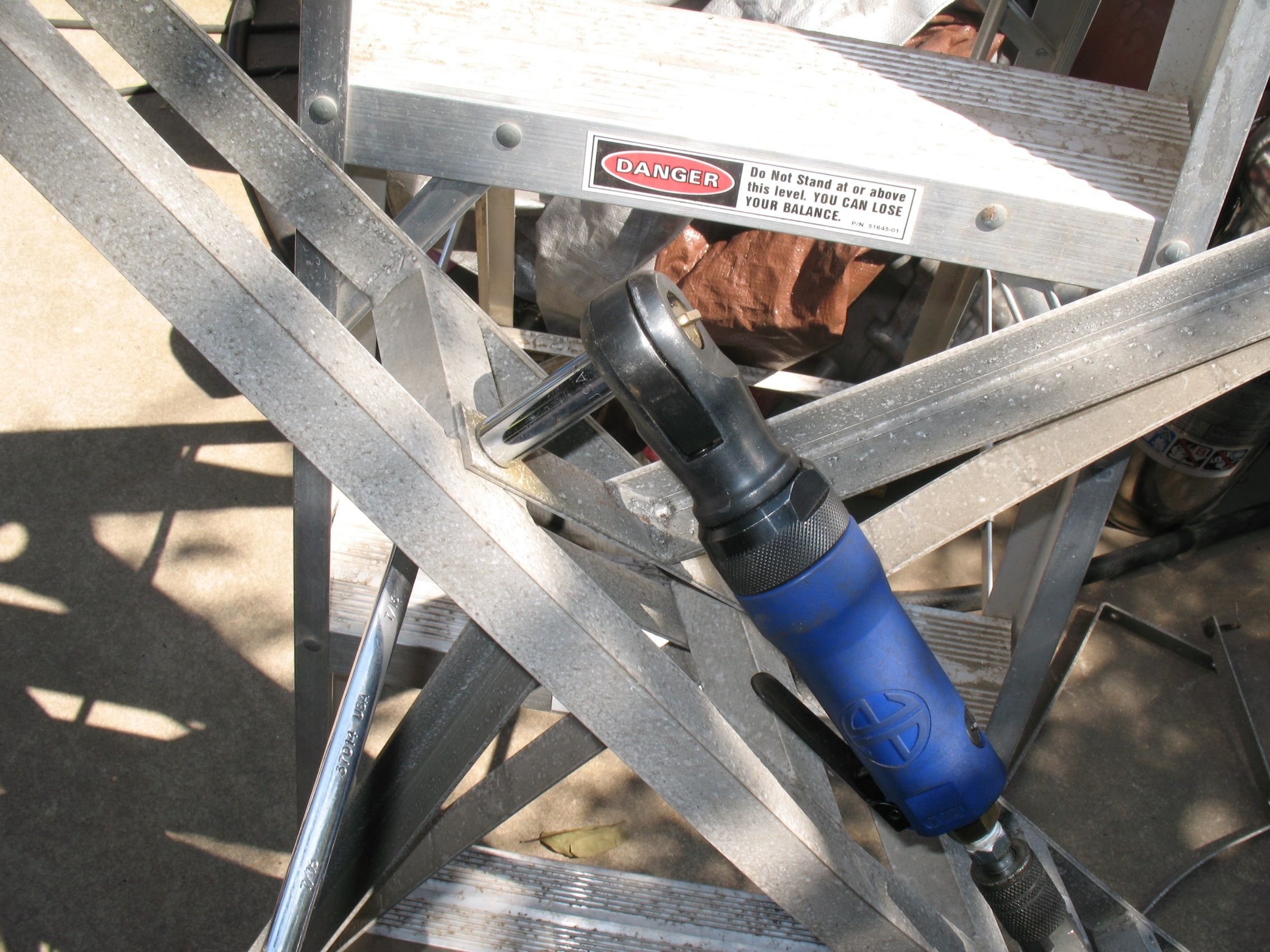

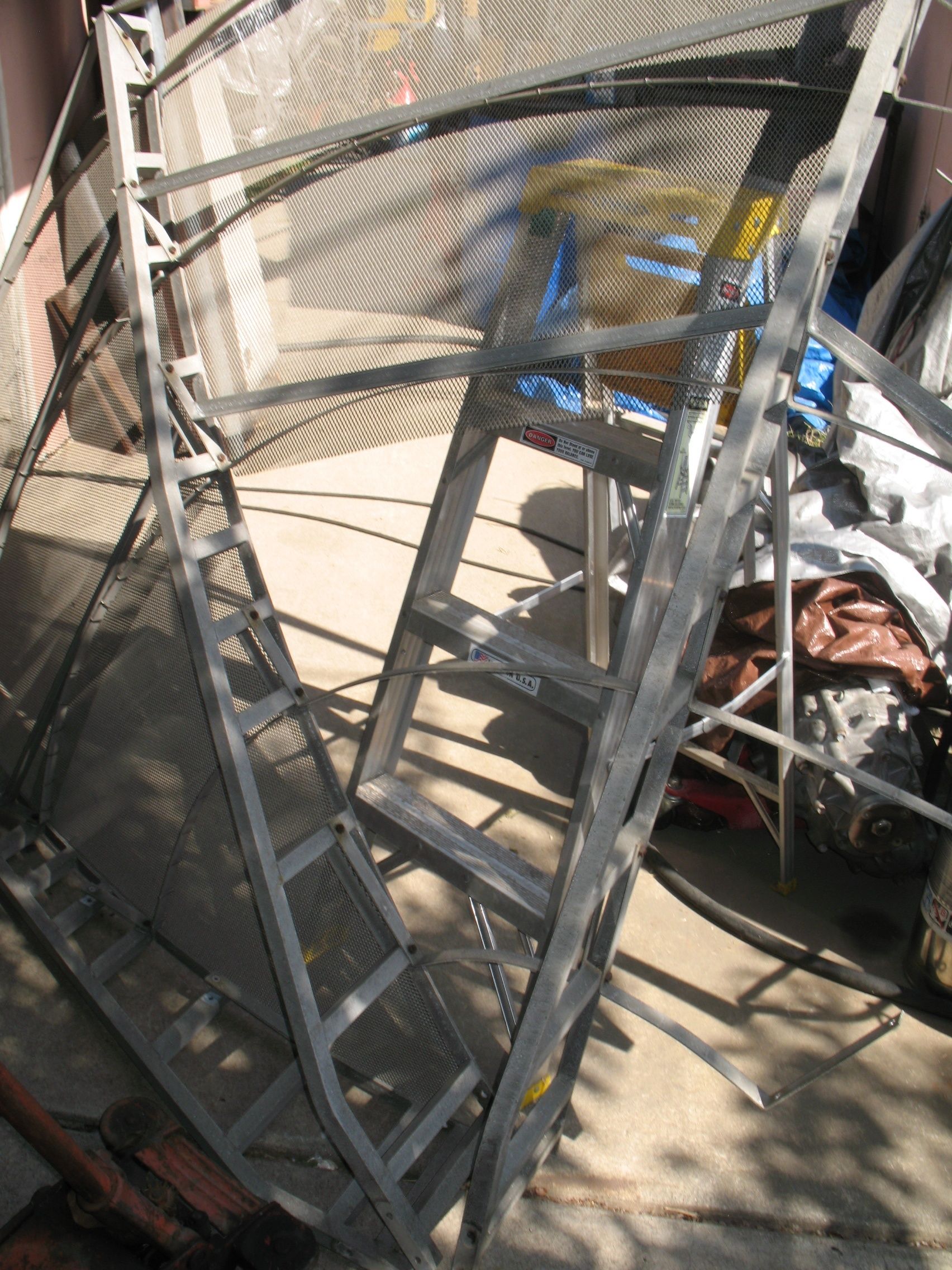

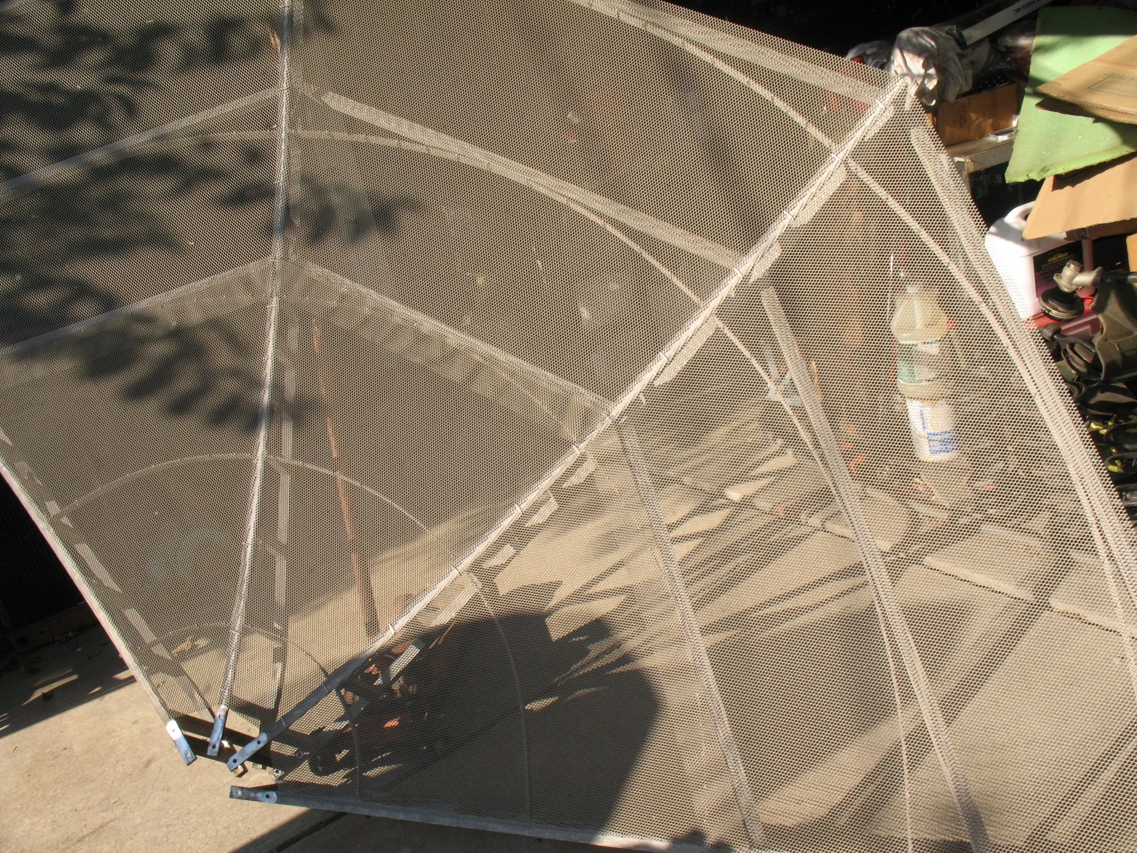

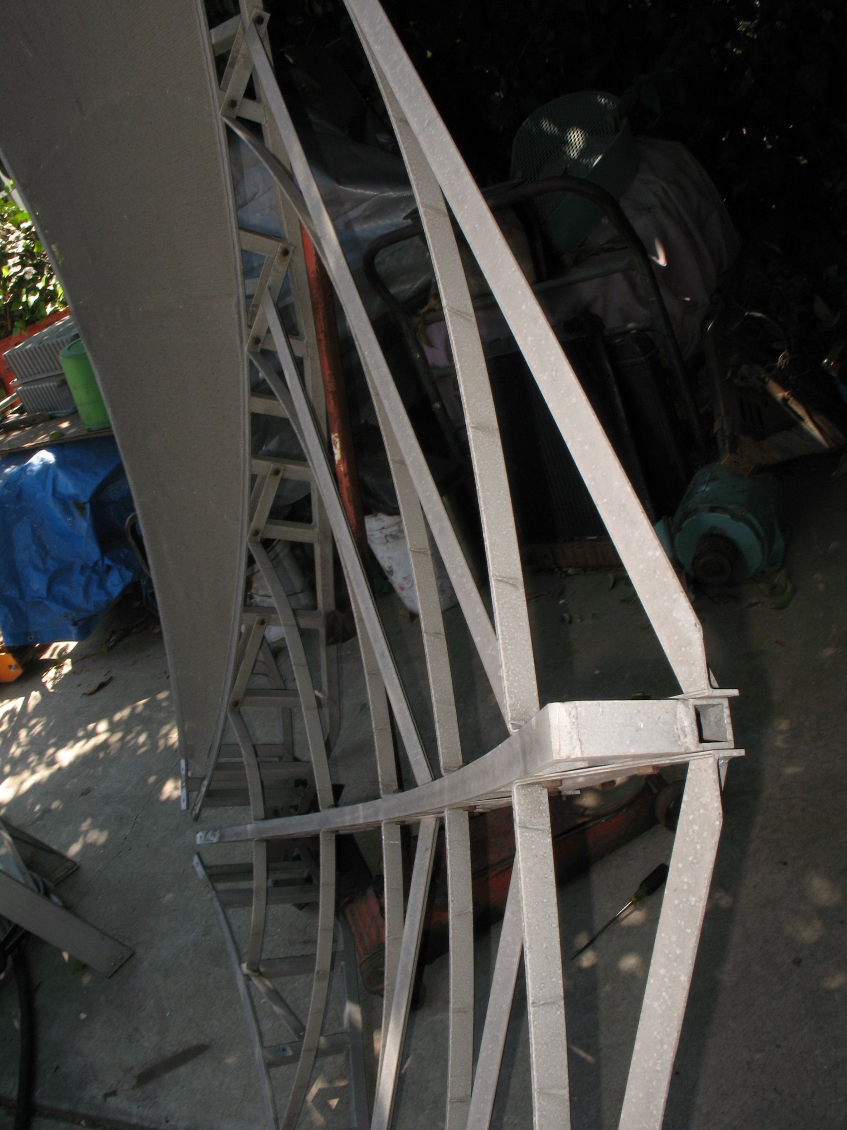

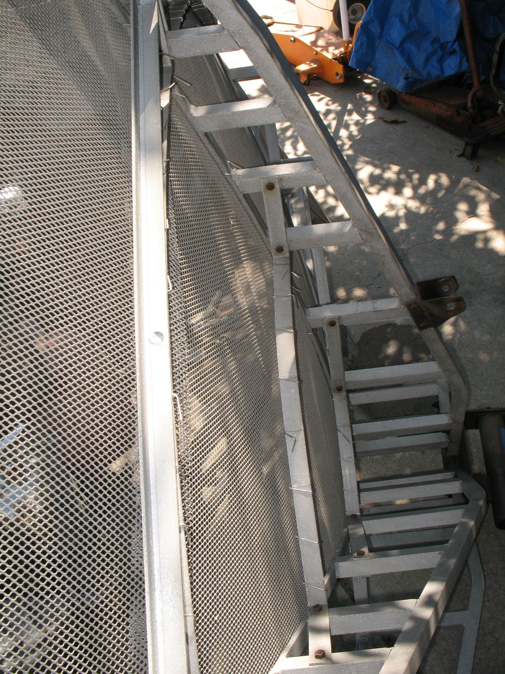

breaking it down

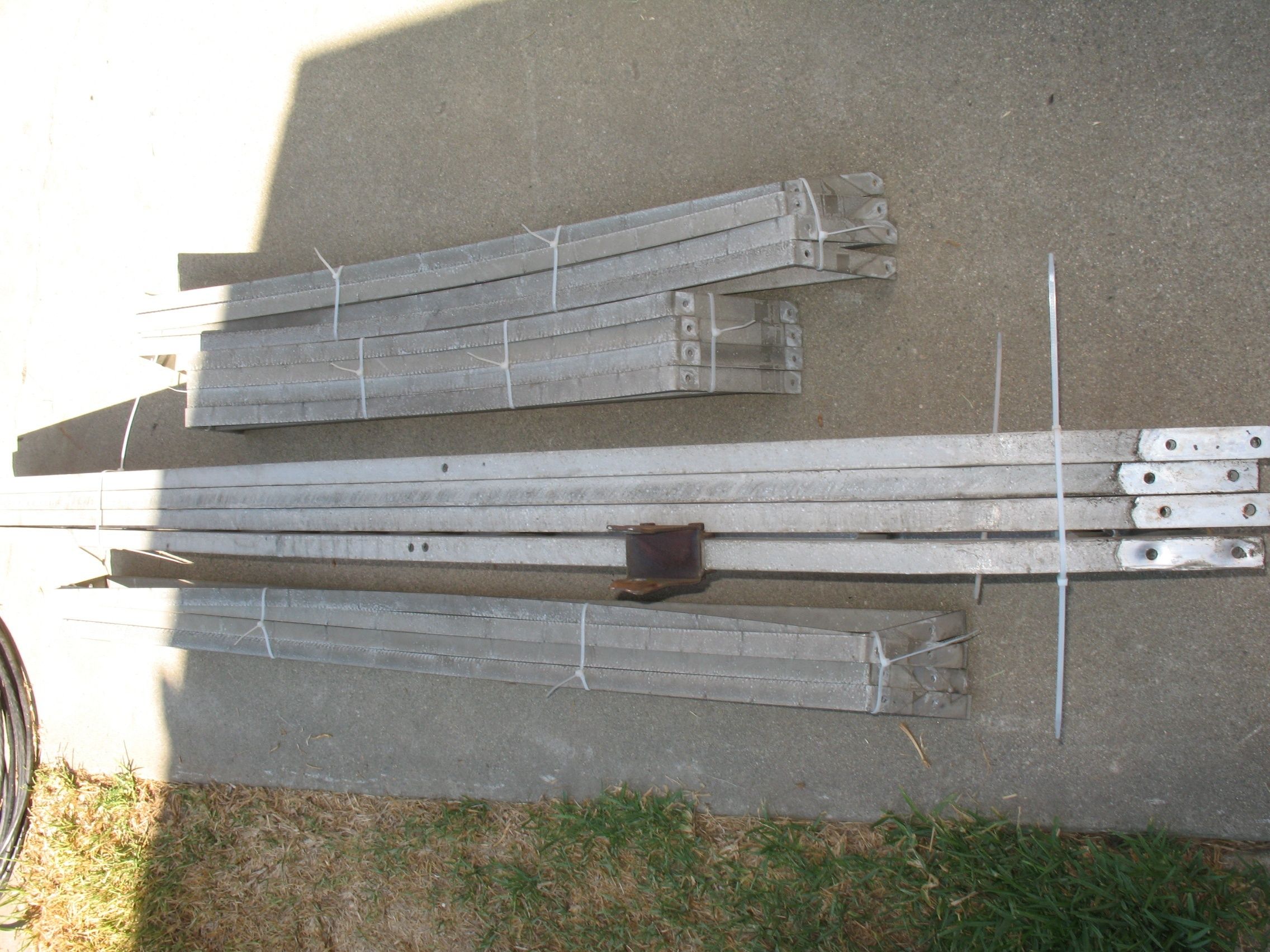

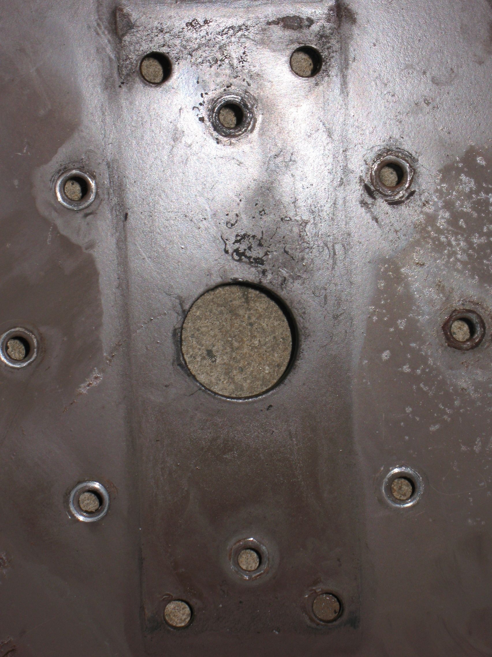

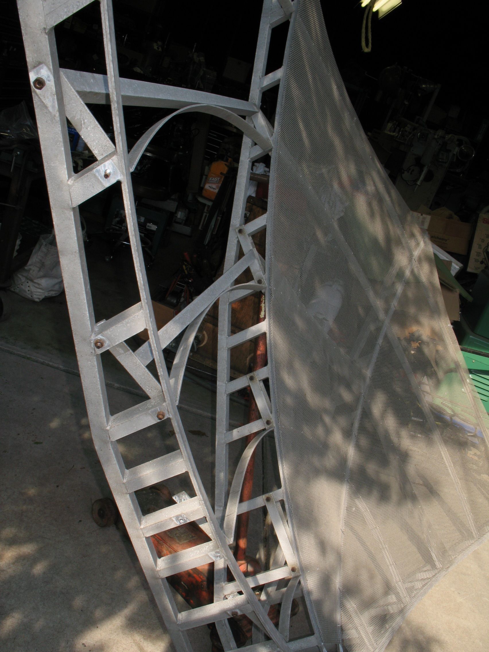

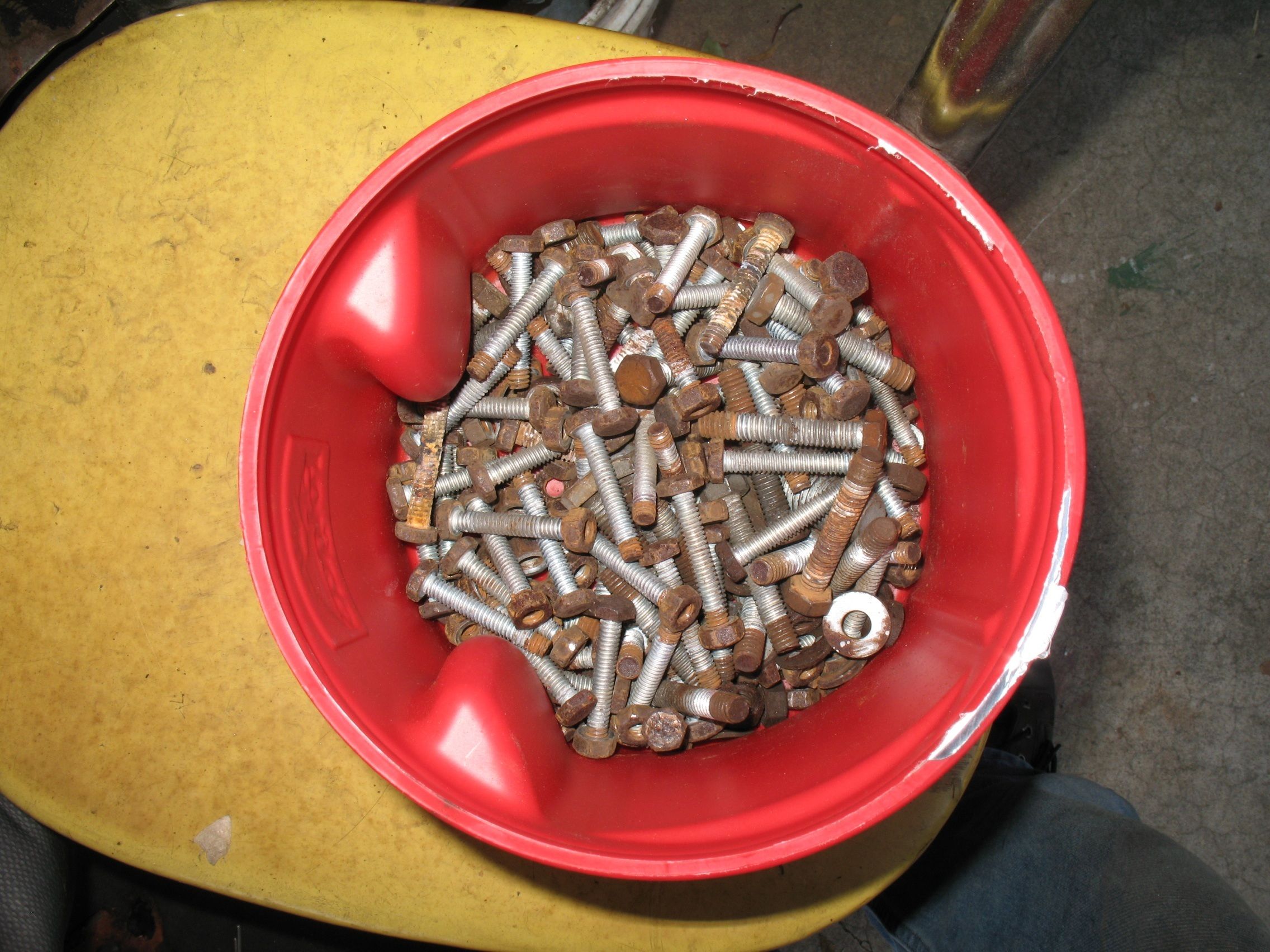

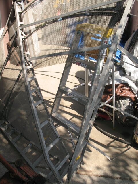

For the past two days(well - half days) I've been taking the dish down to brackets, ribs, bolts & clips - lots of clips. Having an air compressor, air ratchet, impact gun to remove all the rusty hardware made short work of frame teardown:).

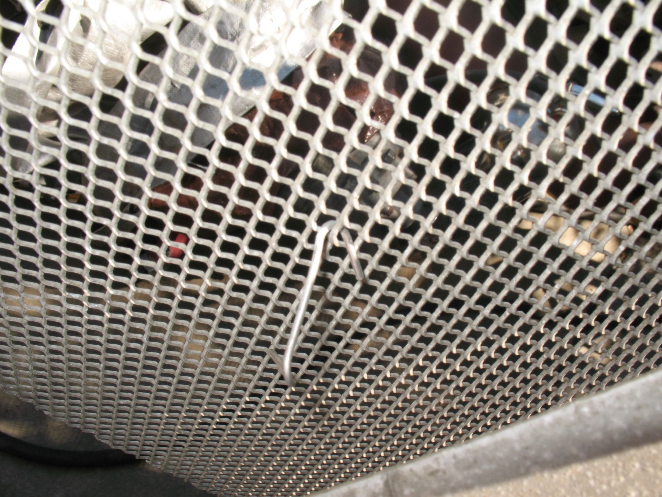

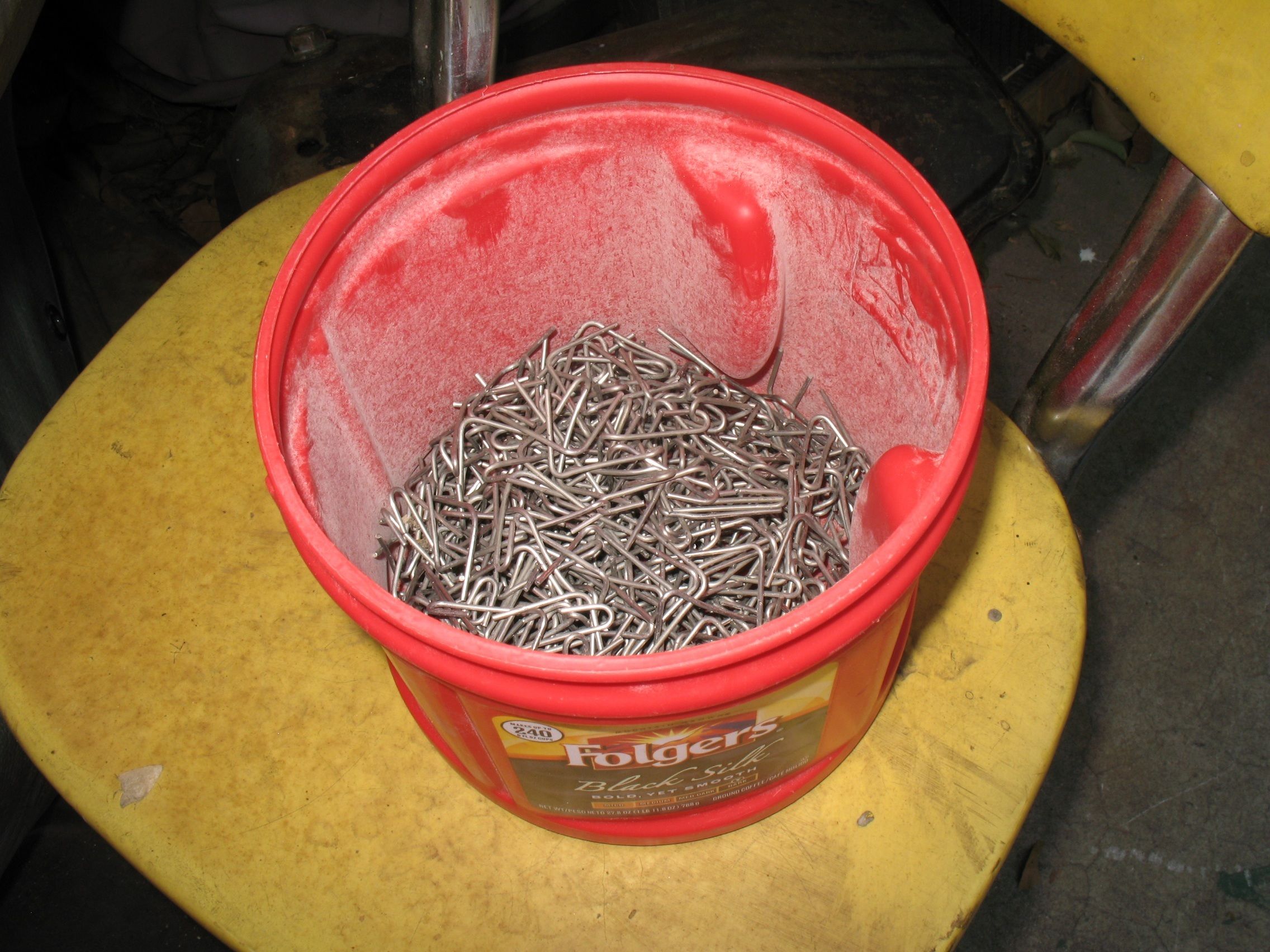

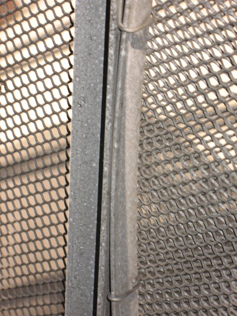

Those pesky j-clips were easiest to remove if the j didn't get spread beyond the 1/4" loop & then fish them through the mesh. A pair of good diagonal cutters to pull the clips out to a 90* then turn to left or right with lineman's pliers made them manageable.The ones in between the tight parts of the frame bows needed the most coaxing - a thin blade screwdriver to spread the welded bow gently helps.

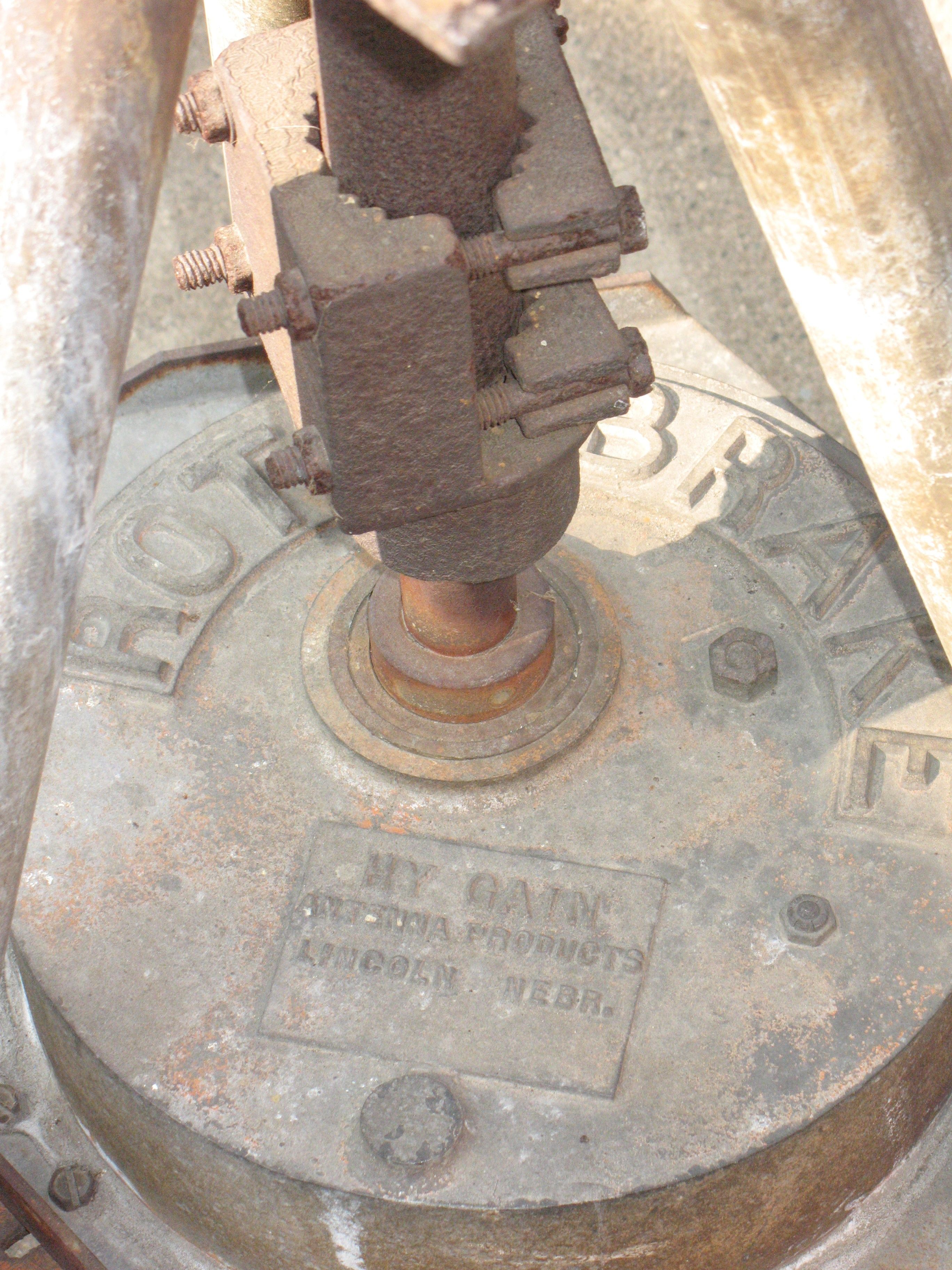

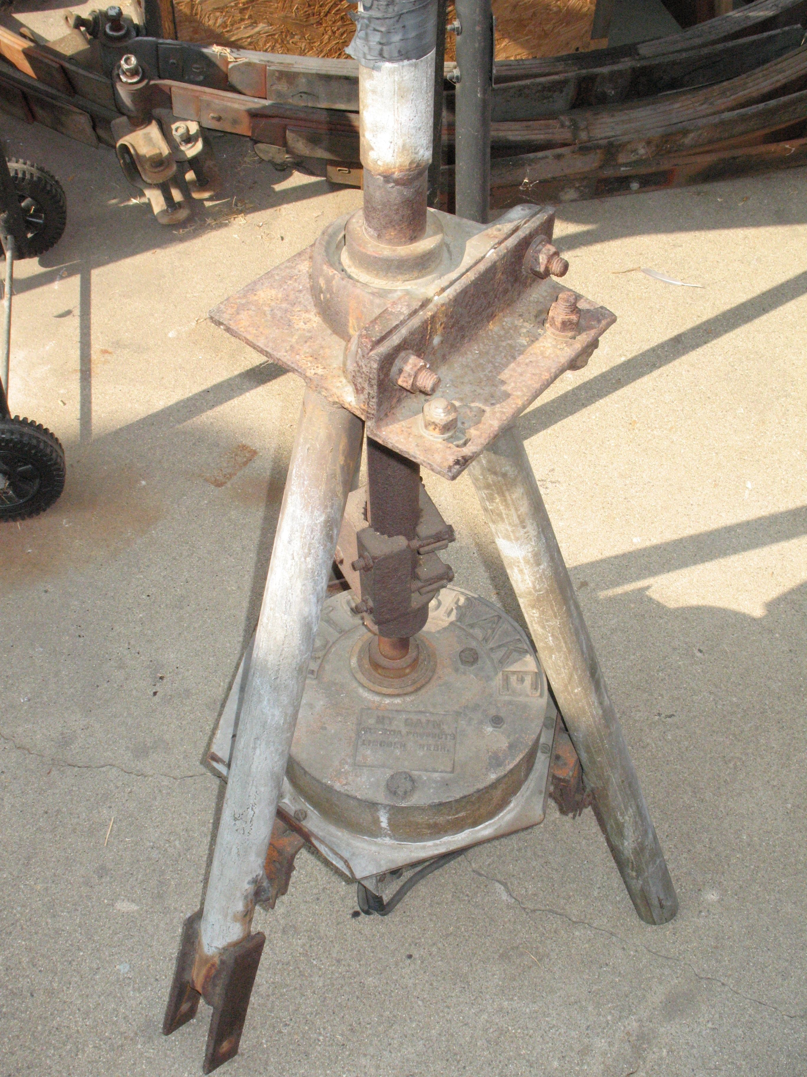

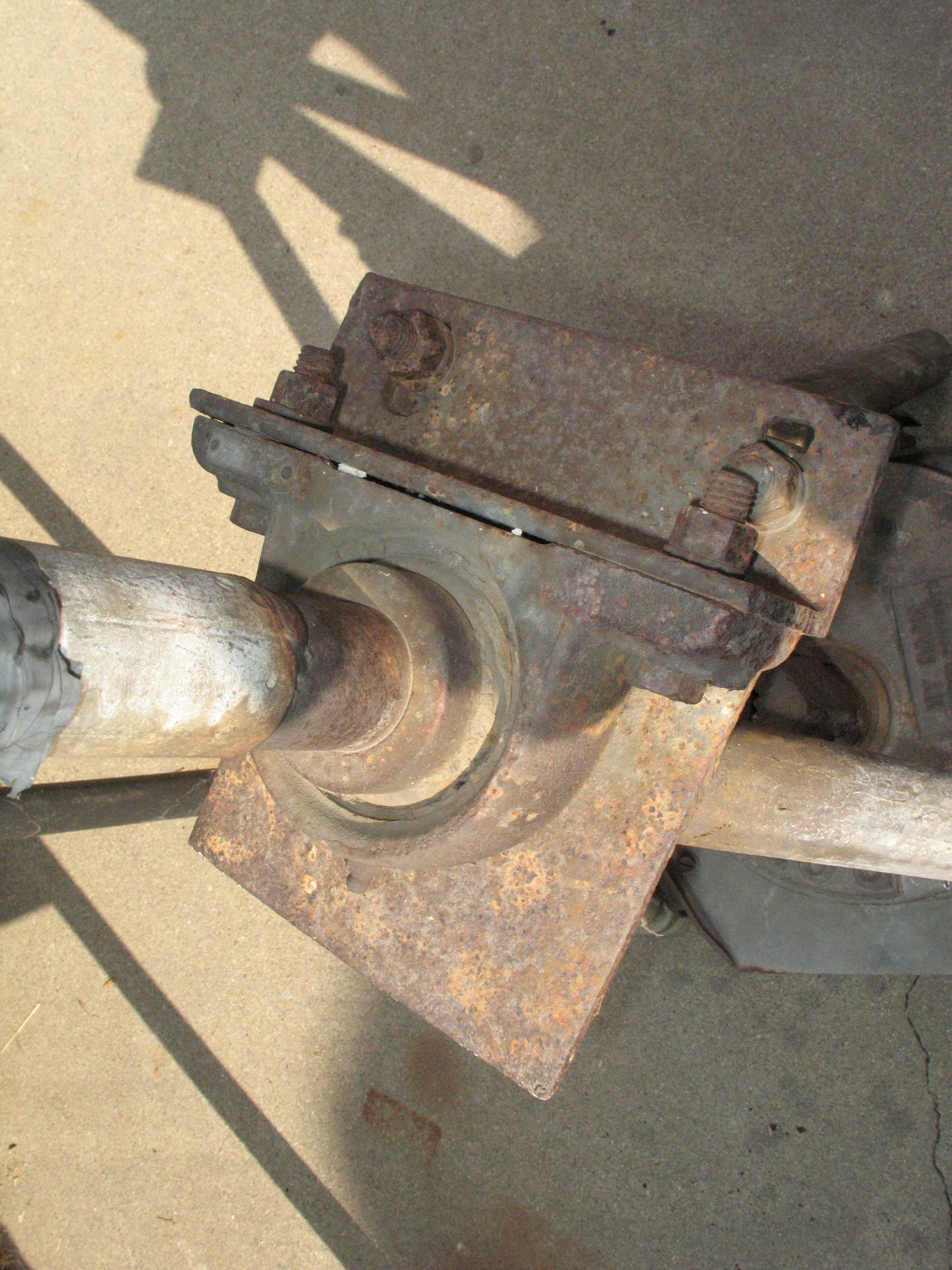

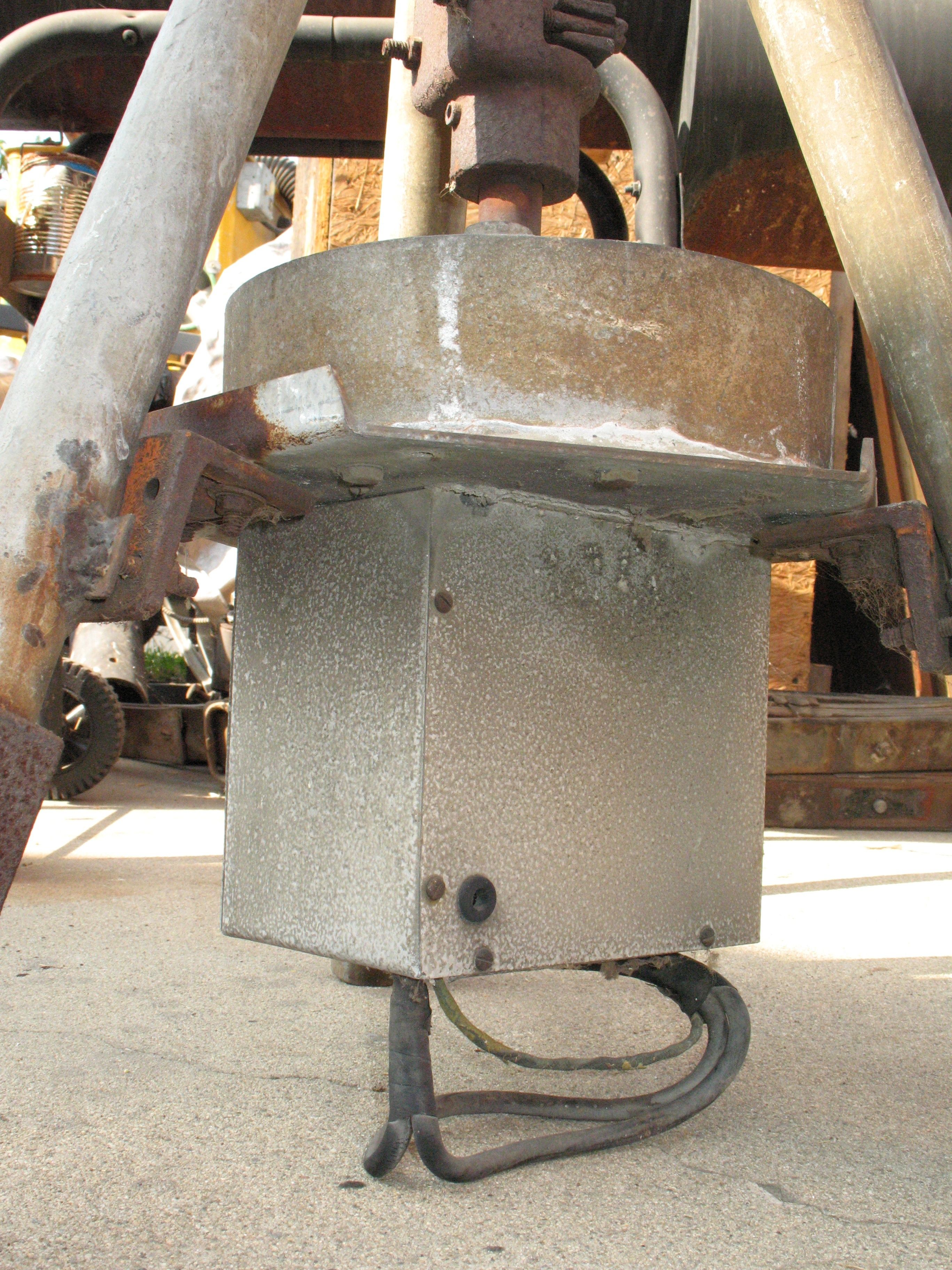

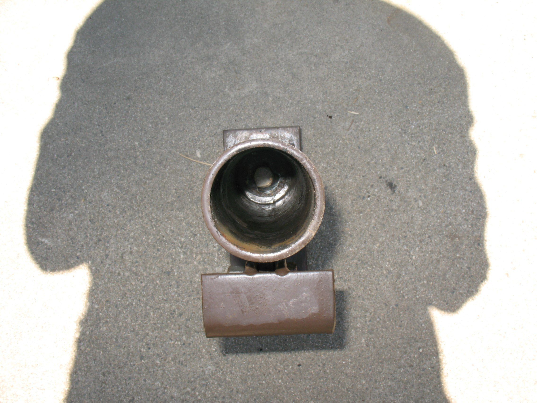

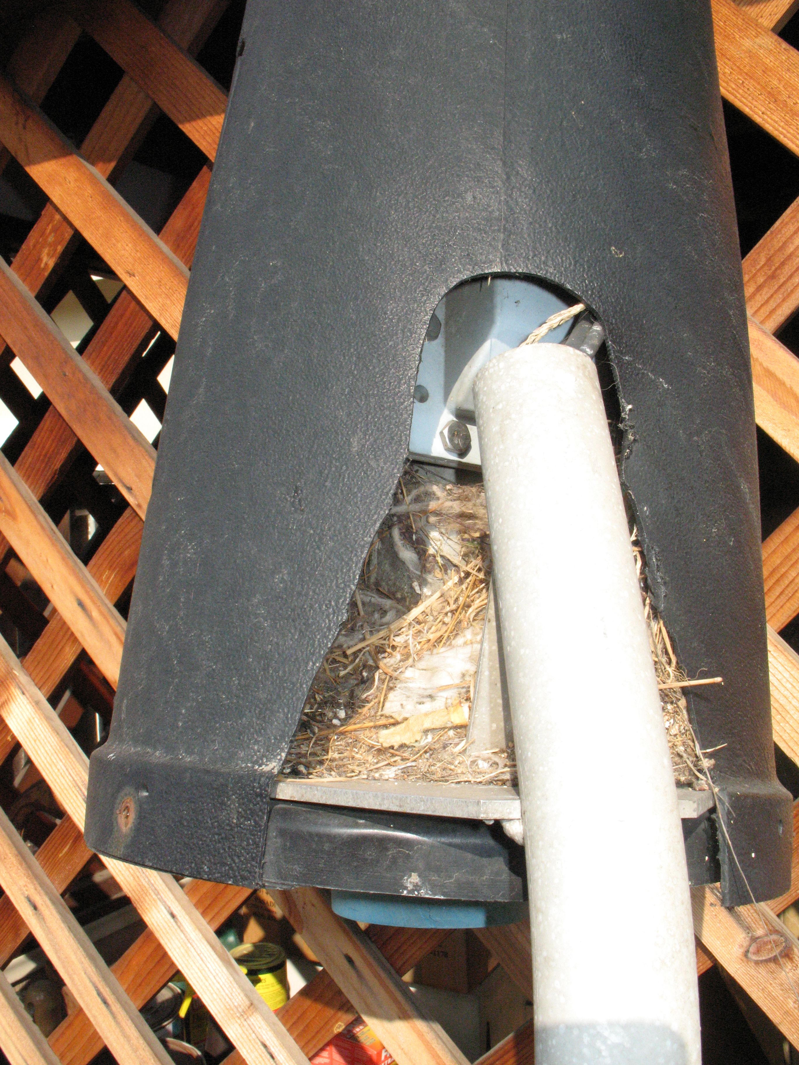

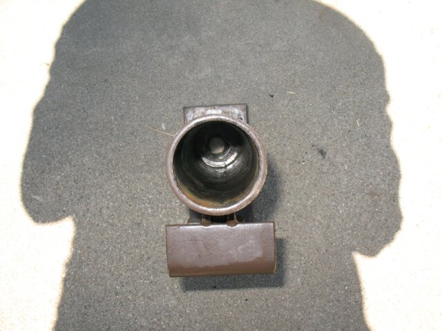

The polar mount looks to have been assembled dry - no lube inside the tube at all!

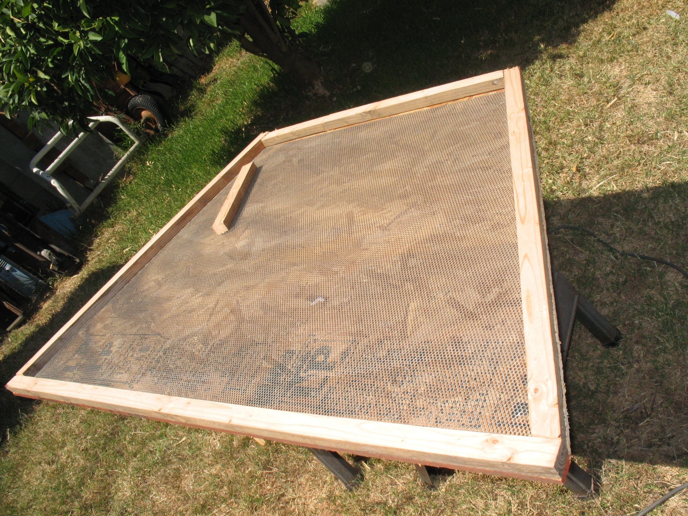

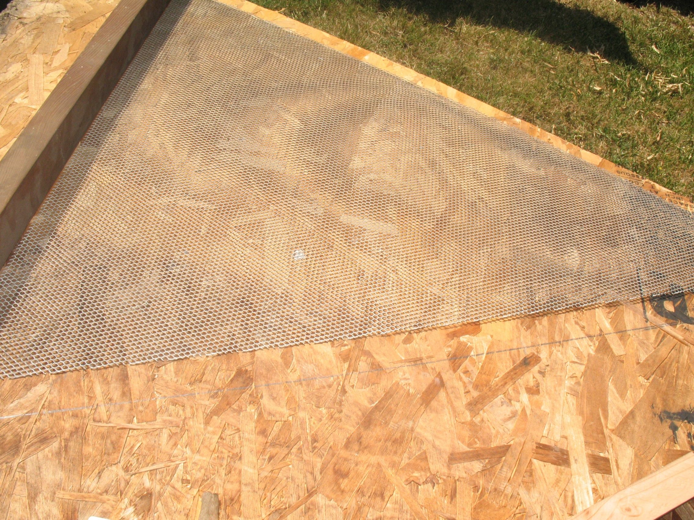

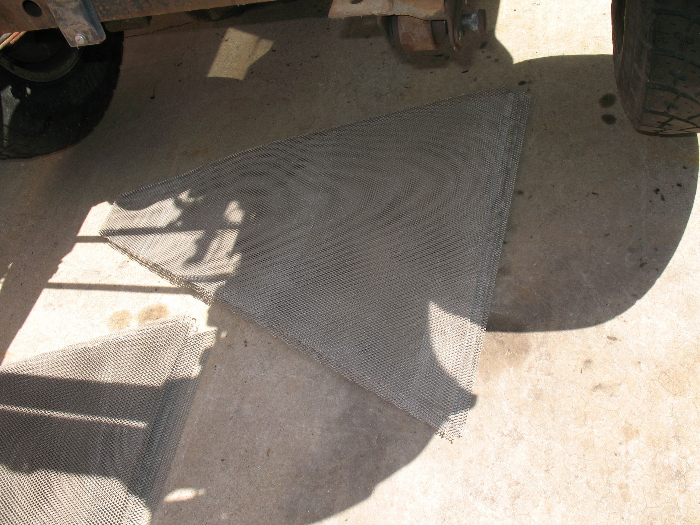

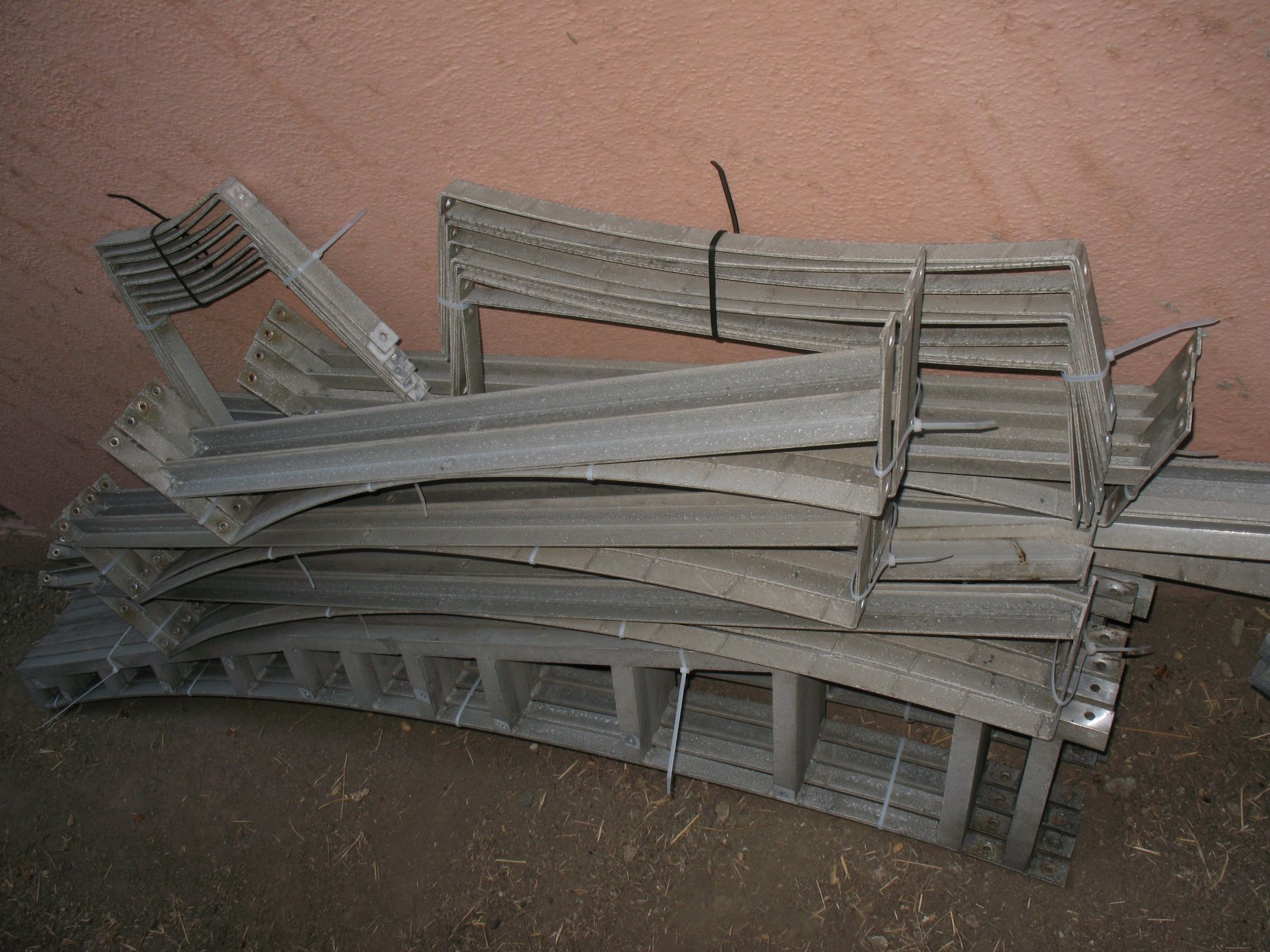

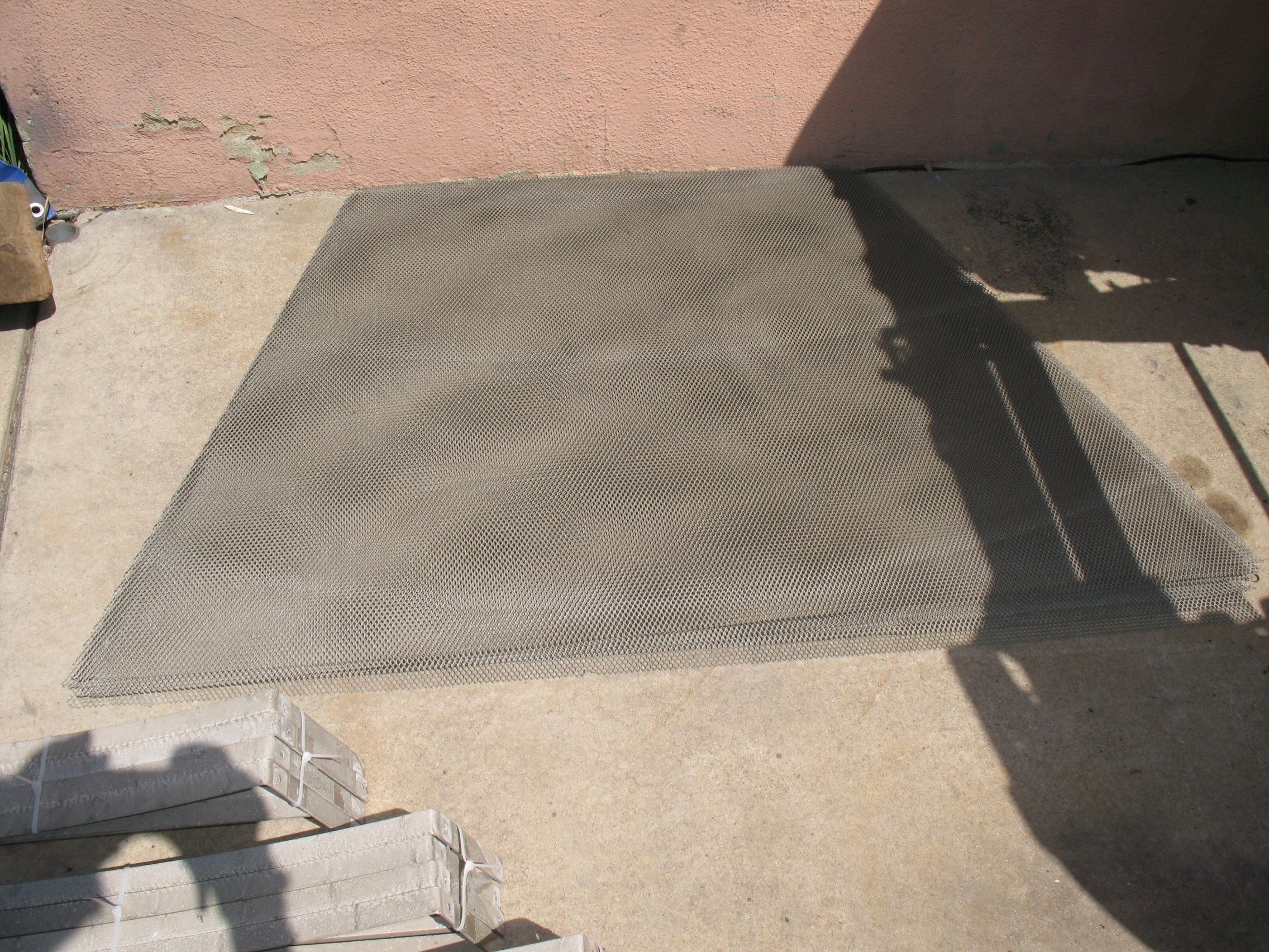

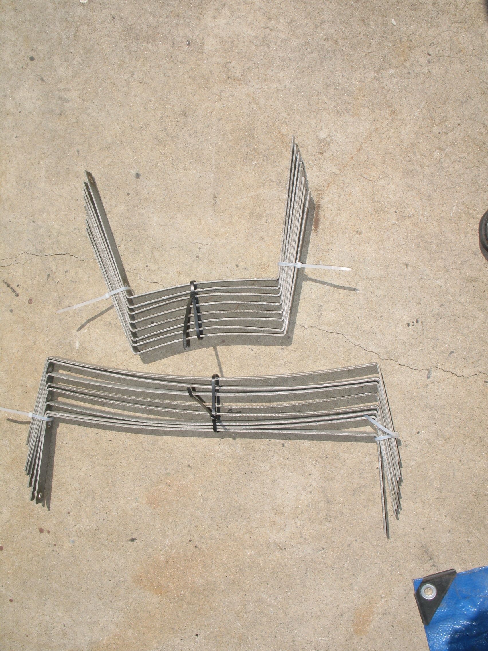

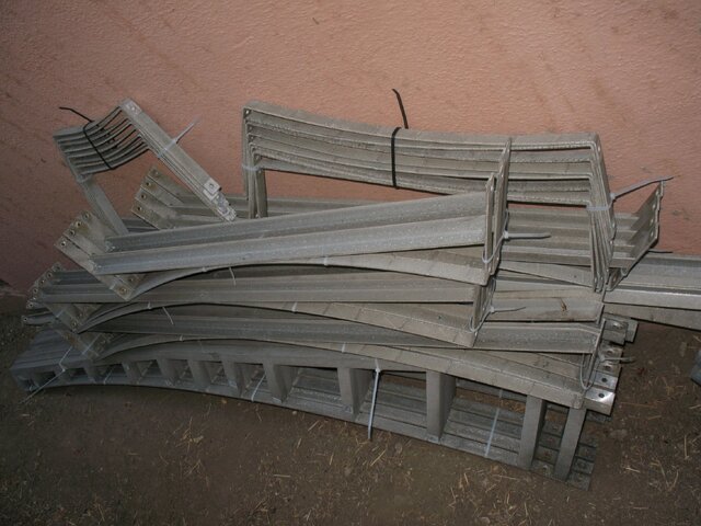

sorting the parts

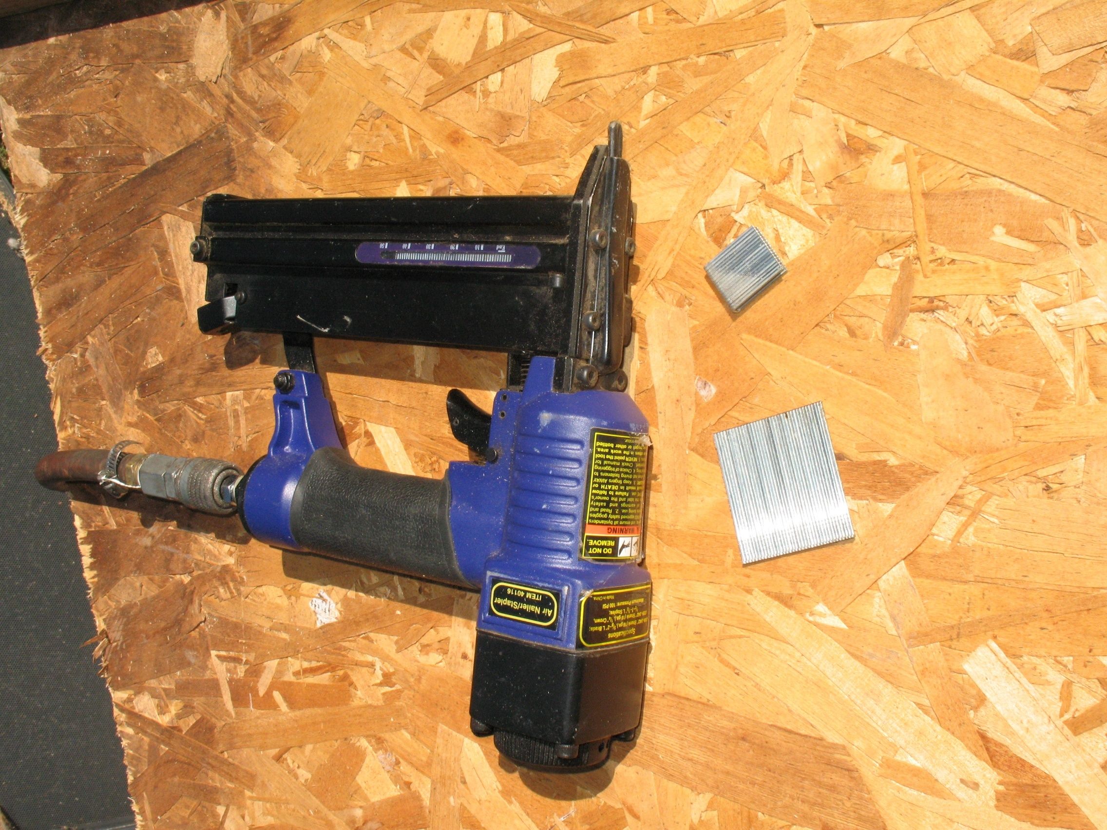

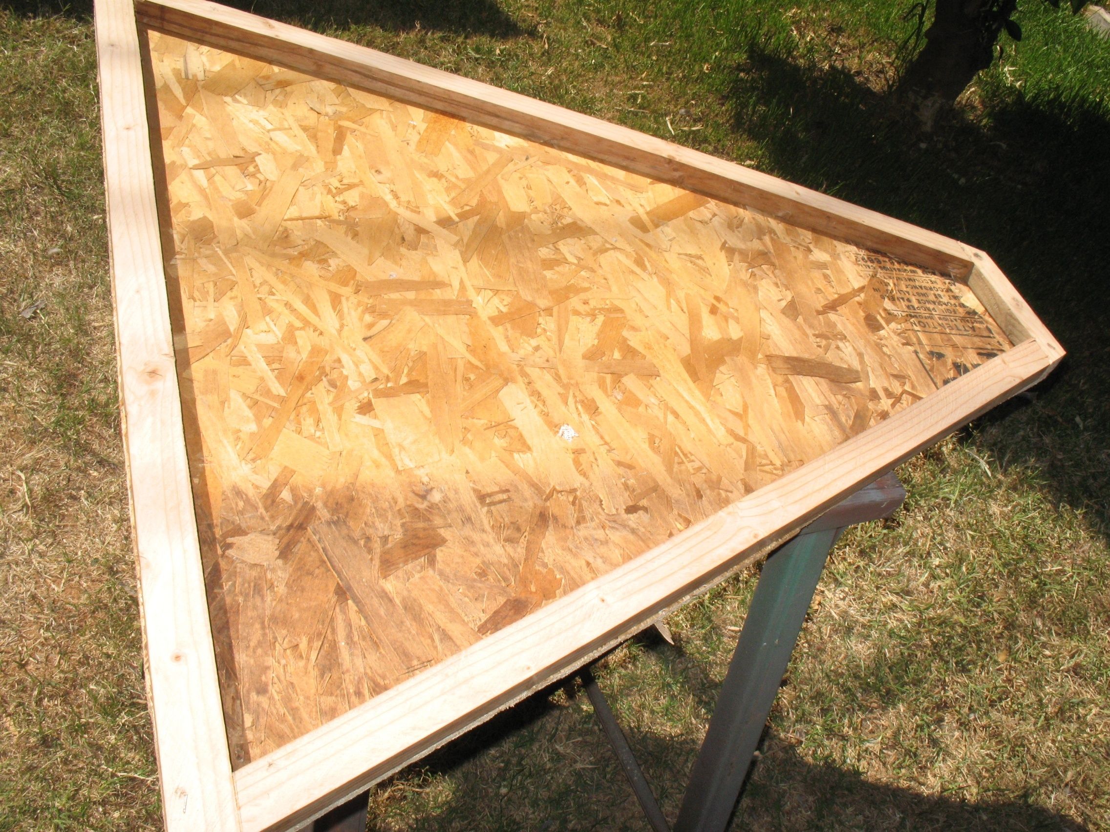

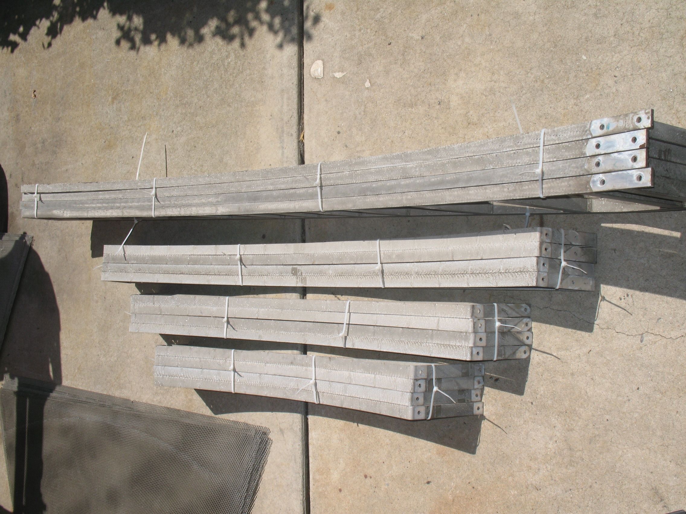

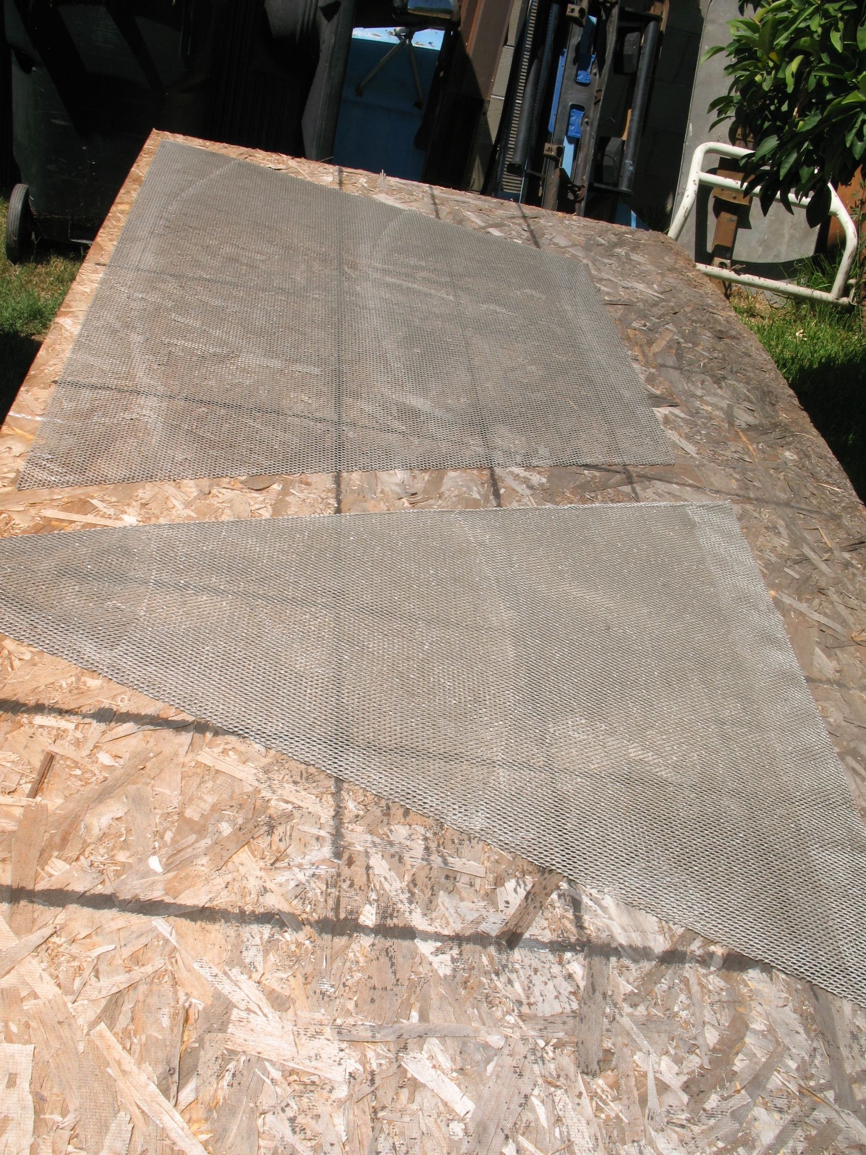

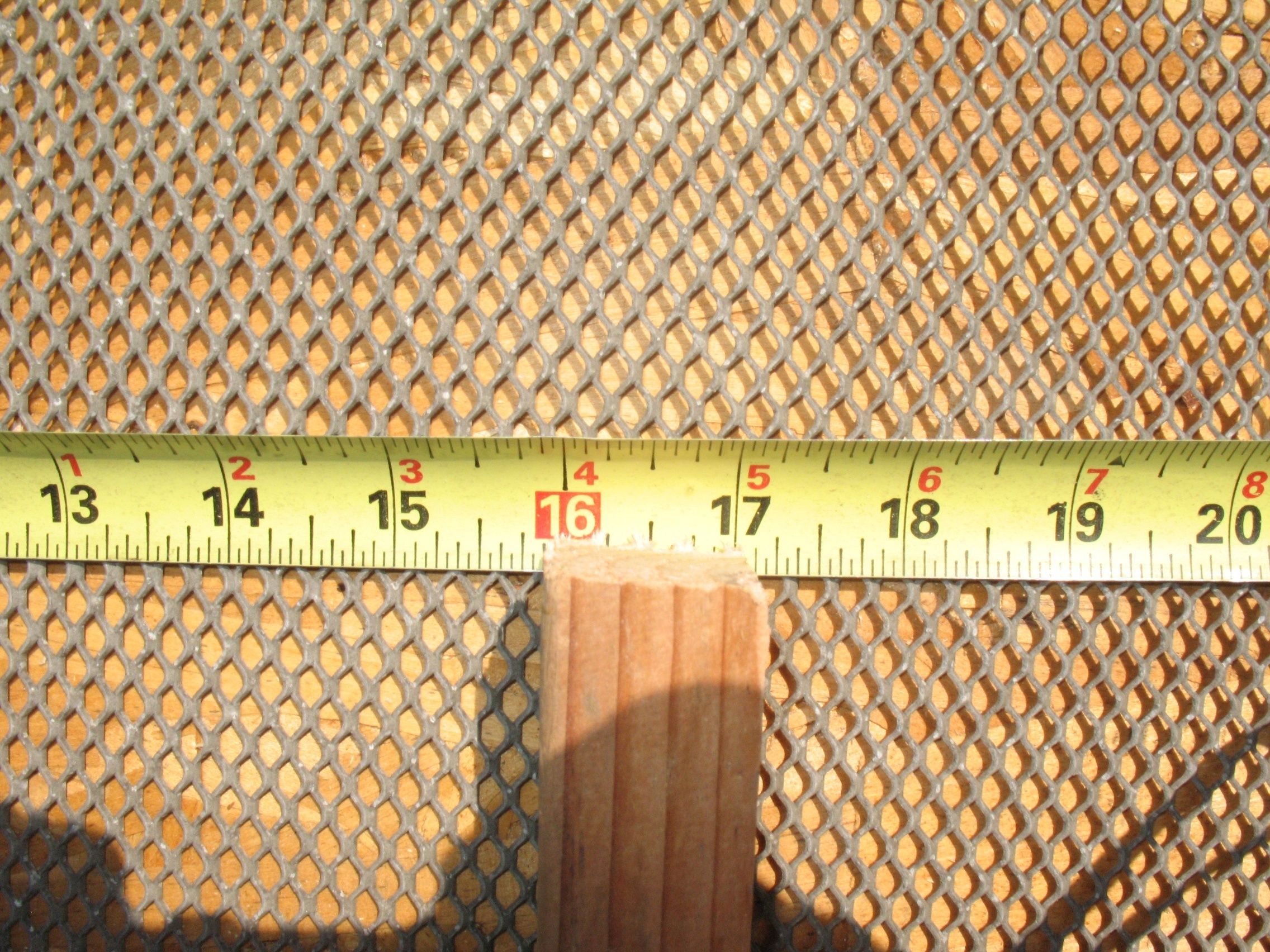

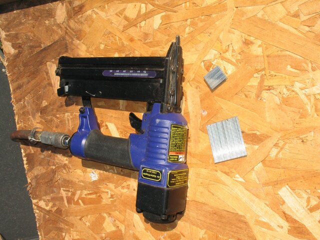

Bundled the like frame parts together with wire ties. Laid out one each of the panels on a 4 x8 sheet of press wood to judge how I'll construct boxes to protect the panels - I think I'll make it 2. Rip 2x4s on the table saw to 5/8" x 1 1/2" strips & staple these through the press wood to make a framed box & put a 1/4" plywood lid on them.

When I took down,and reinstalled in my yard,my 12' Paraclipse,there was (is) some kind of plastic sheet inside the polar tube.I assume this was to act as a shim and lubricant for the mount.How much of that sheet is left I don't know,dish has been out there 15? years now and was in it's previous location for 5 to 10.

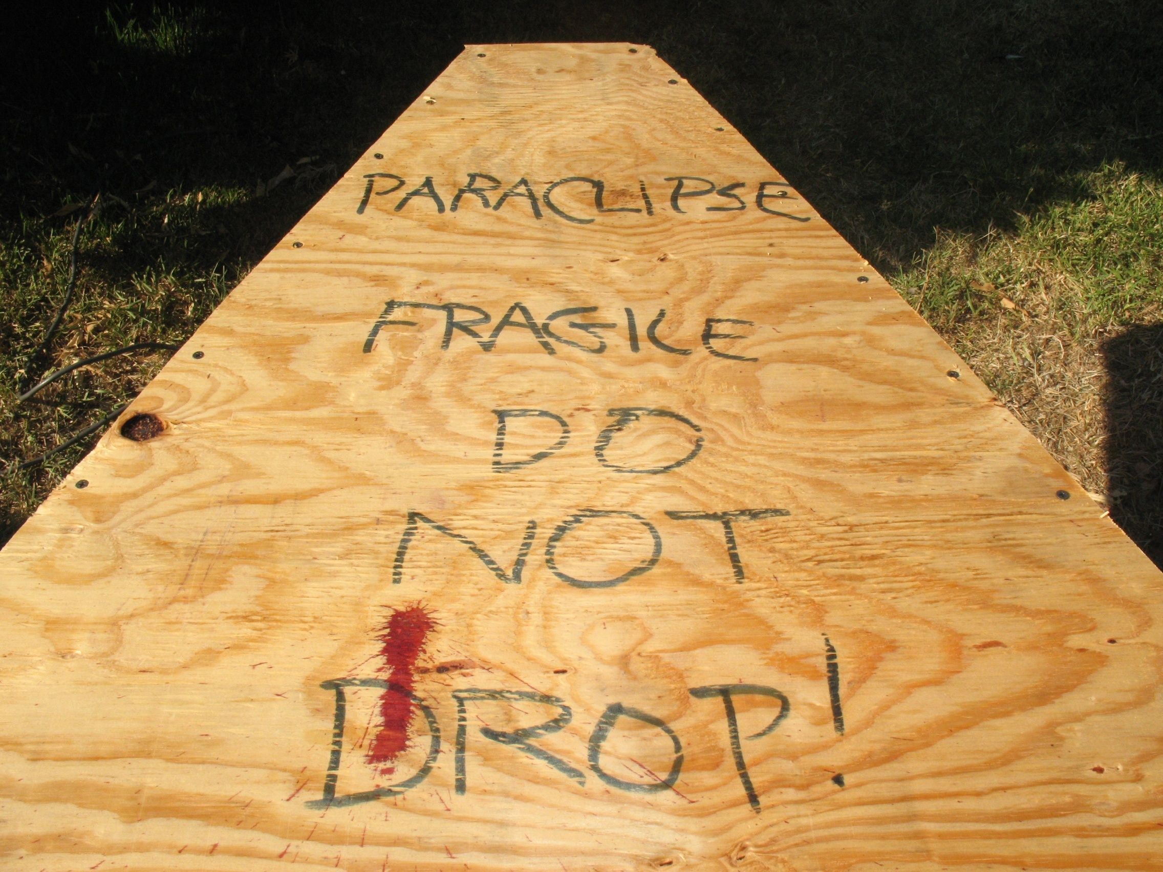

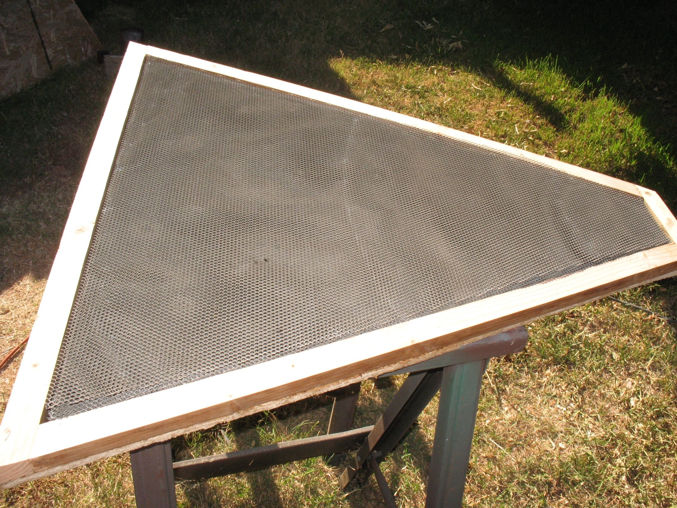

boxing things up

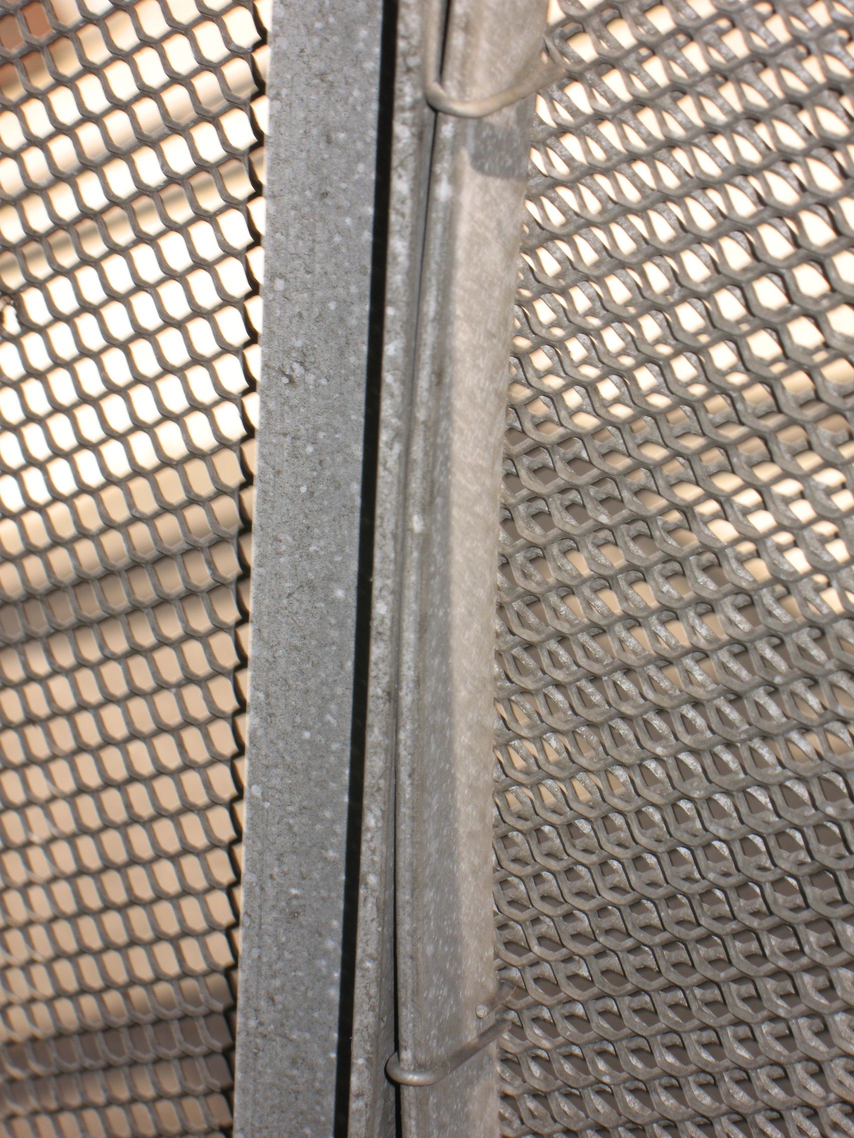

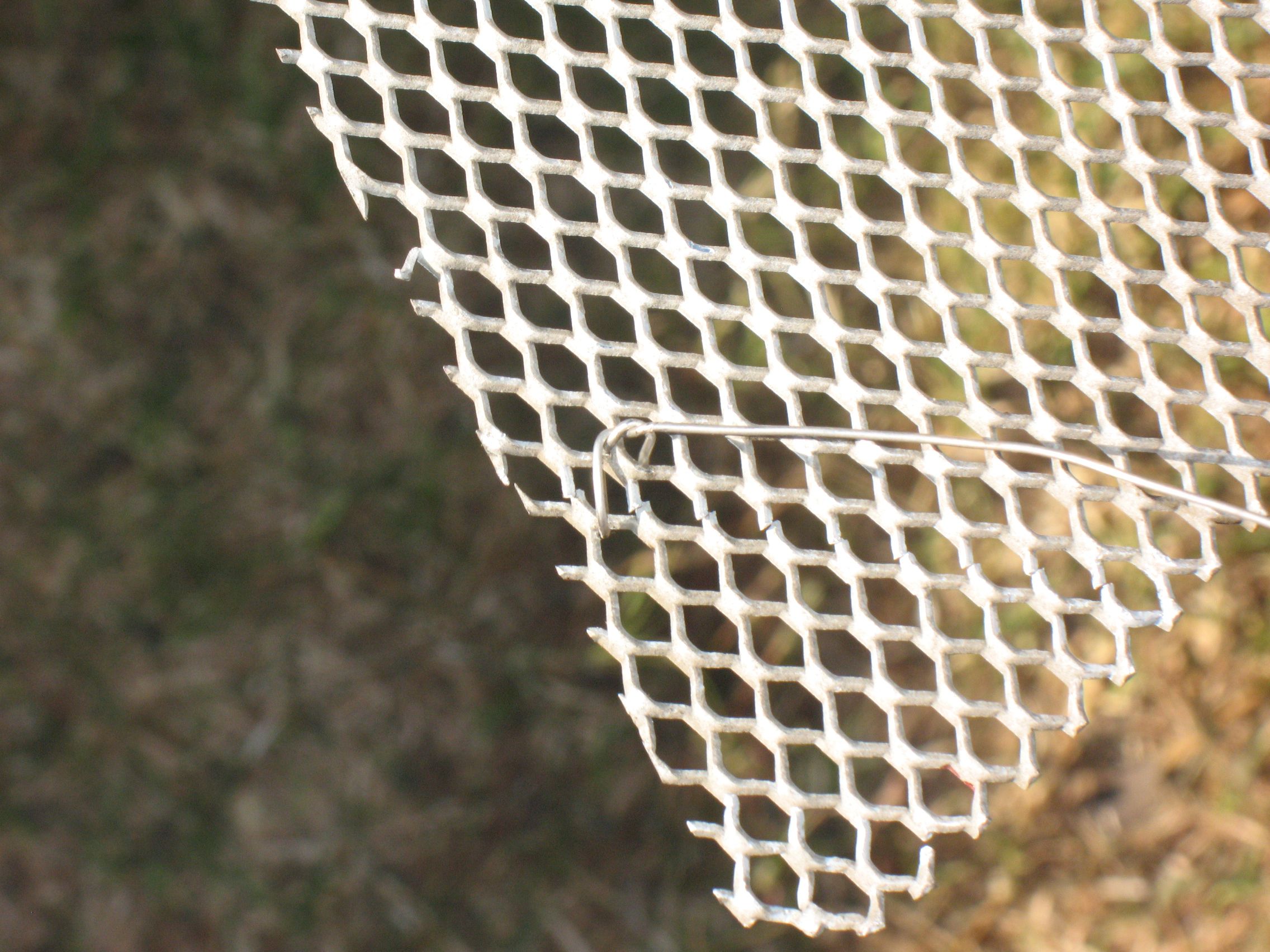

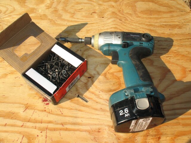

Got the mesh panels boxed up for transport - 2 triangular boxes of plywood & 2x4s ripped lengthwise to 1"x1.5" strips. A 1" depth neatly holds the 8 panels snug without overly compressing them. Had to mend one outer panel with .032" stainless aircraft wire - about 3.5" on one corner. I'll likely box up some of the flimsier brackets to keep them from harm too.

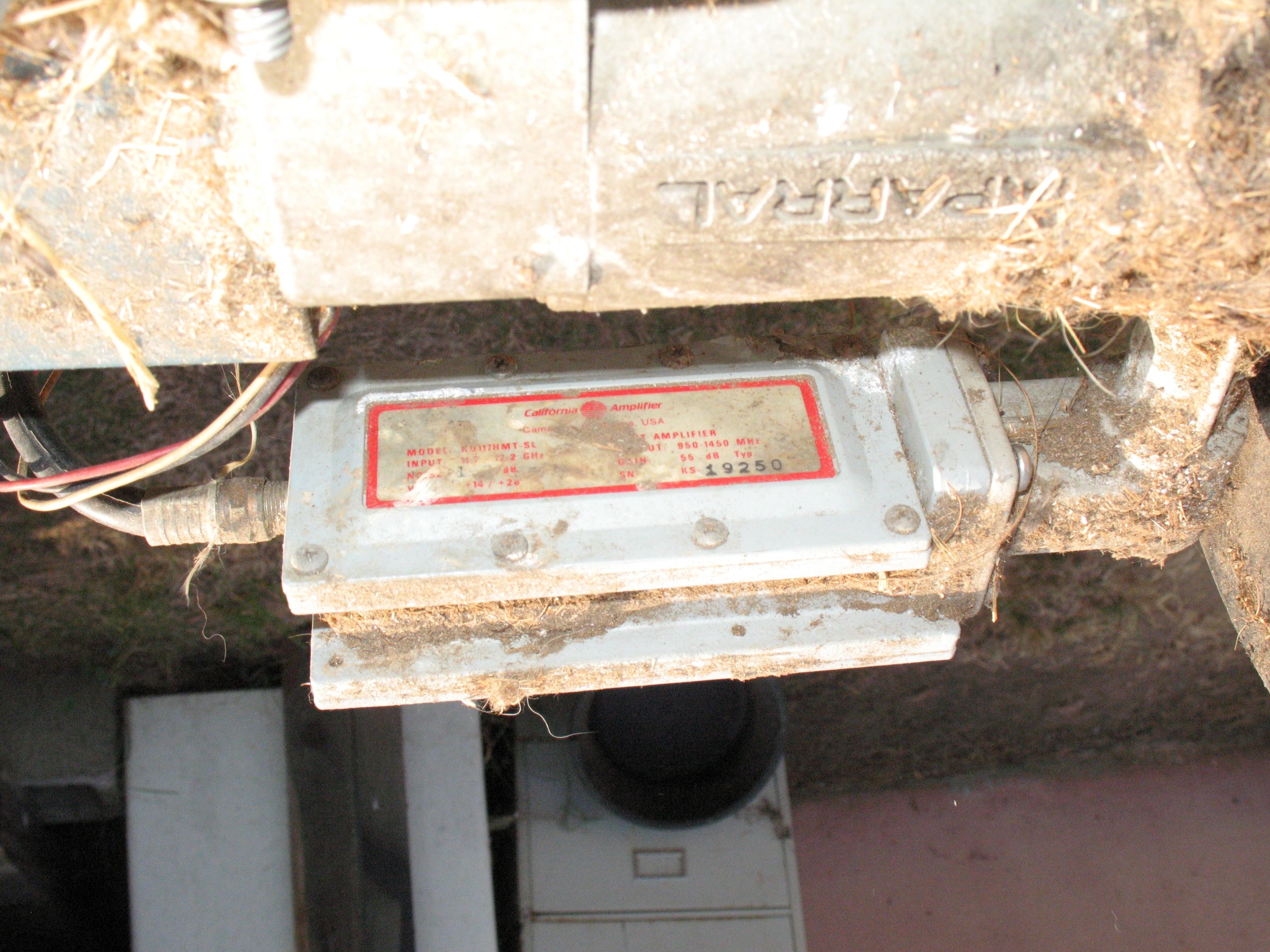

Paraclipse bonus(lol)

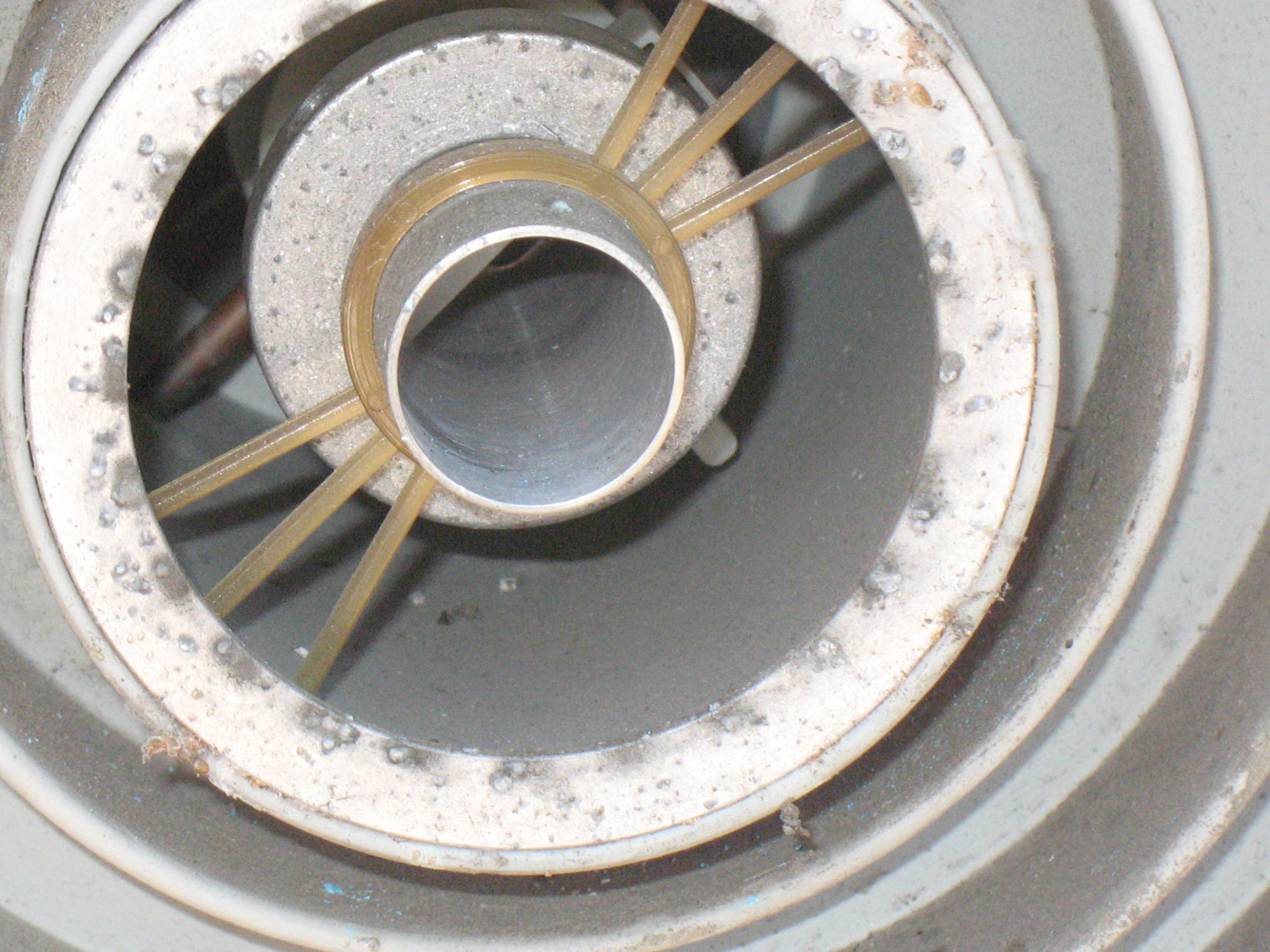

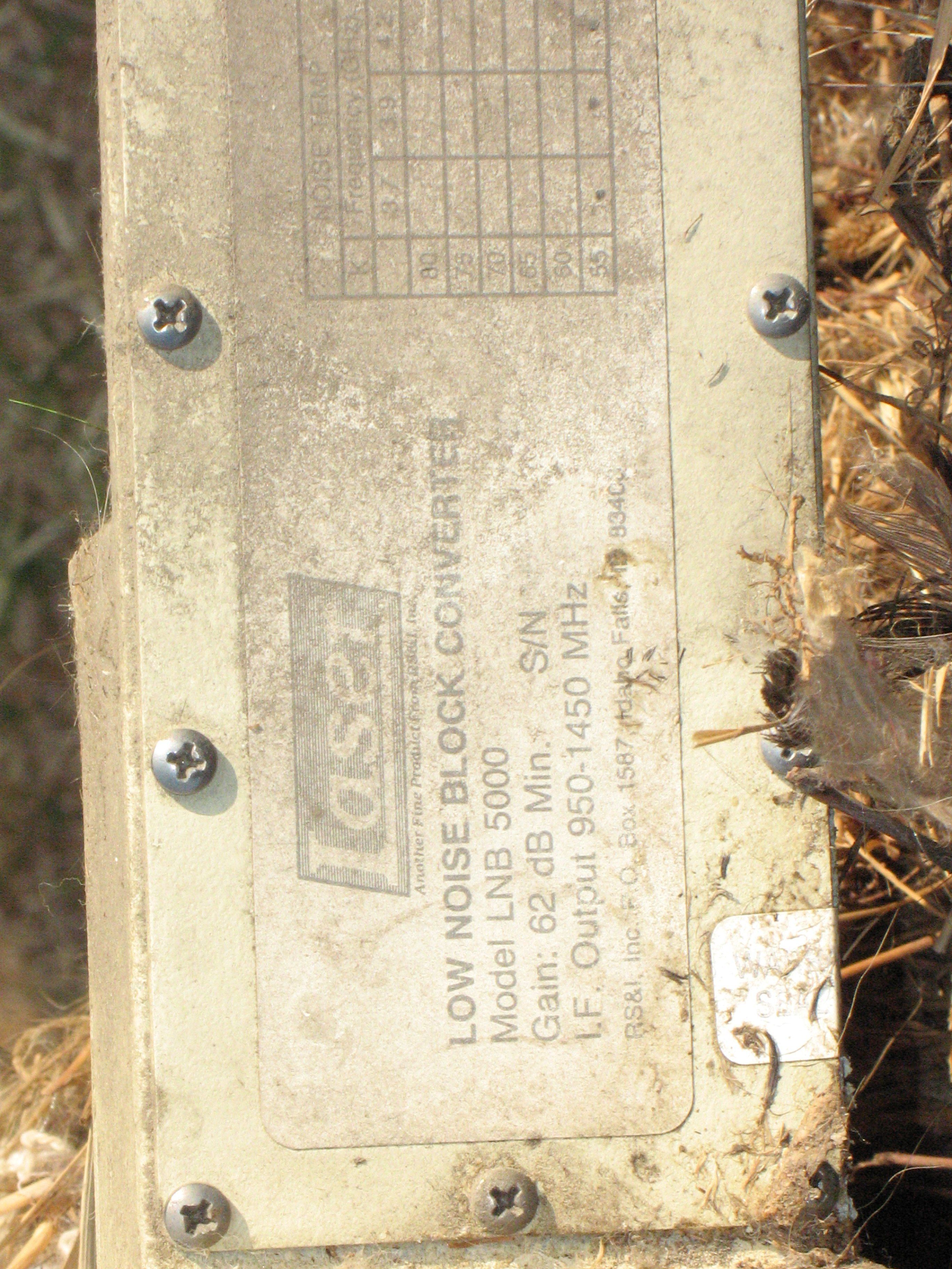

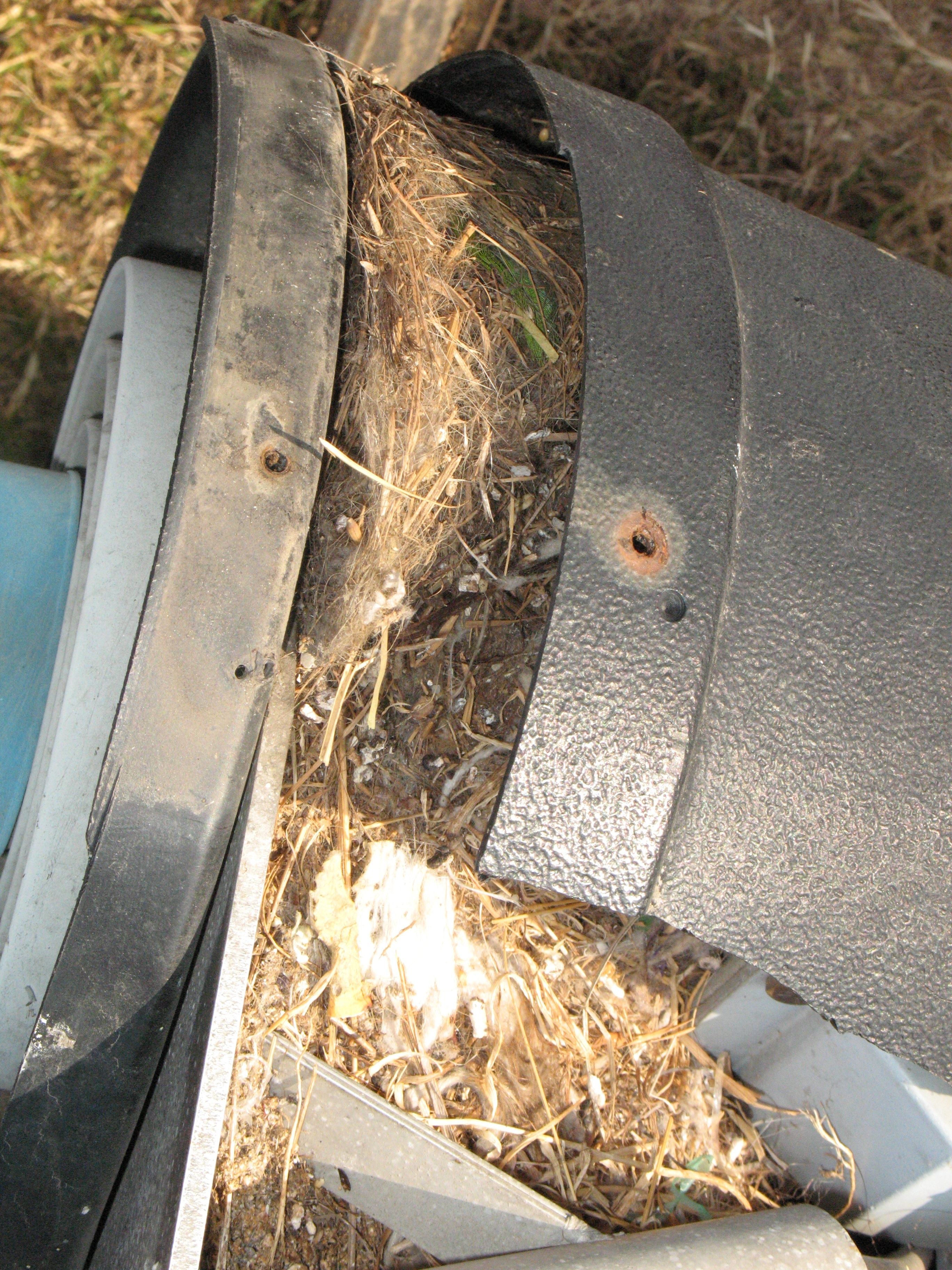

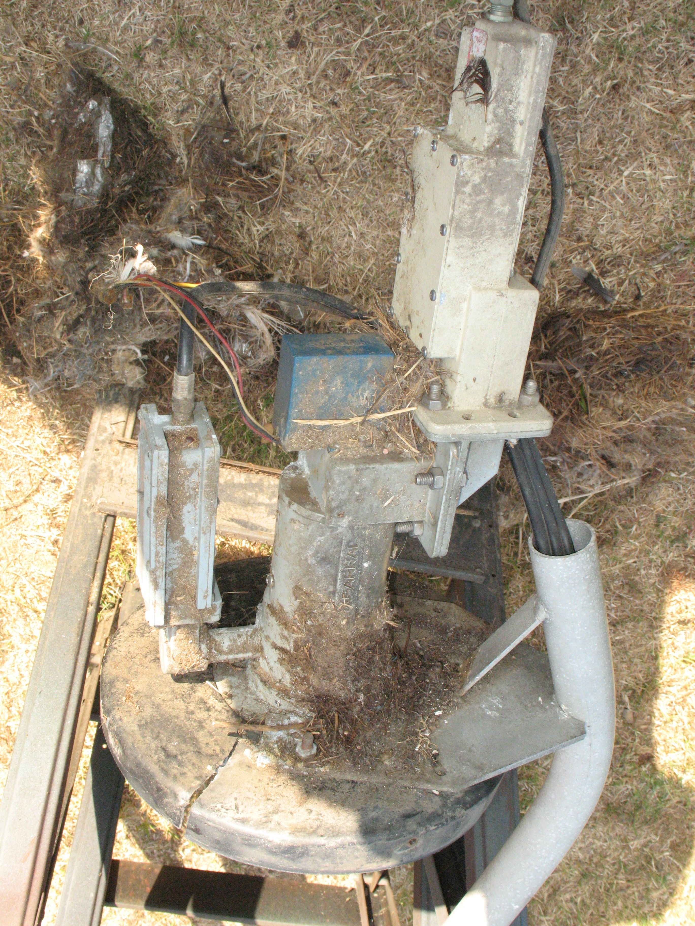

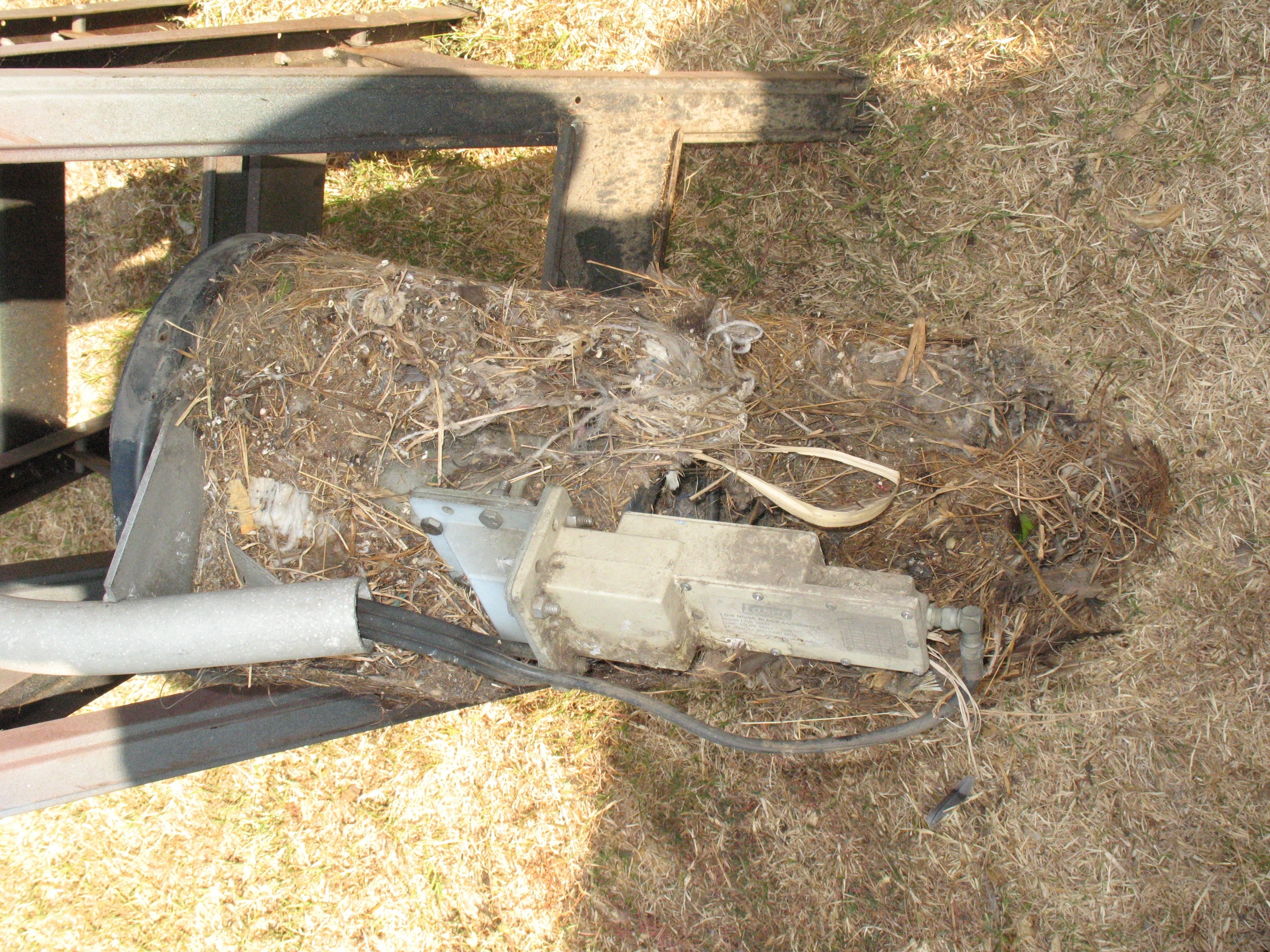

Finally opened up the feedhorn & LNB cover today - looks like there had been many tenants, from sparrows to owls to parrots. The entire cover was packed full of nesting materials! 'Bout filled a 5 gal bucket! :eek:

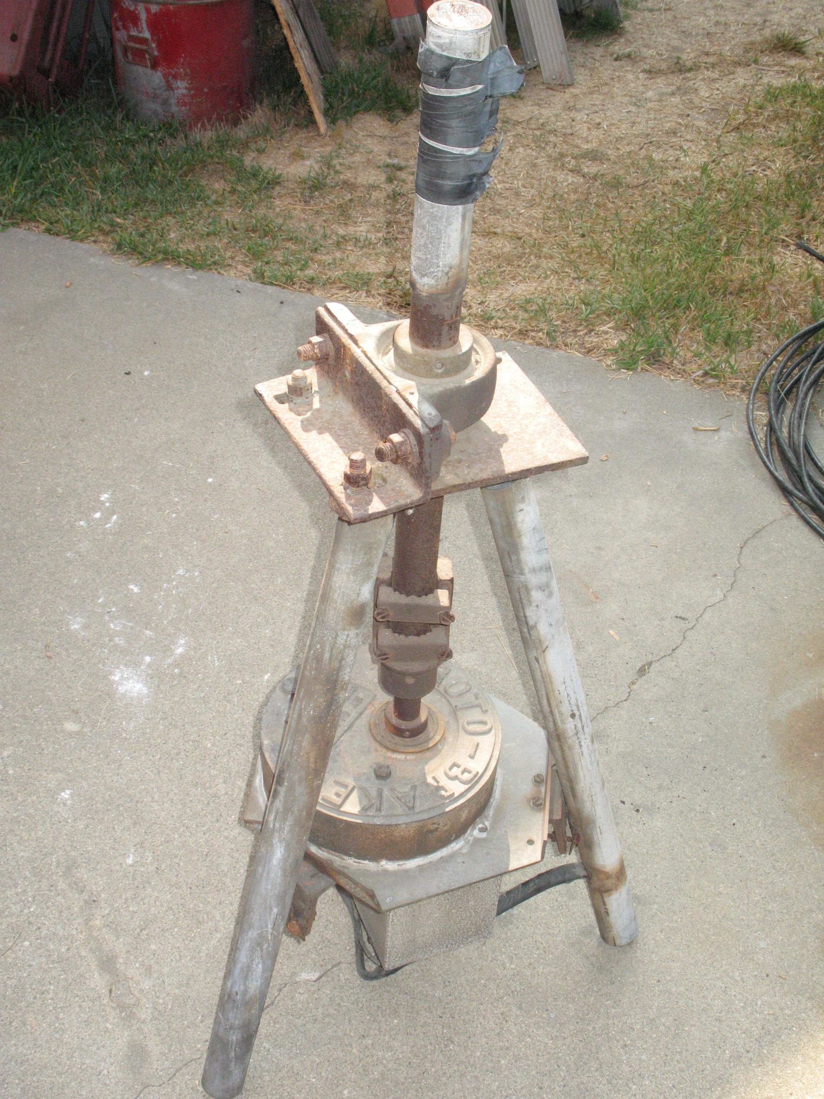

One of the mechanics where I got this Paraclipse mentioned that he had a ham antenna rotator. Picked that up today too.
