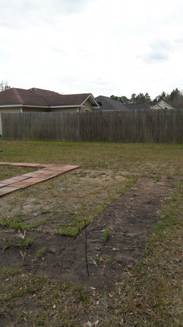

Update...relocated the pavers for my patio(another project in motion) and picked a good spot to plant my dish(green stick indicated). Next week this time will be digging the hole and planting the pole and concrete!

Are you sure that tree top in the upper left corner that I can see between your house and the house next door isn't going to block any sats?
As far as I can see...that tree is more south east than it looks plus it is located on the other side of the street behind the neighbors house. But once I get the dish up, I will be able to see if that will be a problem or not....Good eye tho! Thanks!

With a elevation of his 34 degrees, should be no problem.
Maybe not, but Dishpointer makes it so easy, and it sucks to find out AFTER that moving the placement of a dish pole even a couple feet one way or the other could make all the difference in the world. Especially a c-band dish that needs 800lbs or so of cement to hold it down. Can't move that easily.
I think he will be fine. I had trees closer than that and taller to my southeast and could still see down o 34W. Just hope it is up soon and we get a report.

Solar outages are starting to happen now and may benefit you. Go out and stand where you are going to place the dish and check if the sun will rise through the tree. If not you should be good.
Sun rises directly east (front of my house) of where the dish is planning on being. There are a line of trees behind the neighbors house on that side of the street, yes the sun rises thru them.
