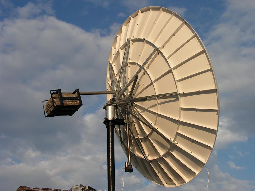

a few pix ideas
A fellow in Poland (?) posted some pictures of his new 3.7m Prodelin and how he installed it.
Unfortunately, his web site is now totally devoted to cute fluffy little dogs, and all dish info is gone.
Here is one picture, showing his counter balance.
The pix aren't too big, so if anyone wants to see the entire collection, I can post.

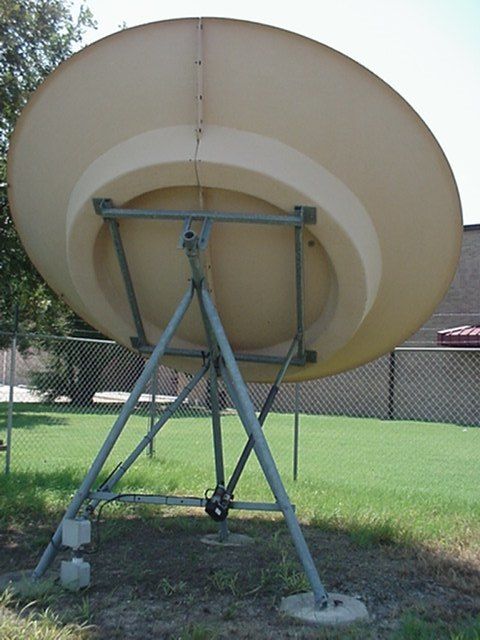

The second shot is an old 15' United Satellite.
It's a molded fiberglass similar to the one on my local Post Office.
I think you can see how the mount is tilted back about equal to the latitude, and some declination offset is apparent, too.
I've seen similar pix where a large-throw jack runs 'em back 'n forth.
edit: oh, look close - he's got one! - ;)
With a little imagination, you could implement this design quite easily.

A few pics ideas.......
Thanks for those pics, Anole, that one of the tripod mount gave me some GREAT ideas for my 10' solid "Drake" dish. :cool:

A counter balance will give equal pressure on the actuator all the time. If weight in front is nearly equal to the weight in the back (counter balance) then it wil run very smoothly and take much less force to move the dish.
