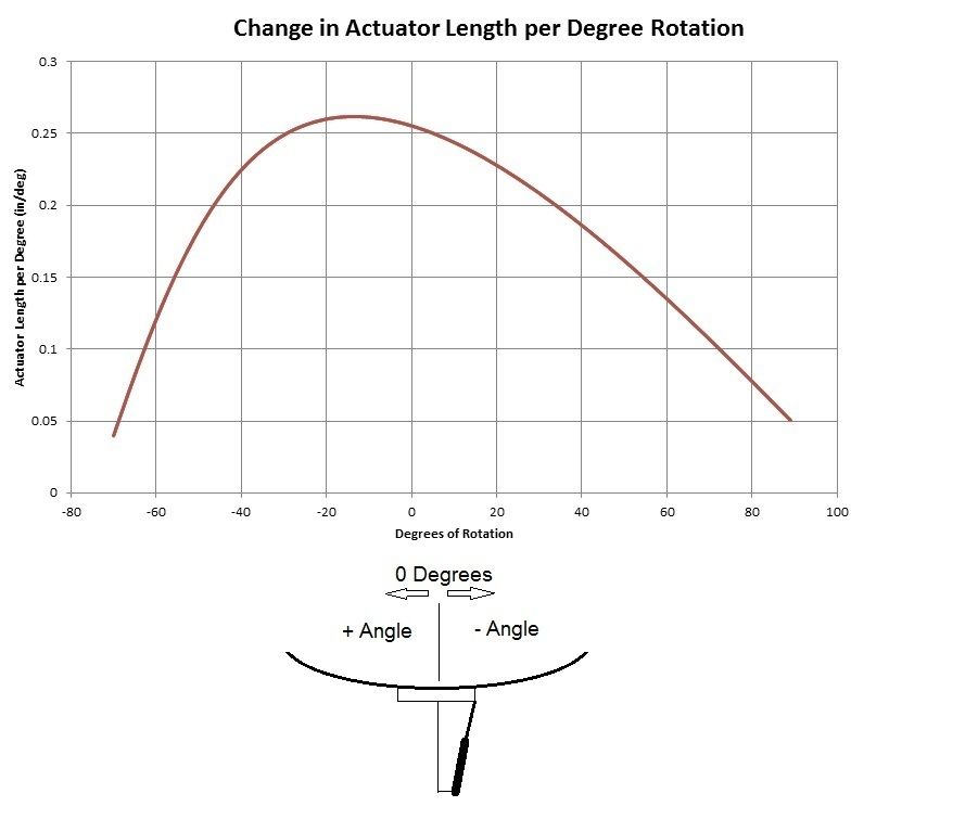

Here's my graph-a-function post for the day. Say you have a 24" actuator moving a dish. The actuator is mounted 8" out at the fixed point and 15" out from the dish pivot, referenced from north-south. The graph shows the relationship between dish angle and the rate at which the actuator extends or retracts in relation to the change in angle of the dish. Note the relationship is not symmetric and the "slowest" dish movement is where the dish lever arm and actuator are perpendicular, not at 0 degrees.
If you knew the counts per inch of your actuator, you could easily tell the resolution (counts per degree, or inversely degrees per count) you'd get with this setup.
