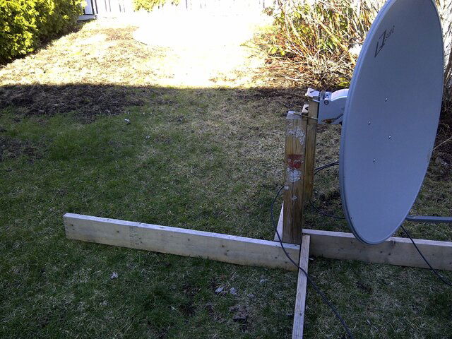

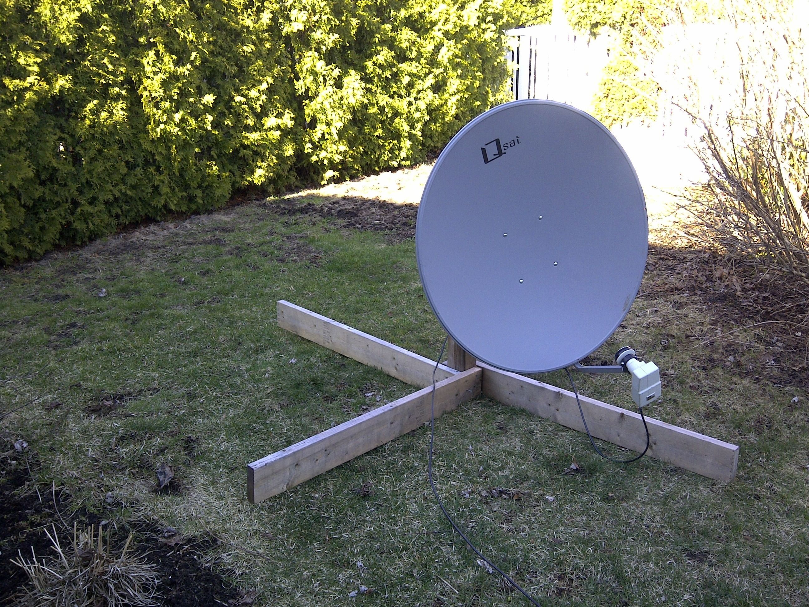

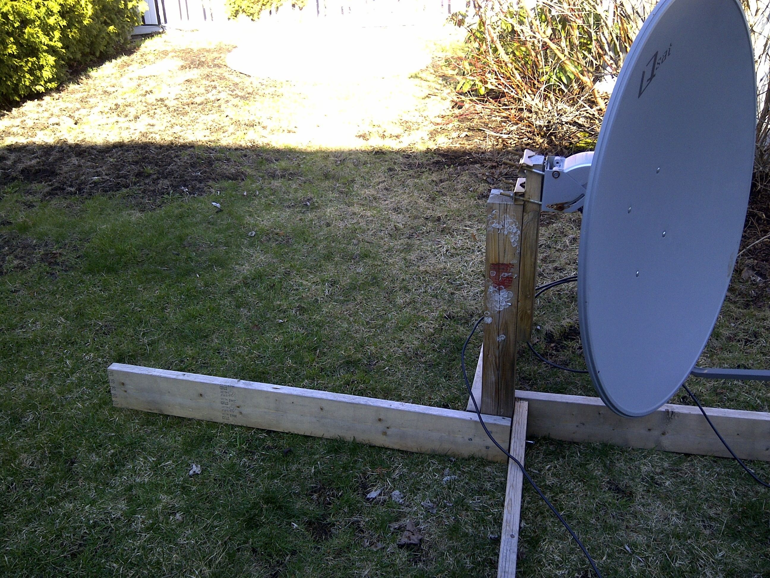

As promised..here are 2 pics of my "mount".. who knows, maybe it might give someone some ideas or use for a good laugh. in hindsight, I should have simply driven the main wooden post into the ground w/ a sledgehammer.
