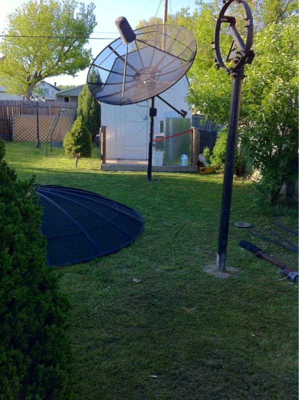

putting up my third bud today. it is a 10' channel master that was given to me.

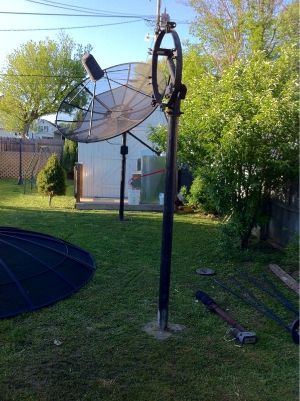

new 10' channel master is up. for now it is c band only with a cheap chinese lnbf that works well. some cheapo DMS lnbf.
some observations of the channel master dish:
it is well made imo. the feed struts do not have slots like the sami dishes. when i bolted the struts on the dish it was perfectly centered! this was nice. took some install time out of the project.
the old saginaw 24" arm worked! i lubed the worm gear. it has a weather boot on it so i left it there. the boot has holes that face the ground i guess to let out any water that may get in.

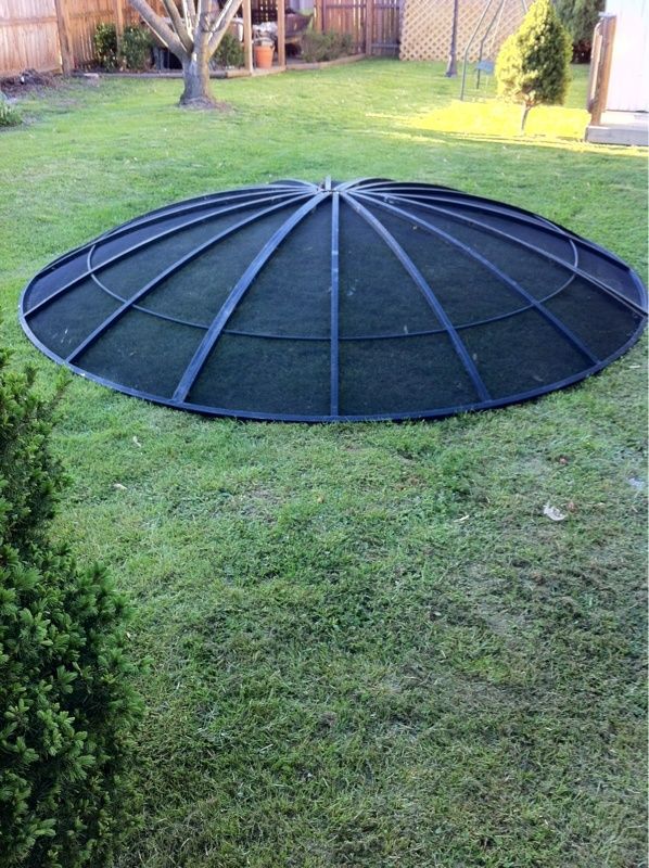

c band reception is superb. i am getting very strong s2 signals. this dish is dented and dinged from 30 years worth of hail storms but works well.
i have a corotor II and norsat lnbs so i will give ku a try in a couple of days. i know it will need some alignment tweaks for ku.
i am very happy with it.
