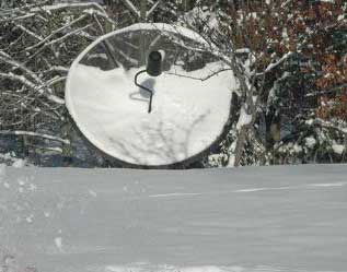

Wife just emailed me that we have no picture on the dish. says "noggin" on-screen but no picture.. no sound either.. just static.
tested multiple channels.. nothing..
wonder if it's "snow fade"... ;-)
(that's a 9' dish BTW)
Time for you to get the old broom out and remove the snow, the snow is probability making the dish drop down due to the extra weight and you've lose the signals.
I know.. I posted that more for fun than anything.. for a 9' dish, yes that's a lot of snow! ..snow fade ;-)
I wrote her "get the broom, go brush off the dish".. that's not what she wanted to hear.. good thing I didn't include "and while you're at it, fire up the tractor and plow the driveway" (we got about 15 inches of snow in the past 2 days)

when I got home I cleaned the dish off.. few inches of snow on top of ice.. so that was a lot of weight on the dish.. and I think I need to tighten the mount or something.. there's a lot of wiggle in that dish.. or maybe it's normal.. dont know

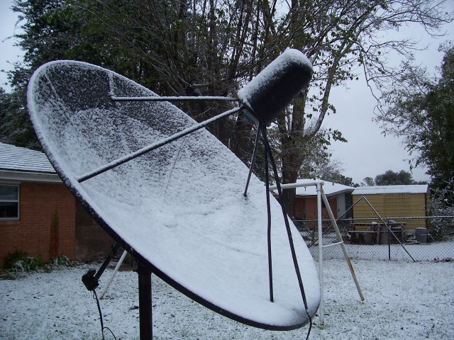

I had the same problem with my 7.5 foot dish this morning.
And I live futher South than Stogie and Tron, about 30 miles southwest of New Orleans.
what? I don't see anything.......
OH.. OHHH.. oh.. there it is! now I see it.. :D
