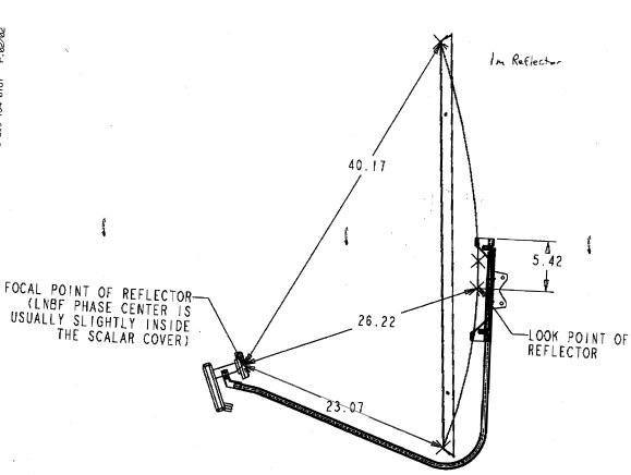

Is it a Winegard DS 3100? does it look something like this?
what i do is tape a length of string at the very top and very bottom of the dish. mark the bottom string at slightly over 23" and the top string at slightly under 40 1/4 "with a marker. tie a knot where the two marks meet. pull taught and thats where your focal point is. it should be about 1/2" inside your lnb and not right on the protective cover. draw (or imagine) an x between the 4 bolts that hold the dish to it's support. the lnb should be aimed/tilted at the centre of the x
