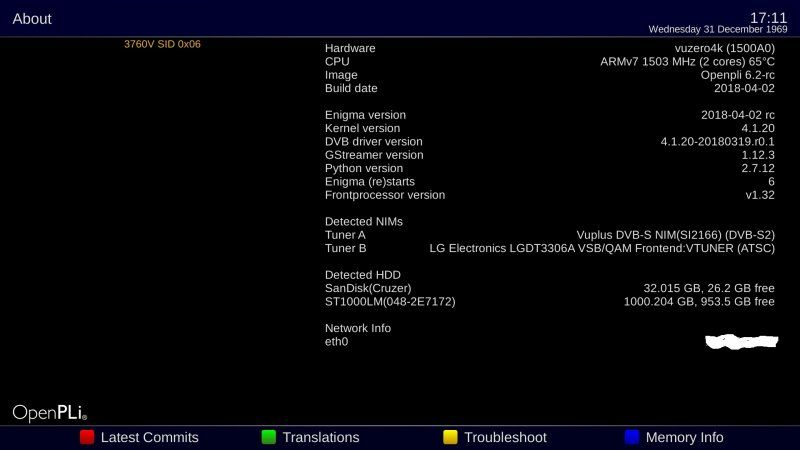

Hello all
Got my PVR KIT about a week ago, installed the HDD, initialized the HDD and the receiver recognized the HDD right away, it records good and plays back with no problems, during restart it takes a little longer.
Regards.
Tunder
Does it blindscan? If possible, I'd like to see the screen for that.

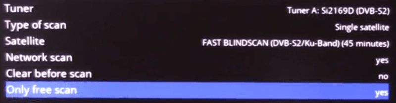

In the video you posted at the 5:15 mark, it indicates that a "FAST BLINDSCAN" for KU takes 45 minutes. And then its gets worse. If you want C-Band DVB-S2 it shows "90 minutes" (at the 9:26 mark). :facepalm
That's after you shell out $229. I wouldn't want to use the ZGemma H7 even if it was given to me.
Eek, 45min for a "fast" blindscan. Is that some sort of bug? How long does is blindscan on VU Plus Zero 4k and what does it show on the same menu?
The VU Plus Zero 4k performs a hardware blind scan of DVBS/S2/SX modulations in a single scan between 4 to 8 1/2 minutes depending on the services on the satellite.
While time remaining for the scan is displayed in some images, I don't recall seeing it on the E2 images that I have tested.
Reactions: Babadem
