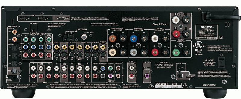

It is highly likely that it is a total of three ONLY, and you can choose to use either HDMI or Cmpt on 1 and 2. NOT all separate for a total of 5. Do you have a pic of the rear jack panel? I can tell from that.
That's what I was thinking...only 3 total HD inputs allowed. Picture of the rear is attached.
I have this exact receiver and on Onkyo, the DVD input is treated seperately if you use HDMI. So you could have 1 DVD HDMI input and 1 more HDMI and 2 component or 1 DVD HDMI and 3 component.
I have my DVD on HDMI In1, my QAM cable box on Component 1 , Xbox 360 on comp 2, vip211 on comp3.
