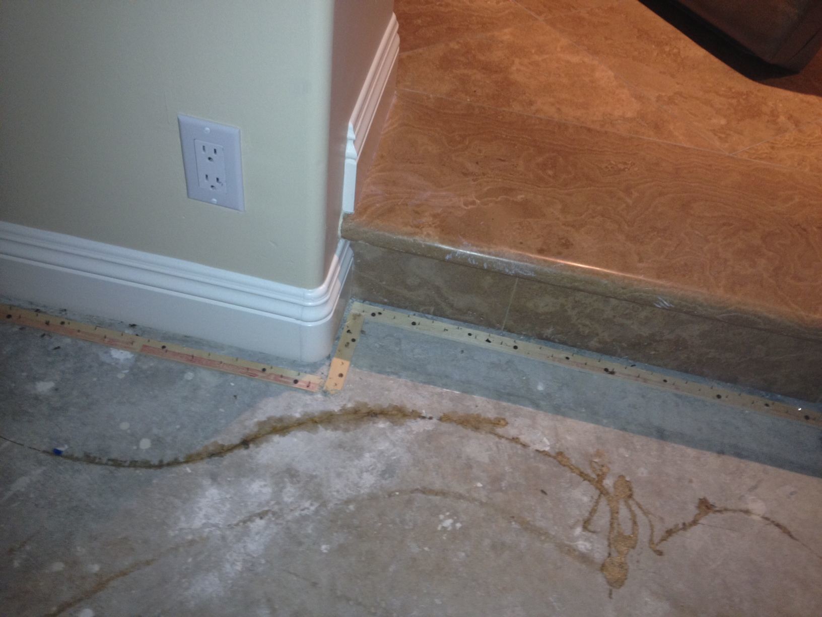

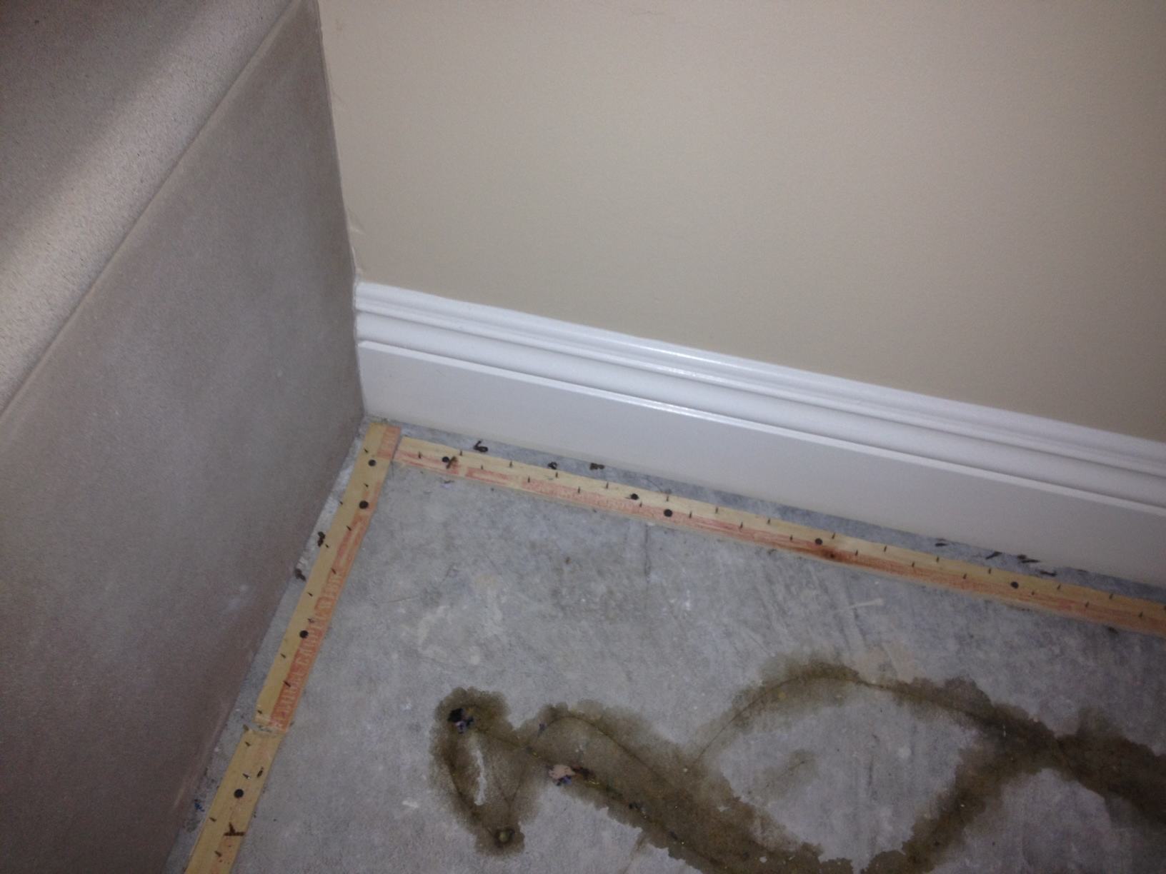

For clarification, the cable will only go under the carpet (on top of a concrete slab) in my house, in order to run along the side of the walls to get to the other side of the room. The reason I'm doing this is so I can put all of my equipment into a small cabinet and hide it behind my sofa.
I will need to run 50-ft of coaxial cable, as well as a slim profile HDMI cable and left, right and center speaker wire. I ordered cables from mono price and am waiting for them to be delivered, and am hoping the cables fit between the tack strip and the wall. Is this just a bad idea? Here are some pics.

It's hard to tell but it looks like the baseboard goes to the slab. If you try to keep the cable between the tack strips and the baseboard you will have difficulty and the cable could very well be damaged when the carpet is stretched. Getting around the corners will also be a problem. In the end, you may get it to work, at least sporadically, but I wouldn't try it. In this case I would probably use wiremold.

I have an idea...If you are going to get new carpeting, take out the tack strips along the intended cable path. The carpet installer will nail down new strips.
just have them placed so that the cables are not at risk.

I think it will work like a charm...Have them leave small gaps about 4-6 inches from the wall at the corner through which you can pass through your cables. This way you'll not have to worry about a sharp curve at the corners.

A brand of surface mounted raceway. Pretty much any brand of surface mounted raceway solution would work - I've just had good luck with WireMold products and they are readily available at home improvement stores (I usually pick it up at Menards or Ace Hardware). Panduit also makes some great raceway products but it tends to be higher end and more expensive, though almost any electrical supplier carries it.

Yes, that would probably work but it means ripping up the carpet - at least in the corners - to make cable changes. I think you are also asking for trouble relying on the carpet installers to work around the cable (at least if they are anything like the installers around here!). I could see cable shifting and getting crushed or punctured from the stretchers and tackers.
Again, I have used this method successfully many times but not with the amount and type of cables the OP needs to run and not with the environment/conditions/routing shown in the pictures. It may work like a charm but there is a good amount of risk that something will go wrong which could end up being both a headache and costly to make right (especially if it involves ripping up the carpet).

That may be typical but the pics posted by the OP show pre-existing tack strips fastened to the slab in this case.

Check his photos. He HAS torn out the carpet.
They come up real easy with a flat bar or wonder bar. A whole living room full of tack strips can be removed in 15 minutes.. Just as easy to nail down news ones.
