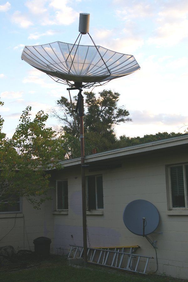

I have a low pitch roof and what worked for me was a vertical pipe just past the roof edge running into cement in the ground and braced to the side of the house with a heavy duty bracket I made out of angle iron.
Can post a picture if needed.

Please post pics. A 21' pole cemented in the ground with side supports attached to the house is the way I was going. I am having a difficult time creating the brackets since my roof hangs like 20' over. My wife is also not thrilled about a large pipe attached to the house. I would prefer not penetrating my roof and a I don't have LOS from the ground. Thanks.

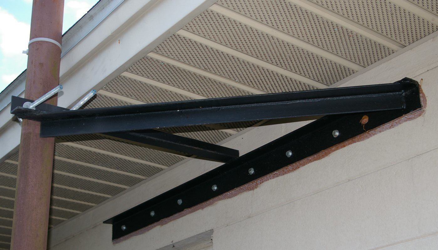

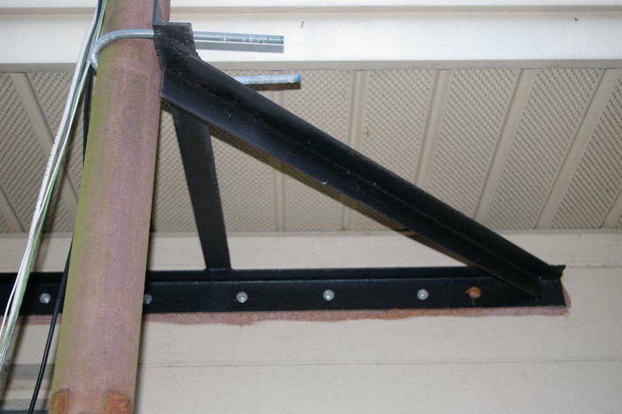

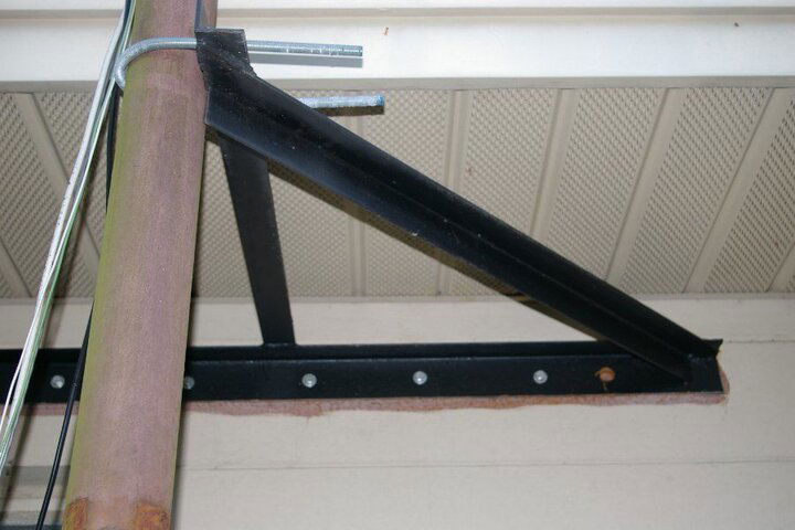

Hi, here are the pictures of the bracket I made for my 10 foot BUD. I did not have access to the other side of the wall so I had to use lag bolts/shields to attach to the block wall. I used heavy duty urethane construction glue to help prevent any movement between the wall and bracket.
Let me know if you have any other questions, DC

Nice pics! Did you weld the bracket together?
Hi, yes - we have a nice MIG welder at work so I fired that puppy up and let the sparks fly.
If you do not have access to welding equipment I would think you could get a welding shop to finish the bracket for you.
Good luck with the project, DC
