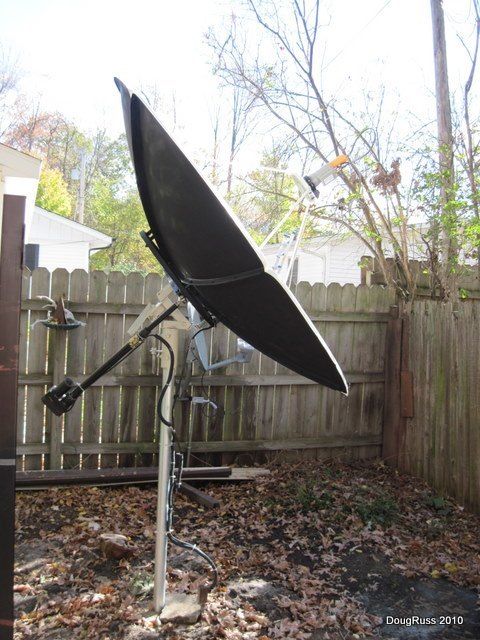

I too had a few spots where the Paint chipped and rust started forming. Sanded and primed the areas and repainted the face with Flat Black "Rustoleum" and sprayed the back of the Dish with several cans of Rubberized Undercoating.:up

Thanks. I was wondering what kind of paint to use. Never thought of black on the back. :)
