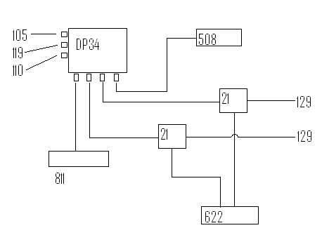

Has anybody tried cascading a dp34 and a dp21 with a 622 yet. Thats how i've had my 811 connected since Voom. I tried with my 622 with no luck. It recognized the dp34 dp21 in the device field but only picked up 2 of 4 satellites on both tuner inputs (129 and 110). 110 was one of three going into the 34 along with 119 and 105... and 129 was by itself in port 2 of both 21 switches. The other 2 sats came back with X's. I thought maybe the 34 wasnt getting enogh power through the dp21's so i connected 2 other receivers to the 2 open ports on the 34 with no luck. Just wanted to see if anybody else has succesfully tried this with a 622?
