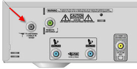

This is going to sound stupid, but are you sure you are plugging in the OTA antenna into the correct jack on the back? There are a number of them on the 622 and if you don't have it in the correct one you will not get an OTA signal.
*edit* see attachment for correct connection.

All good stuff but I DO sub to locals they just failed to turn them on at first. I am only 5 miles from some stations a CM 4221 should surely do the trick. I do not have a HD TV yet so no other tuner to try. Not stupid, I thought of the wrong connection too so triple checked that
