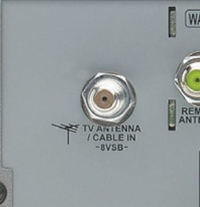

Heh, you deleted your post pretty quick.... It is in fact a "Cable In" connection.
I had to go back and check my facts. If you would do the same, you'll find that IceToad was wrong. The key is the -8VSB- under the legend. While some may exist, I've never seen a cable company that broadcast in 8VSB.
I don't know enough about that to comment. I thought "8VSB" was related to ATSC and the label was kinda wrong. It should read "TV Antenna (8VSB)/Cable In". I could be 100% wrong though...
