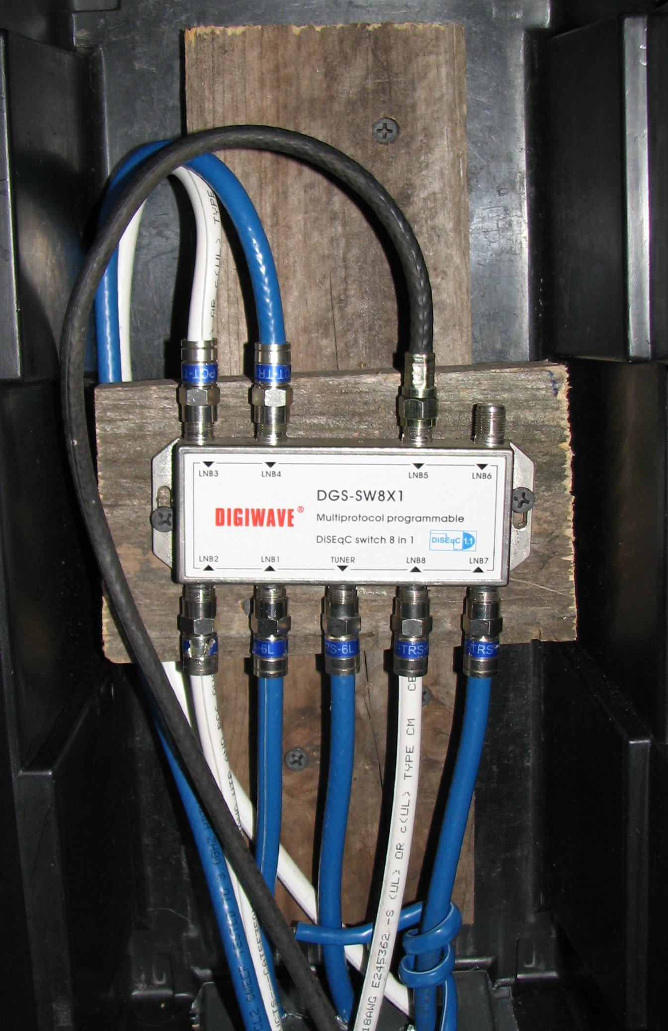

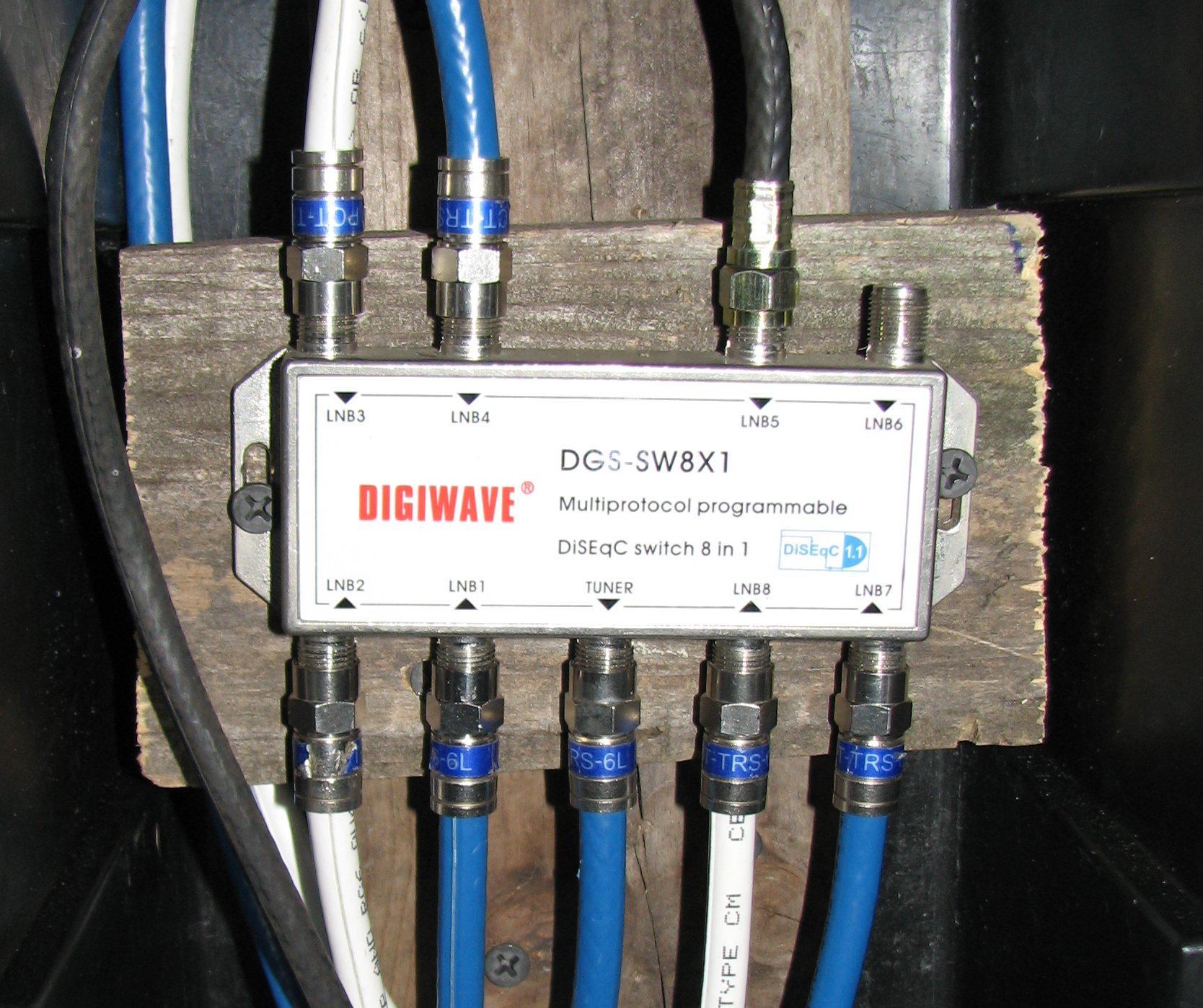

This has worked wonderfully for me. I'm an idiot and I was able to make this work and make changes to it fairly often. There are 5 ku dishes and two C band dishes on it right now.
It's the simplest and most reliable component in my system. I highly recommend it.

Very nice De Ann. How long have you been using that same switch?

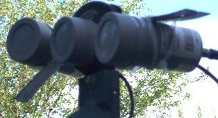

Yes I can see that baggin, the 95W is easy to get in. I was testing with my PrimeStar 1m today. First I tried to, well I had 103W on arm so I to get in 97 wit it but no deal, 97W would not come in. So then I put arm on 101W and tried to get 89W in no go. So just for the heck of it I tried 95W it came right in wit 101W both at a high signal. But I do not want 95W nothing on it now. So then I tried to put arm on 83W having a hard time finding it. So I put arm on 72W and tried to get 63W and 83W no go. So I just put it back on 103W. With my 4 dishes I am hitting G17 91W-103W-101W and 83W, I would like to also have 63W and 72W and 89W and 97W. It would be easier to get all sperate dishes but costly. I'll just take it slow and see what I can do.
103 and 97 should work (I have 97 at centre and 103 off-centre on a 80cm) you might want to point at 97 at centre (of course, always make sure you are aiming with a good strong transponder first, you can tweak for the weaker ones after you get it positioned) and then check your signal quality at 103 to see if it is acceptable being off-centre. If not, put 103 back at centre and re-try 97 off-centre.
101 at centre, 89 is 12 degrees off-centre, way too far away, remember 6 to 8 degrees off-centre is optimal (unless you put both off-centre and split the difference).
72 at centre, while 63 is only 9 degrees off-centre, there is only the one transponder, and I have noticed that it fluctuates in signal quality a fair amount and is not what I would call a strong satellite (some here have a hard time getting it, even after the signal was boosted) and wouldn't even try for it that far off-centre. As well, the mux will disappear July 31st! If you had a hard time finding 83 at centre (it seems to want pin-point accuracy, little margin of error) then I can see why you would have even more trouble finding it with 72 at centre (as it is 11 degrees away). I do have my 75e dish with 83 at centre and 72 off-centre and get very strong signals on 72, but that is because of two factors, I am using an elliptical dish, and (more importantly) 72 is a very, very strong satellite for me (probably one of the strongest I get). So you might want to try 83 at centre, and 72 off-centre to see if it is strong enough for your liking.

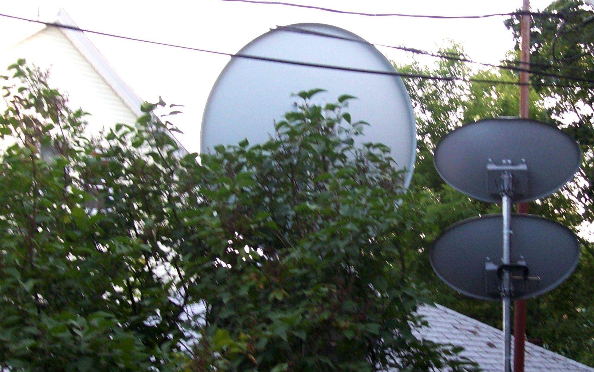

Yeah my 1m is elliptical also, but I only have like about a 4ft area in my yard that is clear from about 61W to 110W. So I have my 4ft dish up high cause of buildings and tree's. I cemented a 10ft fence steel pole into ground about 4ft with rocks and 240lbs of cement, then I got another pole and drill holes thru both of then and connected them with 3 bolts. So it is up about 12ft or 13. So I did not have another spot to put 1m dish on so I just cut a short pole and connected it to the other pole undeneath the 4ft dish. it is level but it moves around a bit when I am trying to find sat so it makes it tough to find 97W and 83W. On 97W first I put it on 95W and set EL for 97W and just moved it ahead slighty but no good. I do get 97W signal in to good here. When I had a motor on my 1.2m dish the highest Q I got was like 60% and the low ones where like 30 even 20%. Strange about that sat is one time I had a channel in good and receiver showed no Quality signal on it. Well I just rigg that dish up the 1m one. I know it must be much higher to get better signal on some sats but that is the only spot I have for it. to right I have a DTV world dish on pole hitting 101W. I have a extra plastic lnb holder that broke so I use that stuff mighty putty to fix it I am letting it cure for 3 days then I'll see if it is good, if it is I will use jigsaw to cut holes big enough for 2 linear lnb to fit in it. The Aspen lnb that came with dish is very small. all linear lnb's are 40mm right? but the bullet ones I have are 50mm. That is the problem with dish it will only fit small neck lnb in it. But it is a great dish it is small but it gets signals in almost as good as the 1.2m dish. Normaly I do not get into so much detail because I do not like to type but today I had to take some medicine and it is making me type, lol. More over to the right I have another DTV world dish on another pole hitting 83W maybe I can get 72W with that but the dish is a 36x22 elliptical maybe to small?
but with this pole cause of trees I cannot get anything past 95W. So that is why I would lke to get on my 1m dish 83W and 72W so I will be hitting another good sat and it will free up the other dish so I can put it on 97W or 89 or 63W. So Then I will be adding to mote sats bring me to 6 sats and then if I can hit 101W and 103W on my other DTV dish buy putting the 2 50mm lnbs in there I'll have 7 sats. And then I would just have to buy one more dish to hit 89W that'll be 8 sats. I can just put another dish under the DTV dish on one of the DTV poles. Ok thanks for the info Keith.

The 36x22 dish you have pointed at 83, you should have no problem adding an LNB at 89 on that dish. As I mentioned, your 36x22 is not much different than my 75e (35 3/4 x 26 1/2) so I would also try adding 72 on that dish (the NBC mux is very strong) as it might come in quite well for you. You also might want to use something like SatStar - Satellite List to check the satellite strength in your area. If 72 doesn't come in well enough, then you might want to try the same combination on the 1m, with 83 again at the centre.
You could also try 97 (which should come in better than you have been getting, but check the above site) on your dish with 91. As always, it could be line of sight issues and/or interference that could be the culprit.
The point with multiple satellites on various dishes, is to try various combinations until you get some that work. Some satellites are stronger than others, and those are candidates for the off-centre LNBs. Sometimes, due to line of sight issues and interference, or limited space for dishes, you may get it on one dish, whereas a dish just a few feet away, you get nothing (I certainly have had those issues myself!).
I am wondering whether you are getting some interference (on some satellites) from the 4ft dish over top of the 1m dish (after looking at your photo) as the arm and LNB of the 4ft look to be in the line of sight of where the signals would be if pointed in a similar direction. What satellite is the 4ft pointed at?
Yes I am getting interference from trees and house (3 floors) next door. satstar great site thank you. I seem to be in the footprints good on all of those sats mention. My 1.2m is hitting C-band side of 91W. I have to put testing on hold for now, because of very bad pollen infection. I am not even supposed to be outside to much during pollen season. It is saver for me to wait till after pollen season at end of July, but then 2 weeks after that is ragweed, so it is kinda hard for me. (I will go back out though after I am some what better. It is bad cause I have asthma also. Thanks!

Well I finally was able to get it done. I am hitting 6 sats good enough for now. I got a 8X1 switch like Dee Ann. The 1.2m dish is on G17 C band, I am getting 3 sats on the 1m PrimeStar amc9 on the arm at 87% on RTV, then Galaxy 28 at 50% on ABC news and amc 6 at 60% on mux. Then on the DTV world dish on bottom is hitting 101W and DTV world dish on top is hitting amc1. As you can see in pics I used a c clamp on bottom dish and you can see that I do not have a good clear path to S/W sky. I ran out of lnb's to hit anything else on the DTV dishes. But I do not care about 95W or 97W anyhow. Thanks for the all the help guys. I got to put up my digital TV antenna someday.
