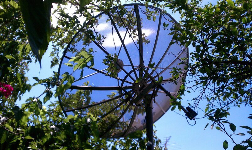

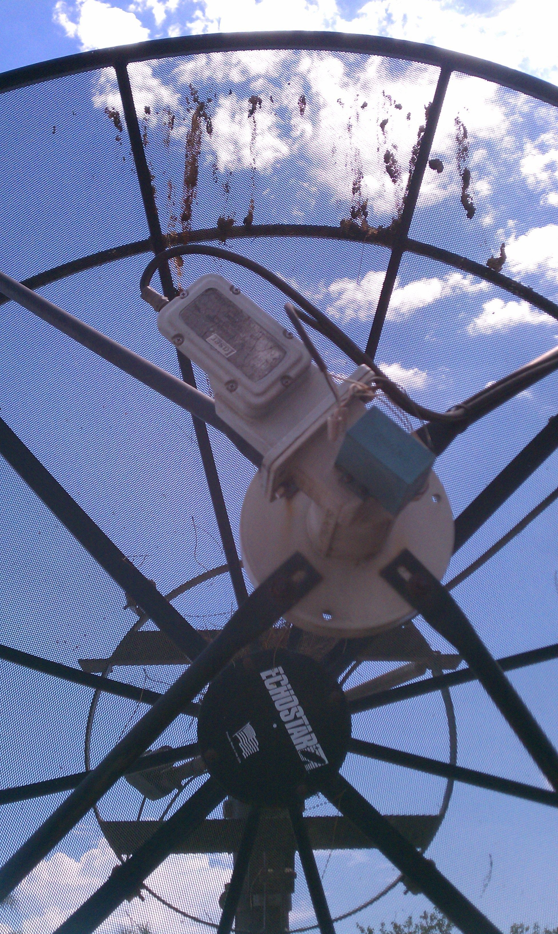

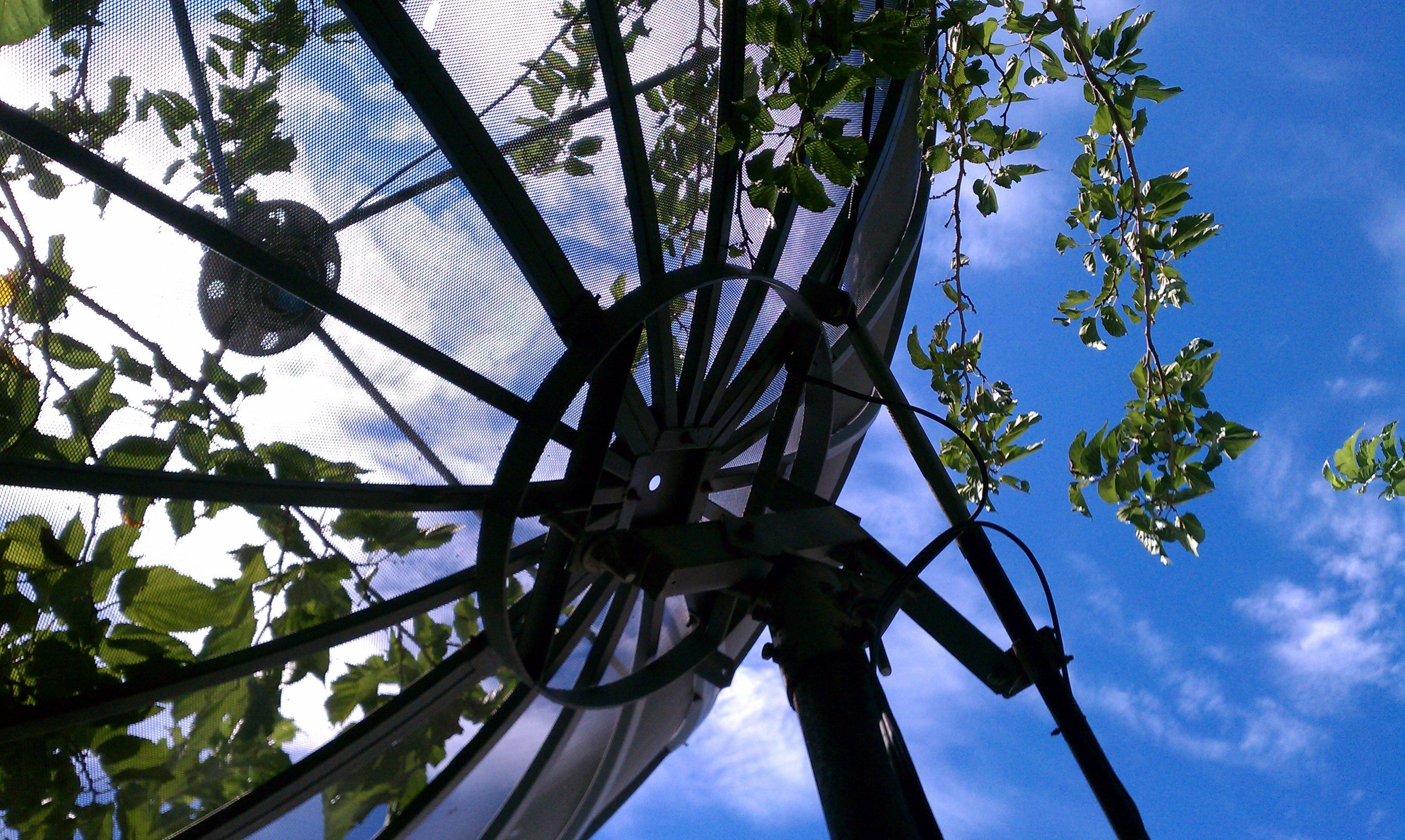

I am looking on replacing my 6 foot dish with a 8 foot, I found 2 dishes in my neighborhood, one is made by echostar, pictures 102,105,106 are from this dish.
Pic. 106 shows the only damage on this dish, it looks clean and very sturdy.
I was not able to find information on this dish in the internet, I look all over this forum and the pictures by tucan-man and was not able to find any look alike.
the other dish on pictures 107 and 108, I was not able to to see the inside of the dish, need to ID this dish
they both have chaparral feeds with co-rotors on them.

I just noticed the mount on pic 105, the echostar dish, I don't see a pivot on it, I wonder if is just a stand along dish, what is the purpose of the actuator.

1st dish might be a 10ft'er its pole is on and extension (disassemble) it has a dual feed feedhorn ( meant to receive H & V C-band only)
mesh should be easy to repair , for some reason the elevation adjustment bolt has been taken off / loose on this one close up of the picture allows one to see it can pivot to track the arc. as for price it really depends on your area , yeah a person can get some money to scrap them but i don't think i'ld pay a lot at least in my area.
second dish looks exactly like my 7 1/2 ft unimesh dish
to compare the two dishes, notice on the first dish has extra ring about 2ft from the outer edge this usually signifies a 10 ft dish, a 7 1/2 ft'er usually doesn't have a support ring. a 12 ft'er usually has 2 rings ( of course there are exceptions) but this is the general rule i use to compare mesh dish sizes.

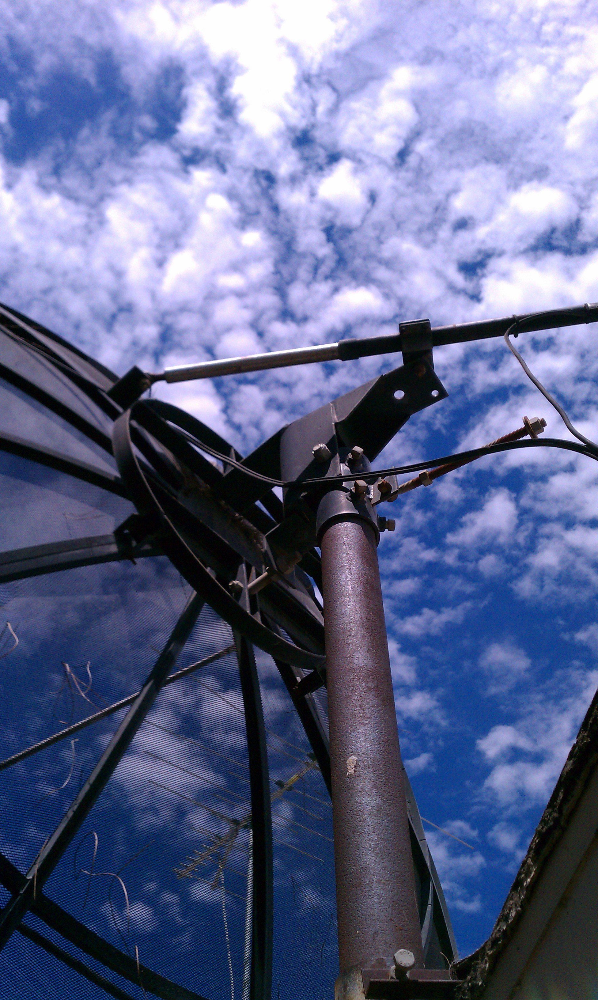

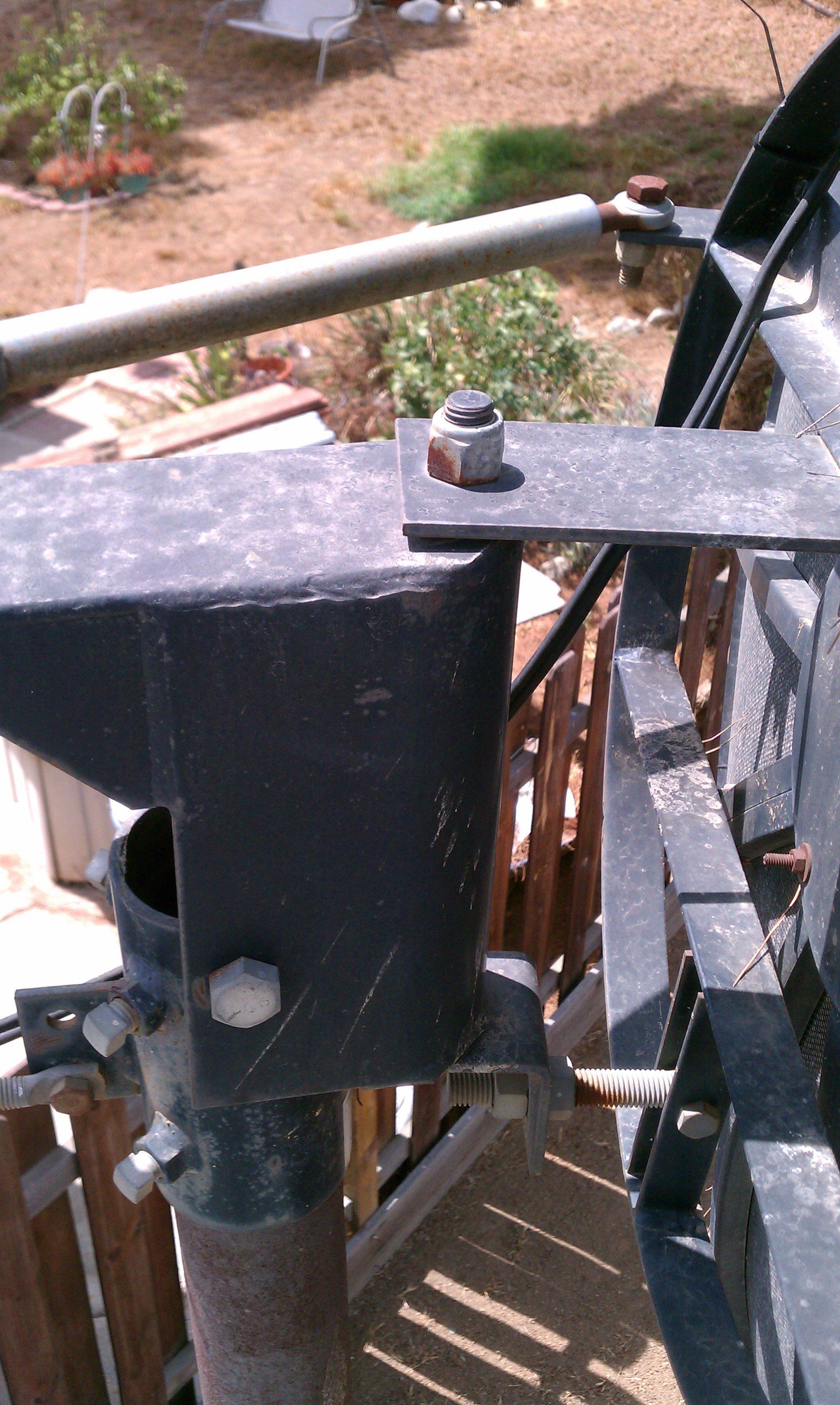

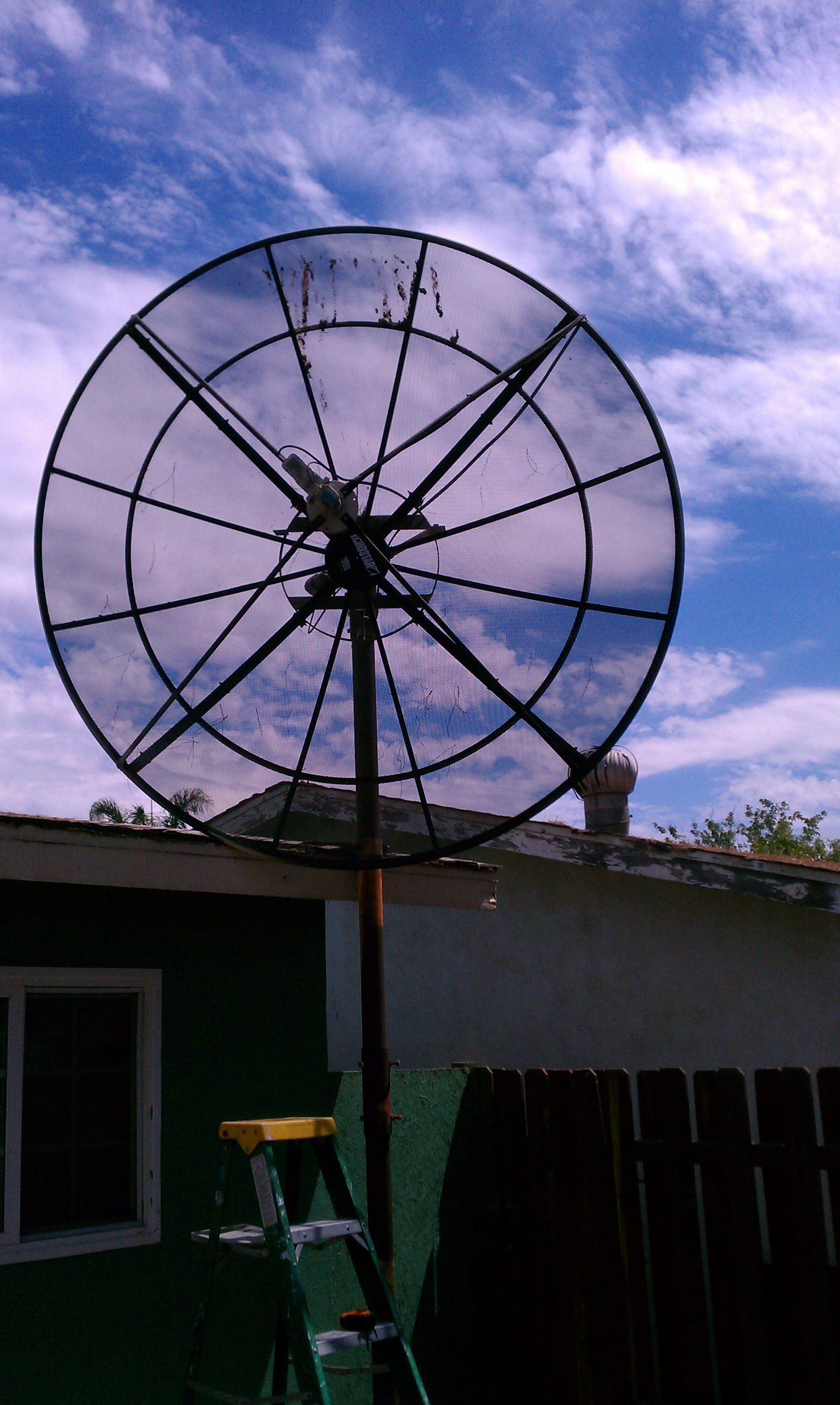

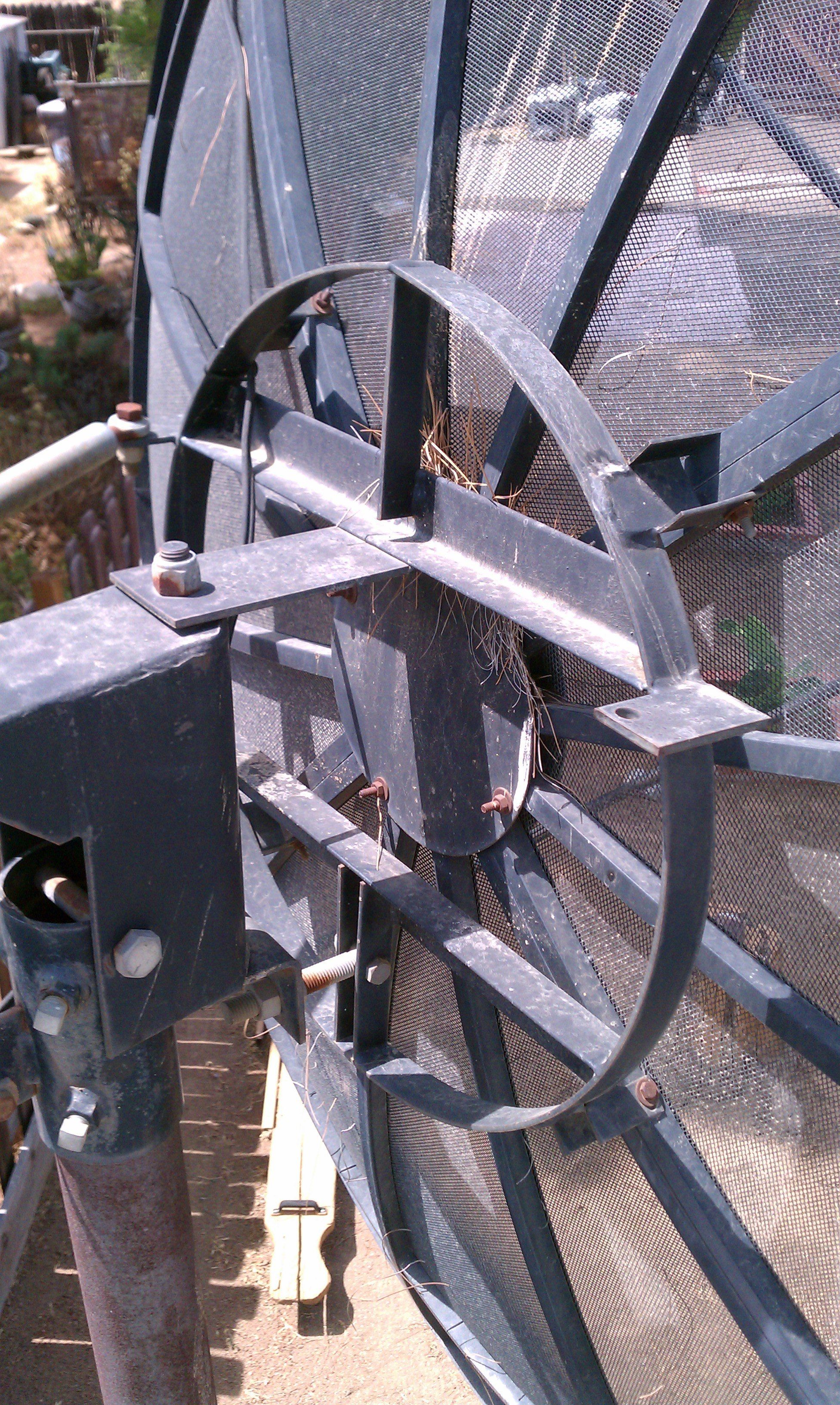

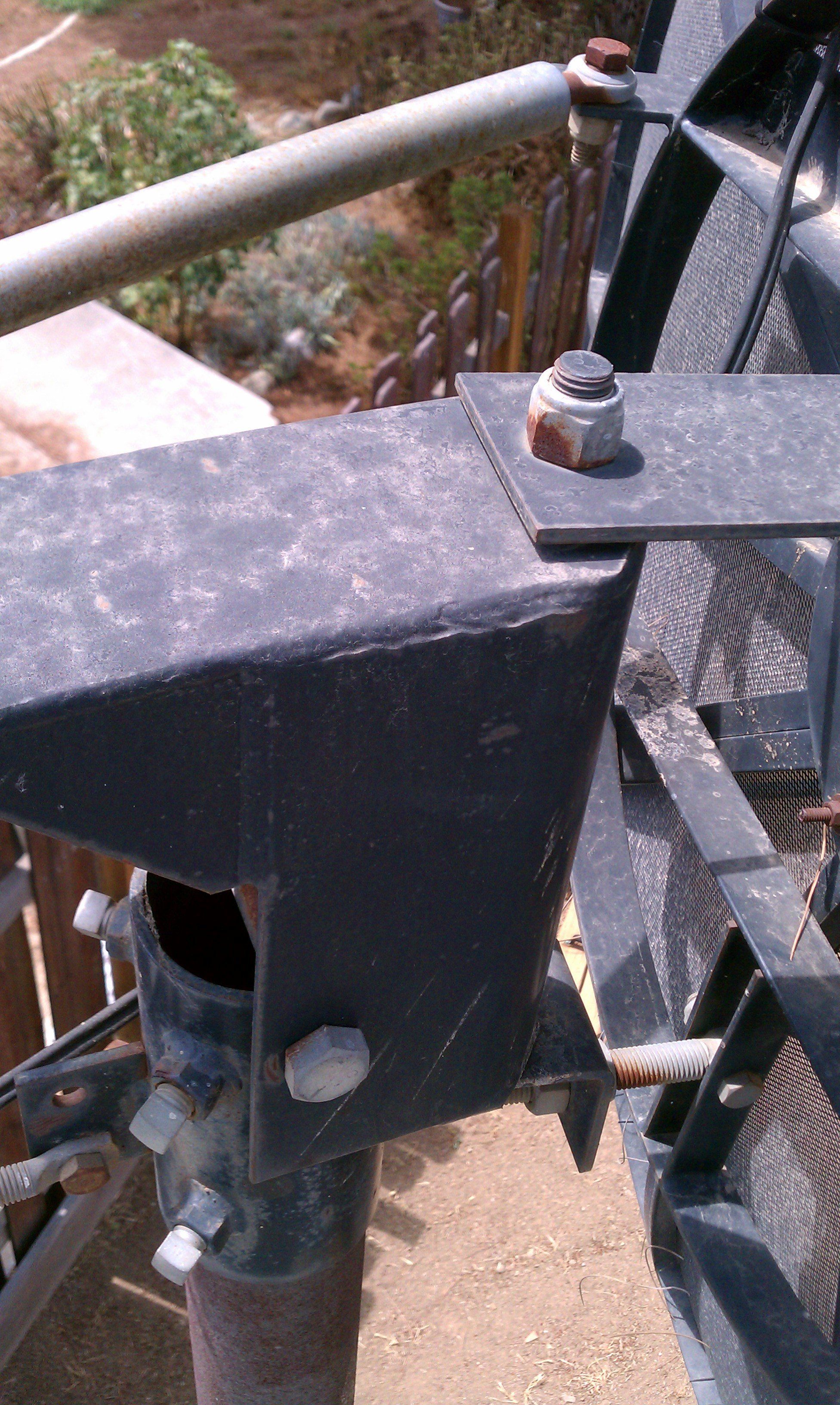

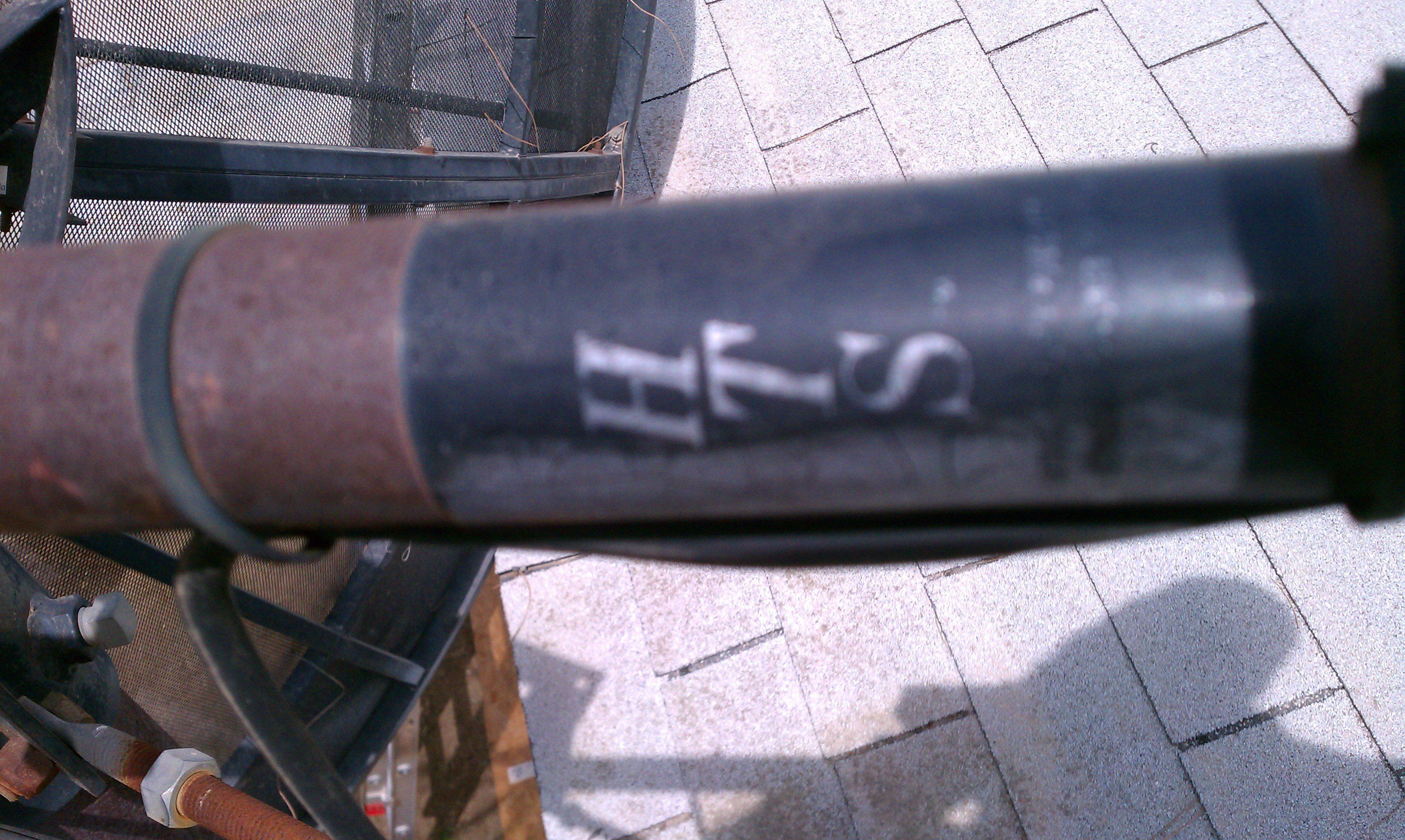

Hello Gents

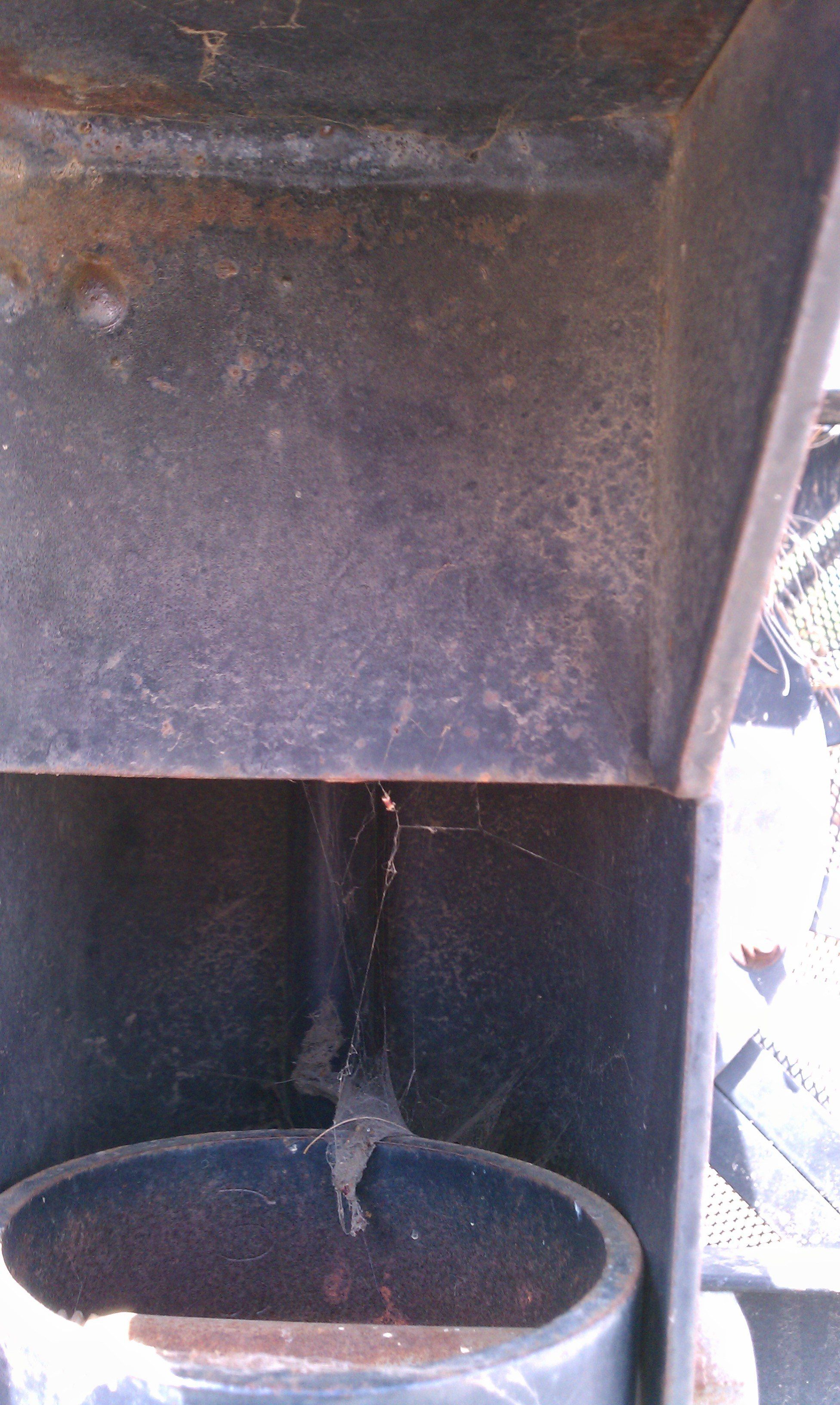

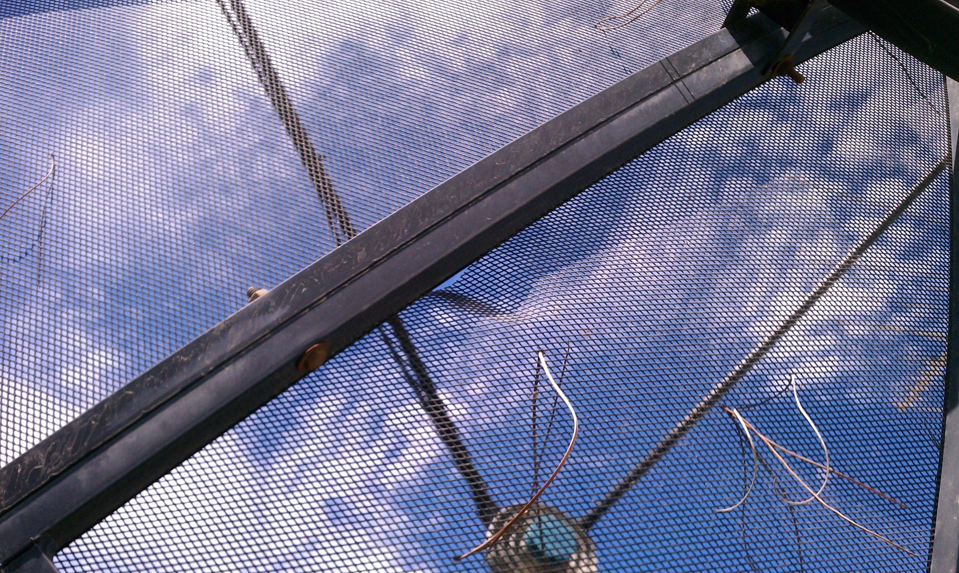

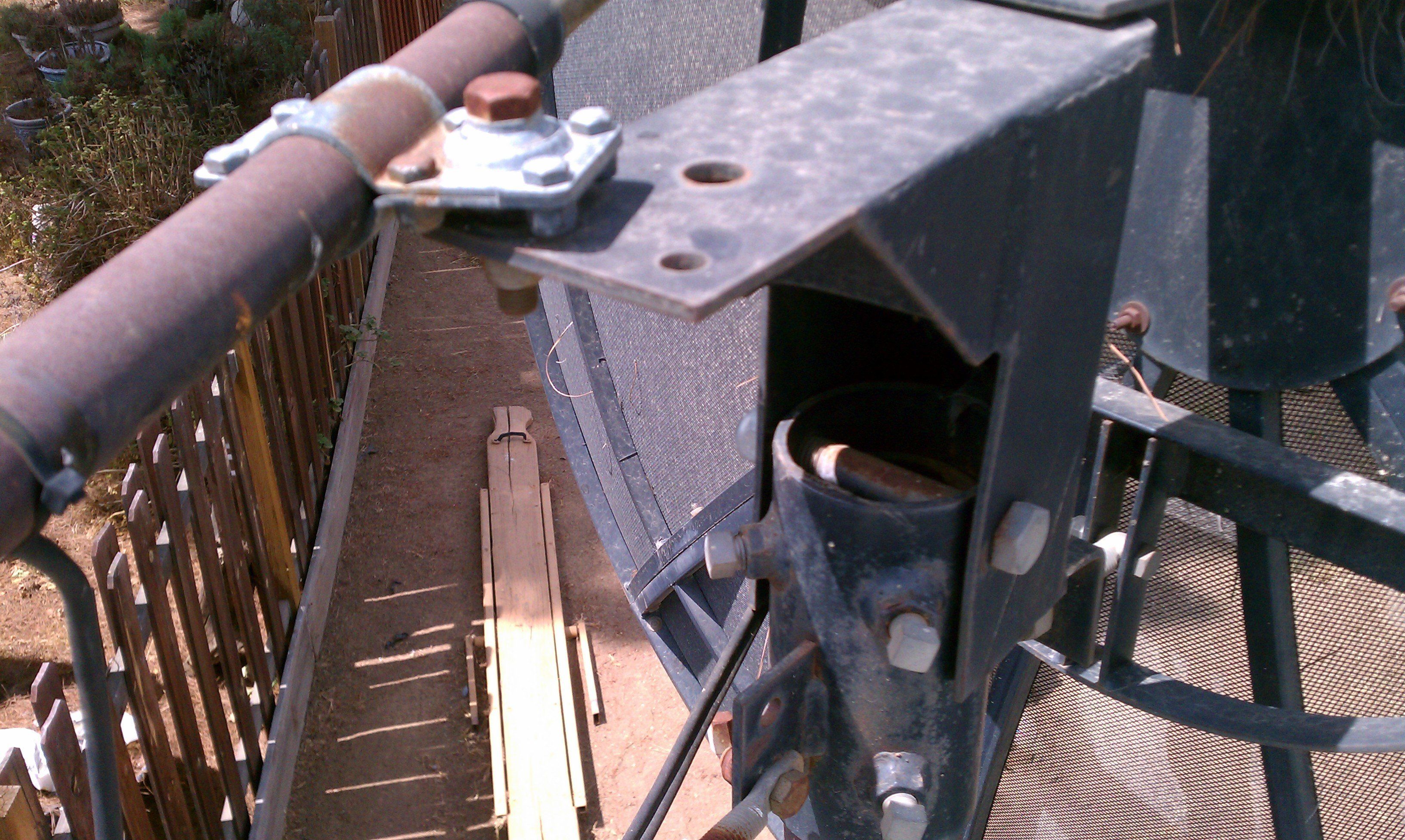

Thanks for your comments, I took more pictures today, it looks like the dish is a h-h dish, it has a label on it, this is the information:
Satellite antennas
located in Richland, WI
lnb made by Laser.
it has a HTS actuator.
Just wondering if any of the members here have a sat dish with similar polar mount and how good they perform.
the dish is 8 foot.
any comments would be appreciated.
Regards.
Chewie

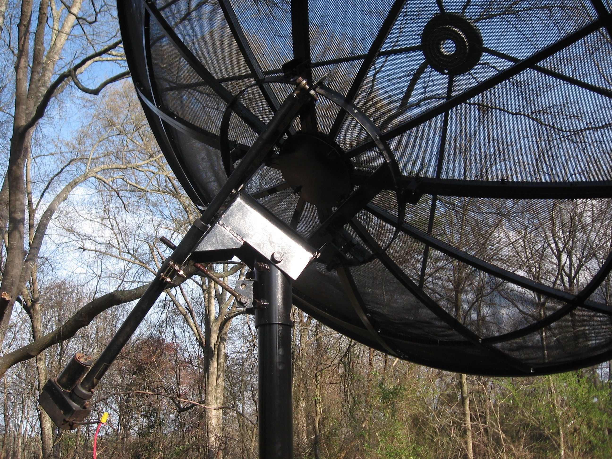

My first dish was a K-Tronic 7 1/2 foot dish with the same polar mount and all the webbing on the dish is square tubing and welded.
Polar mount and dish is very sturdy.
The K-Tronic dish was free, but it did not come with an pole.
I bought a 3 inch EMT conduit from an electrical supplier for $40 and I filled it with concrete when I set the post. The 3 inch EMT will fit perfect for the polar mount.
Last weekend I set up a 10 foot channel master, but the polar mount and the dish is not build as sturdy as the K-Tronic.
With the 10 foot dish I get more channels than with the 7 1/2.

Thanks johann12, nice picture, the polar mount looks very identical to the dish on my pictures, I have my WSI 6 foot dish on a pole about 2.5 inch OD, I think is the same material as yours.
I am going to try shimming the pole on 6 foot to fit this new dish, i hope is not to heavy for the pole.
The lady selling this dish also wants me to take the pole and the dish.
well, I still have to bargain and try to get this dish cheaper, she wants 150.00 for everything.
On your dish, did you ever had any problems moving it H TO H?
Thanks again

Clarification:
All dishes you have posted are equipped with linear actuators.
None have H-H (horizon to horizon) motors.
Actuators are more common by maybe 500 to 1.
Thats not necessarily bad; just don't over-pay for garden variety.

What I measured the polar mount has an I.D of 3 1/2 inch, so it will take about 3 1/2 inch or little smaller O.D pole.
Since the polar mount is build very good, it is heavy. I never actually weight the polar mount but estimate a weight of about 70 LBs or better.
My dish itself has an estimated weight of about 70 Lbs.
So the total weight of polar mount and dish is about 140 Lbs.
A 2 1/2 pole may be to small to carry the weight without flexing the pole. A flexing or a moving pole must be avoided at all cost for maximizing satellite performance.
You may fill your 2 1/2 pole with concrete and that may help somewhat.
That is why I chose to fill my 3 inch (ID) EMT conduit with concrete; A EMT is a thin-wall conduit, but with concrete I could make sure that it does not flex or bend.
My pole is 3 foot in the ground with 8 80 Lbs bags of readymix concrete.
Also I did not know what kind and size of dishes I would have in the future, so I wanted to make sure that I build everything strong enough from the ground up.
As far as I know this is not a HH drive, other members here may be able to give you more info on that.
My actuator on my 7 1/2 dish is a super track II about 1'' in diameter and 18 inch long and it never had any problems to move the dish and it landed on the exact programmed spot every time.
I took the LNB/rotator off that came with the dish, I replaced it with an LNBF since most receivers on the market can not control the rotator.
If you are able to take and use the pole, take it and plant it. It would be stronger than your 2 1/2 inch.
I hope this helps
