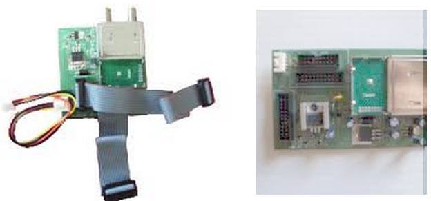

Put up a pizza dish and point it at one of the DISH HD sats and see if it scans all the channels in.If it does I'm guessin it's the turbo board.
Authentic Pansat 9200 S2 boards
Do you have the coax jumper from the first tuners LNB out to the S2 tuners LNB input?
Post a picture of the supposid S2 board. It's ID will be easy.
OR you can compare what you have to the pictures of the real Pansat S2 boards. Found both of the later pansat boards, that support blind scan, pictures at google image search. Pretty sure there's also an early version that had no blind scan.

Madmadworld. To answer your question: When i do a blind scan Tuner type is DVB-S (the letter are in BLUE) and its fixed. Meaning it wont allow me to change it on that screen (pressing the <l or l> does not change this value). I have been trying to manually enter the TP with the correct info (via lyngsat).
I tried that too. As soon as i change to 8psk or Qpsk and dvb-S2 the signal and quality go to zero. I am on SES1, and attempt to manually enter ku sat tranponder of 11505 V - 3650 - 3/4. But nothing. I am recieving other non 8psk/Qpsk signals just fine.
FATAIR: I will do so (provide a photo), but I wont have time until the week end. Thank you..
