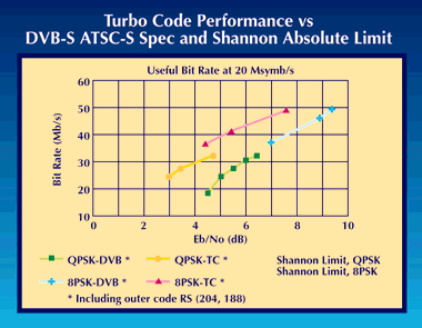

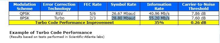

Broadcom's 8PSK turbo code FEC (foward error correction) "increases information throughput by 35 percent over QPSK. 8psk Turbo Code 2/3 FEC add's about 10% data throughput over 8psk Viterbi RS 2/3 FEC. For E*, that means going from 39.6 Msp/s to 43 Msp/s per transponder giving them 7 HD Channels @ 6.15 Msp/s each.
