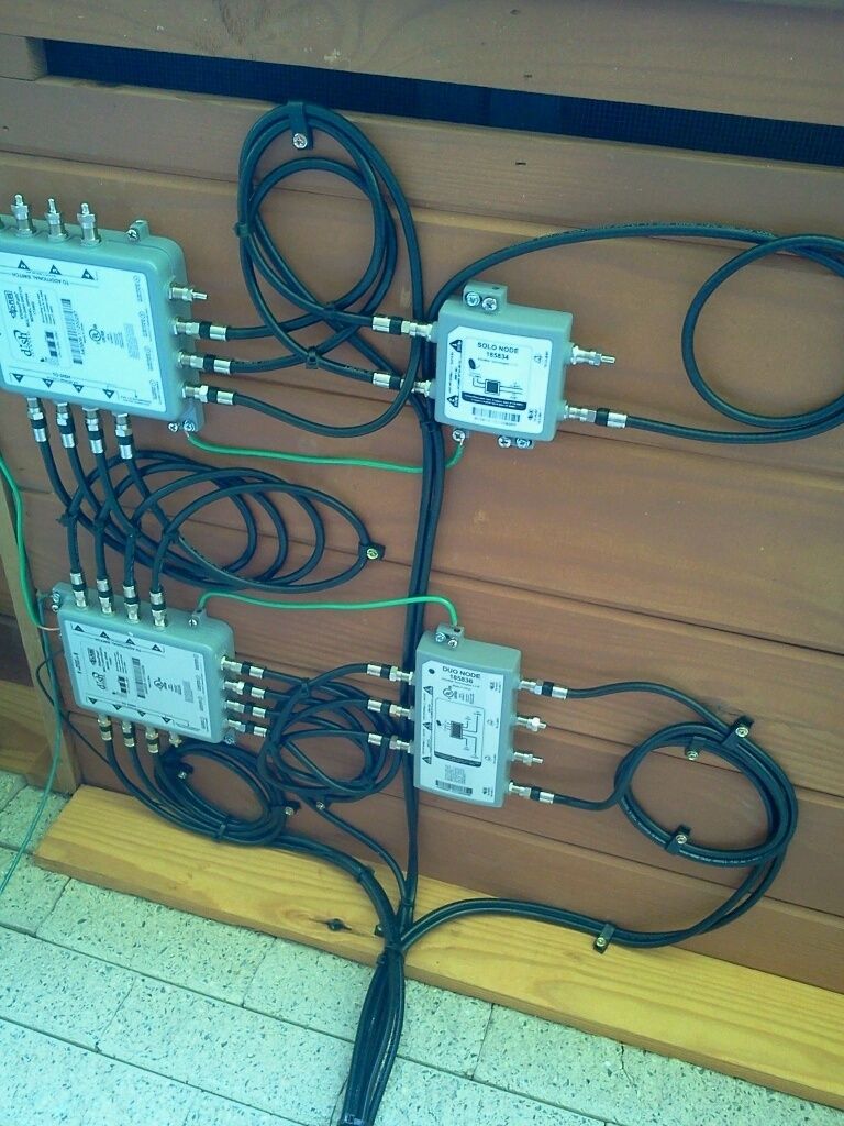

Just spent about 5 hours setting up this system it was a custom work order thru dish. i sat around debating on how i was going to do it at first debating on 2 dish solution or switches. ended up using 2 dp44 switches ran 2 lines inside for the power inserters and all the lines for the nodes off the switches and then wired the hoppers and joeys. used a solo and duo node duo ran the main rooms of the house with 2 hoppers and 4 joeys and the solo ran the office and 2 guest rooms this was what it looked like before i got the joeys wired. anyone else done a hopper system like this?
By the way, looks like you used taps for the Joeys. Did you put a jumper cable between the two nodes so that all Hoppers can see each other?

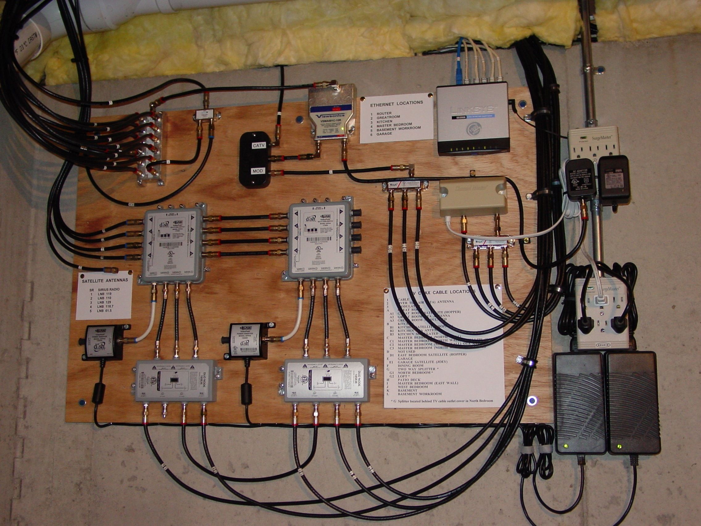

I think some of your drip loops will promote water to go the coax connectors. Here is my four Hopper with Sling, one Joey, and three RF modulators that feed bunches of TVs.

I wasn't going to say anything because the op obviously takes great pride in his work & it looks like a 1st class job other than the drip loops as you mentioned.
Hope he takes my comment as constructive criticism.

Yep, it is nice job. I met as a constructive criticism too. Sure lotsa Joeys, I think I would have gone with four Hoppers.

Where do you live at, a hotel? I lost track trying to count all the cable feeds coming down to the board. That's nice work. And the charts listing where everything is located is pretty cool.

Its all mounted to an eve under cover so no chance of rain. All the loops are just there for astetic reasons. So it would look to "code" lol I work for southern star in texarkana and ill be stopping back by there tomorrow to do the link between them. Im new at all this ive only been solo for a month and a half. And yes the wires were ran to a tap then from the tap to splitters inside the house. Thanks for the comments I tried to make it look as good as I hoped it would function. I had never heard of a hopper system this big so I was playing it by the ear as I did it lol. In my head it would work so I tried it lol. I was afraid to put the inserters thru the node and aparently for good reason.

I like the way you did your jumpers between the switches. Looks professional. And like you take pride in your work all around.

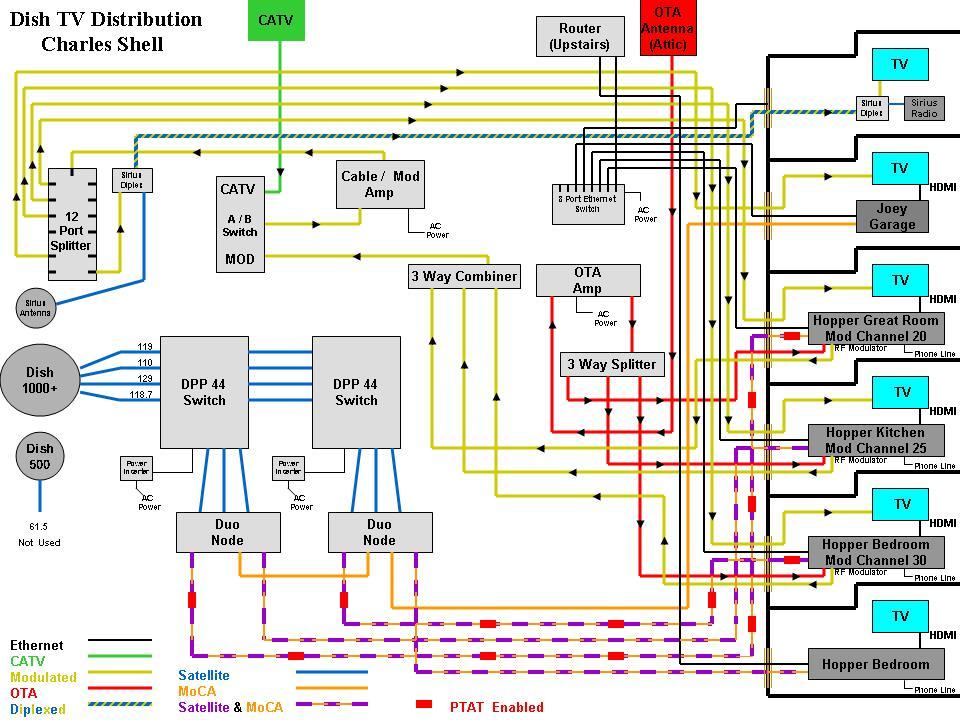

Thanks and yes I too would not want any switches outside. But, I know that is hard to accomplish in lotsa installations. Yes, it is a lot of equipment for four Hoppers and one Joey. If I need to add two or more Joeys I would have to add splitters. Dish needs bigger switches and nodes. I had to do lotsa work on my headend distribution board to change over from a four VIP 722 system to a Hopper/Joey setup so it would be ready for my installer. He told me his training for the new Hopper/Joey system did not even address how to install a three or more Hopper installation. My Dish setup is easy to troubleshoot with everything in one area and my wiring distribution diagram. See pic.

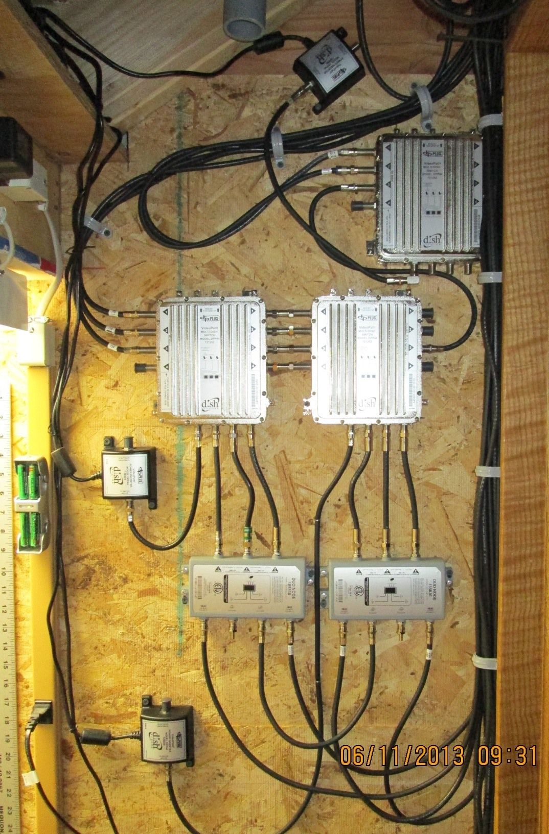

Here's my 4 Hopper setup. The extra DPP44 is for my EA dish, which hasn't been used since I got the Hoppers.
