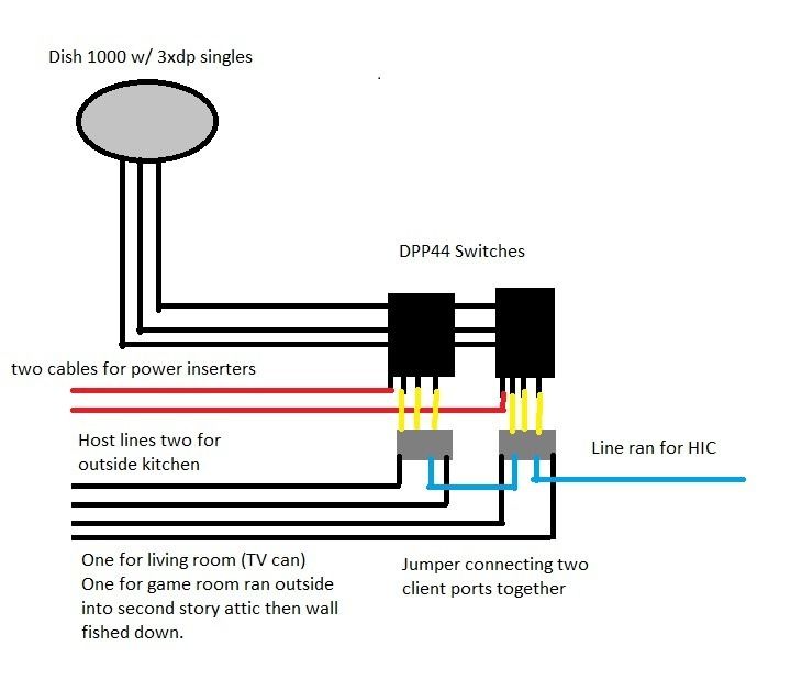

Due to my client, I wont post pics of the house but I will put up my wiring diagrams.

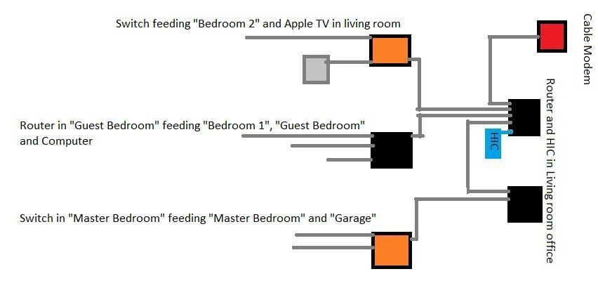

View attachment 88572View attachment 88573
I don't understand your pic? Why the HIC? Here is my system with no HIC. Cat5 to four Hoppers with Sling and one Joey.
Hey guys , I had a question Will Dish allow Just a hopper on an account, and maybe one joey. Or will they force a 722 on me since I prefer single room use for right now.
I see you ran cat5 to all of the hoppers. Instead of running cat5 and coax to each I just ran coax and installed the hic to bring the internet everywhere and back feed the joey signal.
Your joey is also connected via coax, non of the joeys had a coax ran to them... Just Cat5
