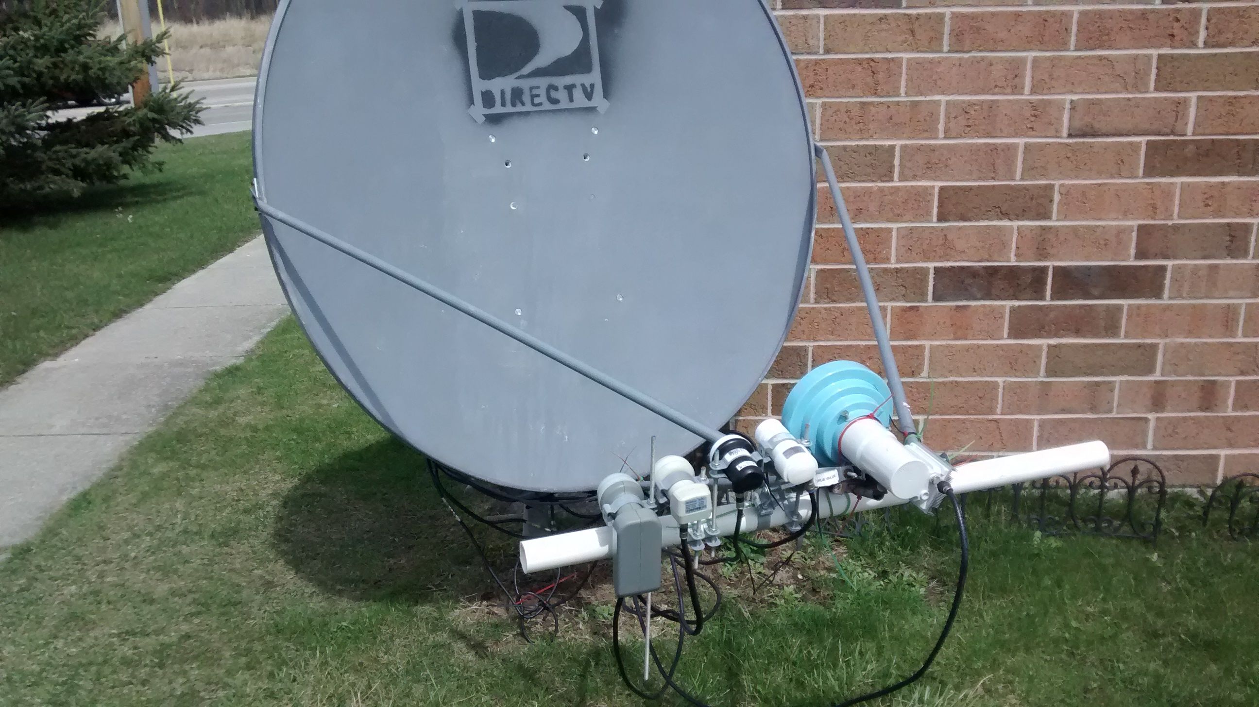

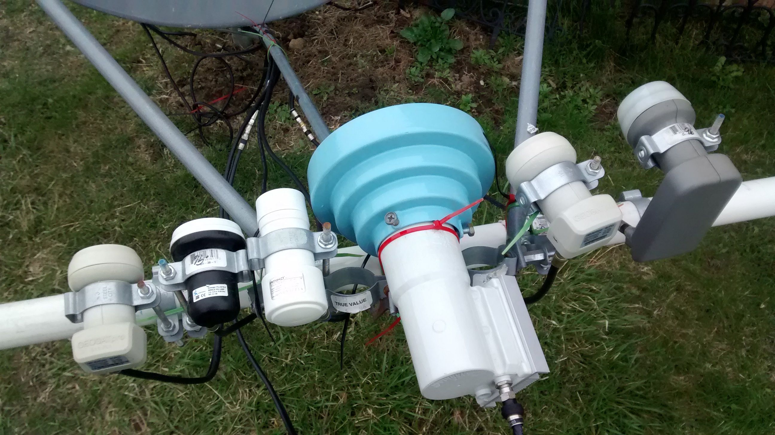

You can look at my setup I have a multi lnb setup also. I am using a 1.2 meter commercial dish.

The same holds true for working with a mult-bracket setup. I have had as many as seven but currently only sport four on my setup.
Very nice pictures of the multi-LNB bracket. That's quite a feat. How wide a separation have you gotten? Once tried to get Hispasat 30W and Telstar 15W on one dish using 30W for center LNB but no luck. Was an adventure though.
Four degree separation was typical for me on my 90. I had satellites set from 83w (when there was programming) all the way to 103w.
I have had luck with some three degree separation on a 1m dish but was using slim LNBF's on the setup.
I am on 99w 97w c band I can receive most of 99w c band. 93w ku, 91w ku, 87w ku, 103w ku. Mini budding is fun but a 10 footer is best, if you live in apartment complex from hell like I do then go with a mini bud.
