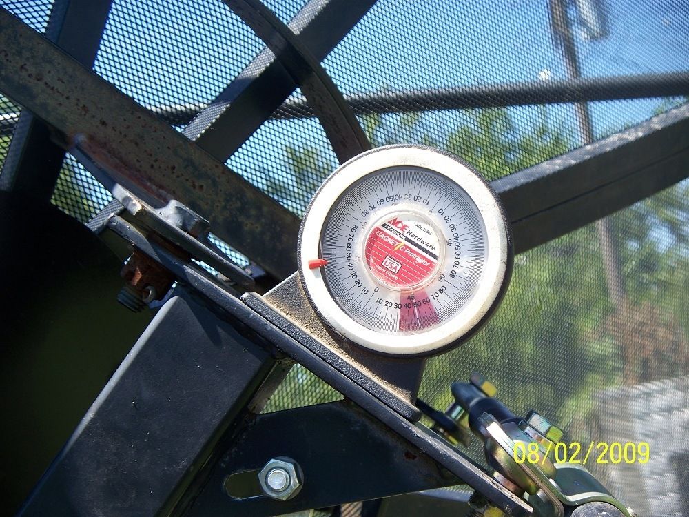

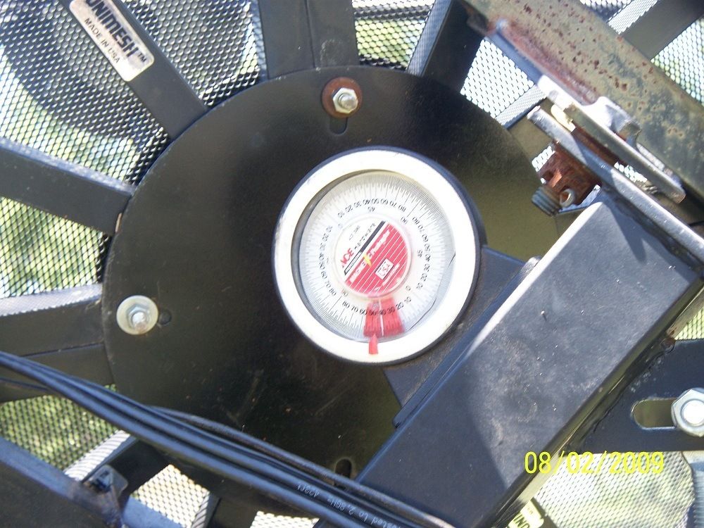

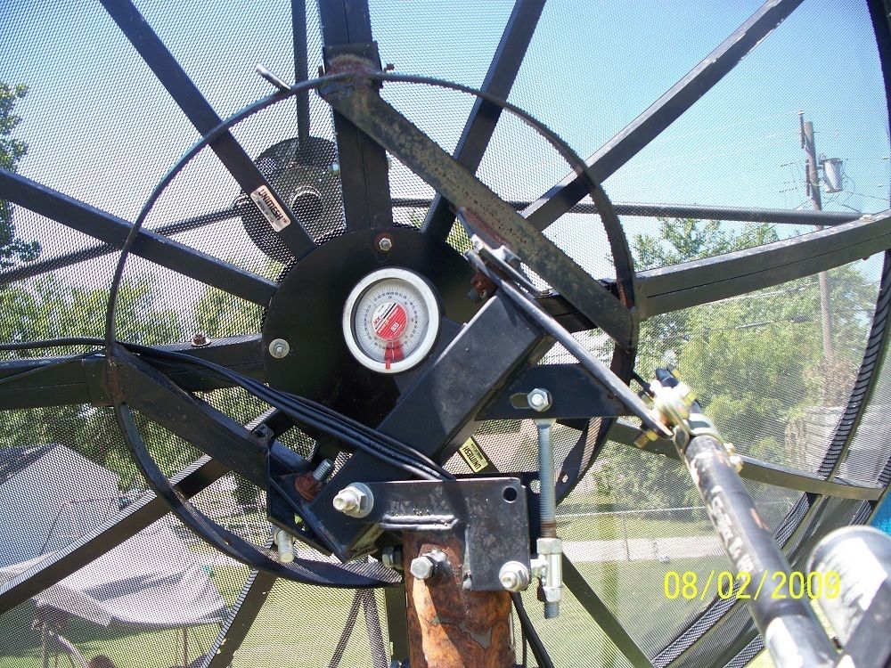

Well I still can't get anything,Like I said when I moved my dish to far west I lost green light.So I started from scratch. 1 ? I need the elevation at 47 so do I measure from pic #2 or pic #3.I have been doing so from pic 2. pic2 gives 47 and pic 3 give about 43. my south is sat 95 @ 180 on compass.
