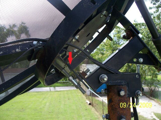

Polar Mount Bent ?

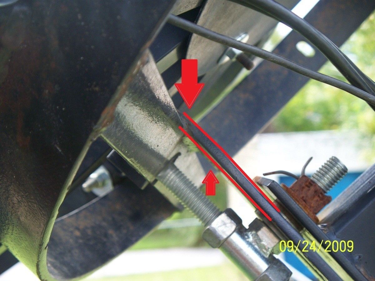

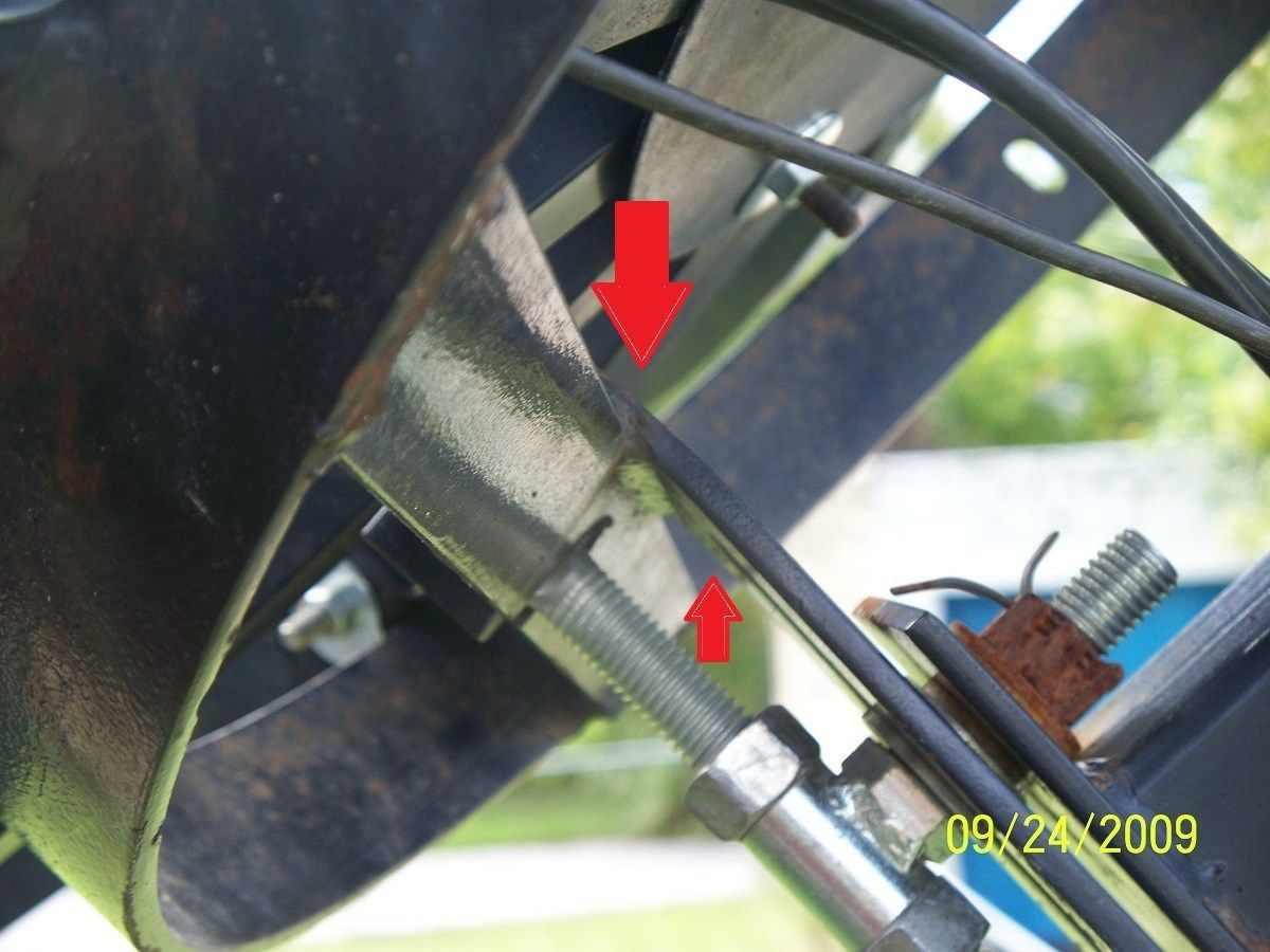

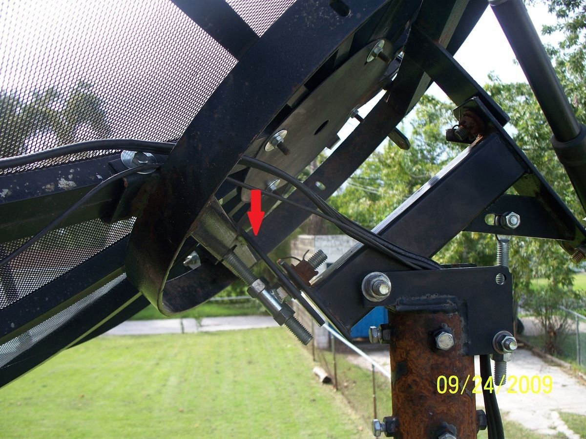

I was Looking at my dish the other day, and noticed that the bracket where the declination setting is, that bracket is not straight. My ? is, is that suppose to be straight or bent. I'll take a pic and post it. When I move the dish far west my shew is throne off I believe. Maybe that is my problem?

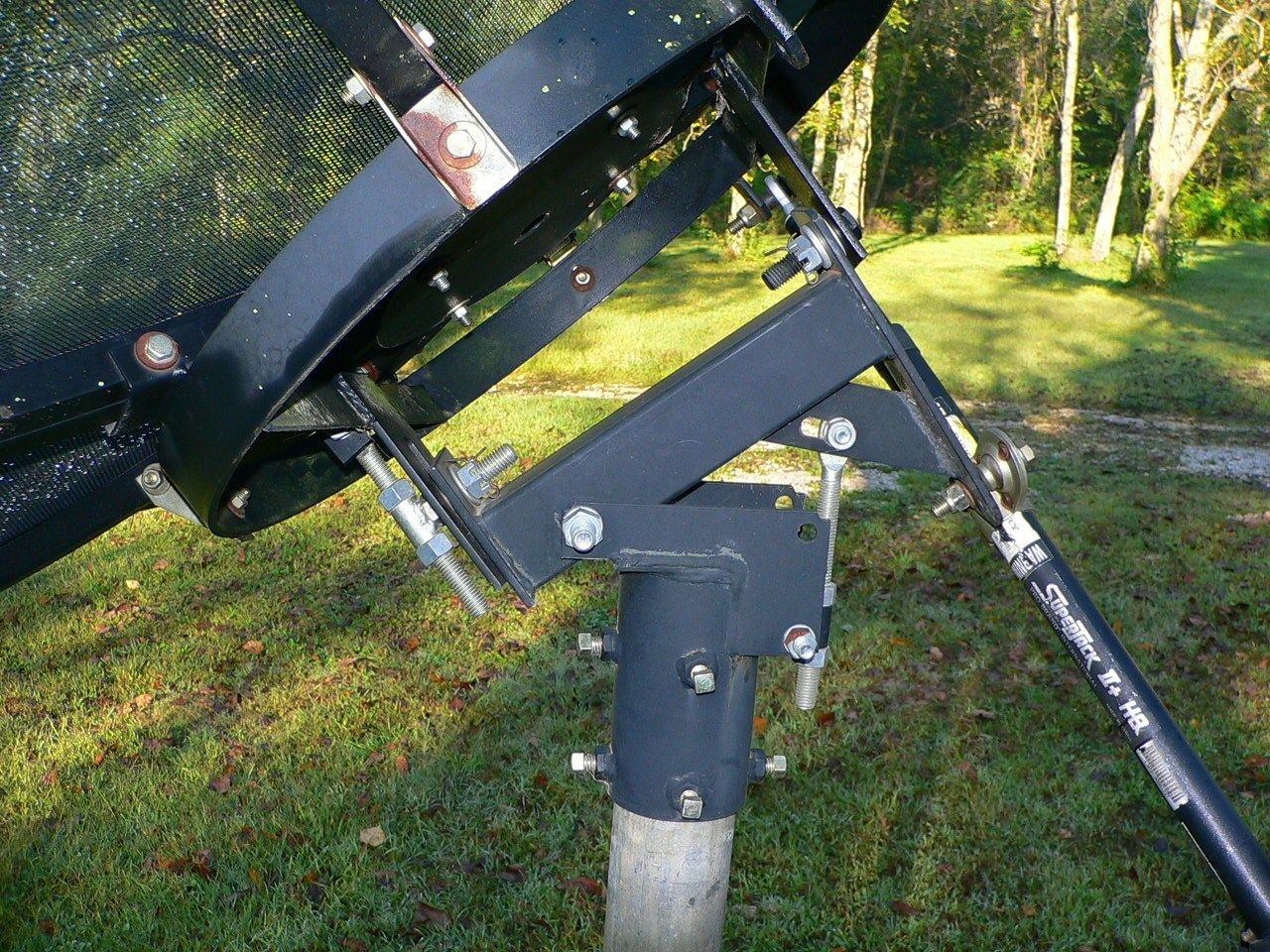

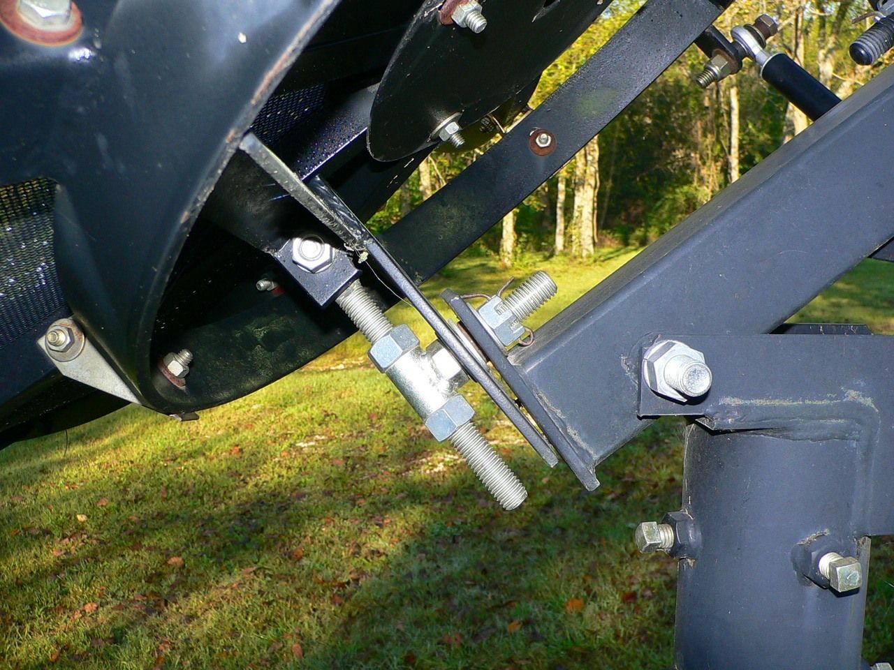

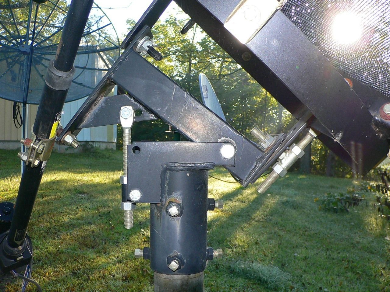

I can't tell what you are talking about in your pics, but I think I have the same mount on my 7.5' mesh so I took some pics of mine, maybe these will help you?

It's more of a bow than a bend. I used a laser pointer and followed the bow.And My laser moved up and down about 3/4 of an inch. So I don't think that would be to good !
That doesn't look like much of a bend to me but I guess it could affect it.
Are you sure the rest of your dish setup/alignment is correct?
Have you tried pulling up/down out at the ends of the arc where you are having problems?
If your declination is slightly off (caused either by the "bowed" piece or incorrect setting) that should show you something.
