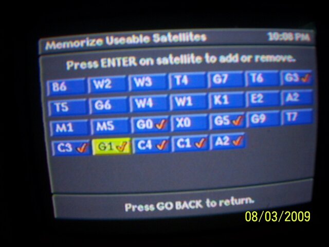

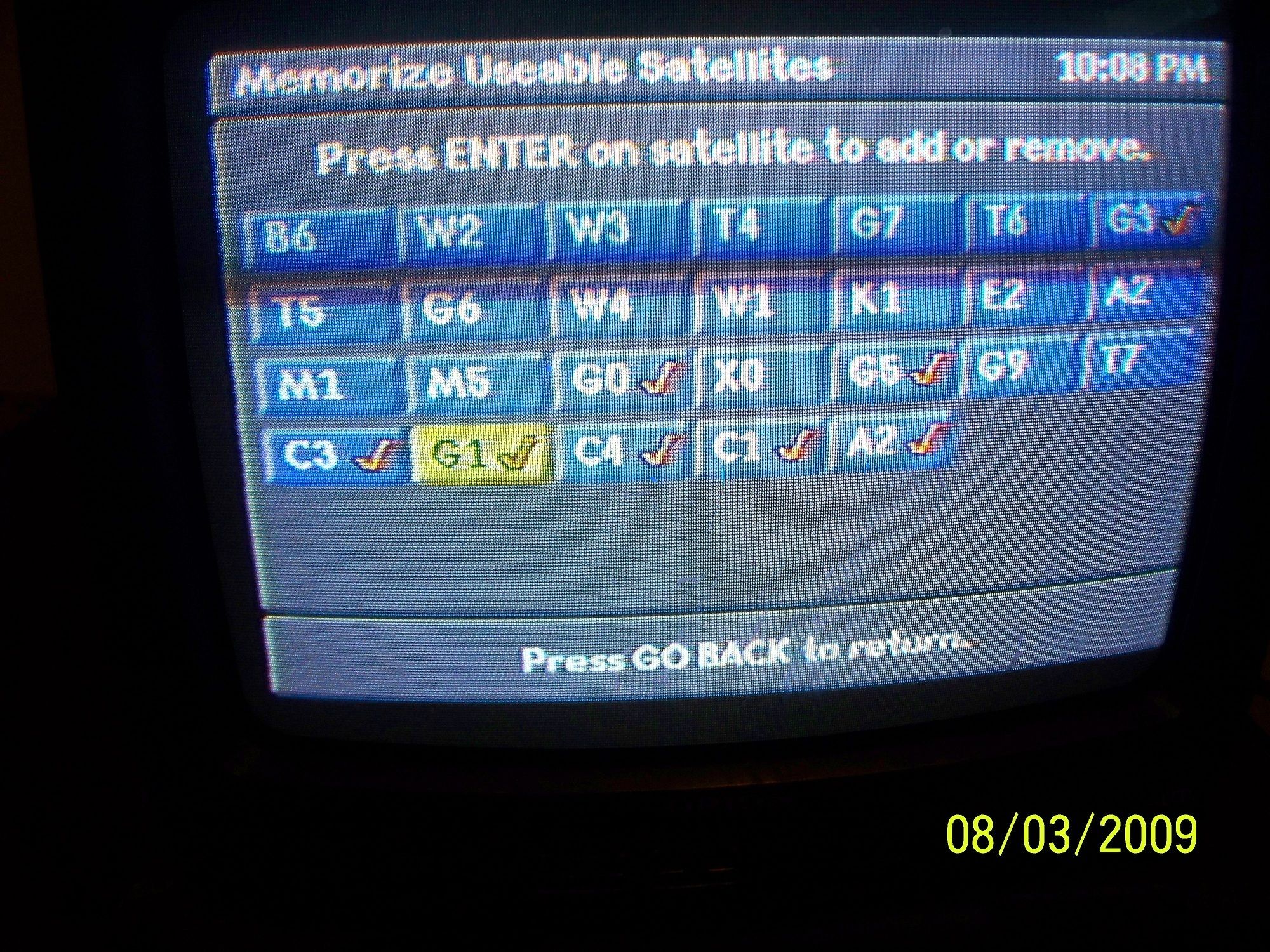

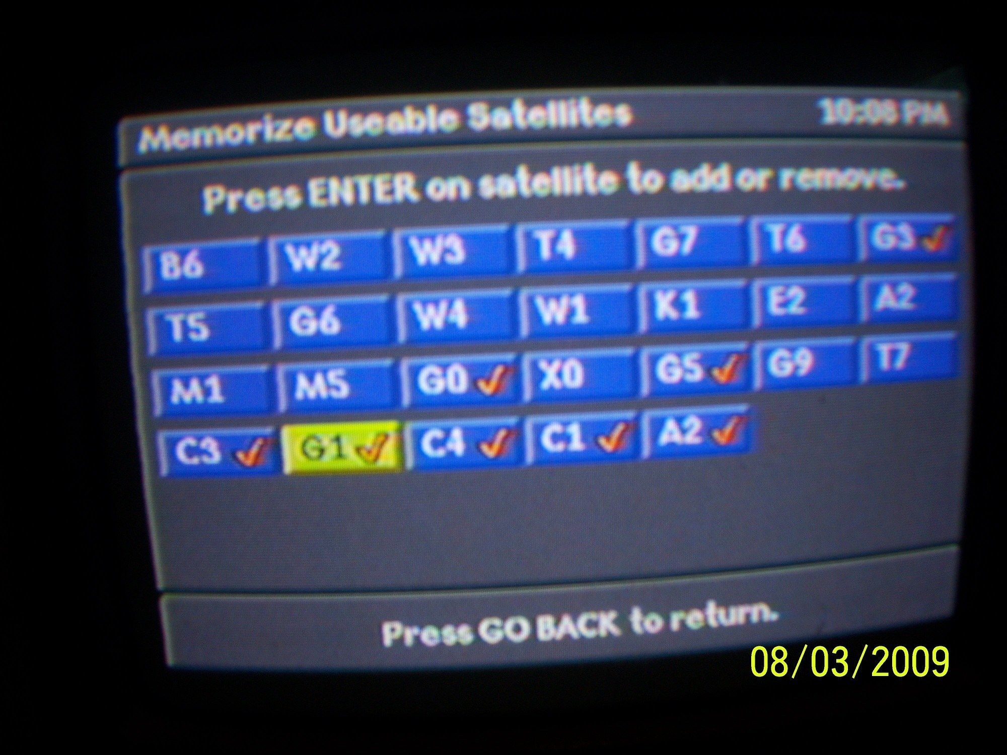

well for fun I did a master rest of my 905 (I dont sub to anything so no loss)
came back up had no sats listed
-option 6-3-4 and checked G1
-also changed my LNB setups to correctly
-backed out and selected G1 channel 0
-then did the manual tune that I posted above.....this was at 6:10 CDT
so we'll see how long before the maps come in
by the way....I had a bunch of old maps in there after the reset

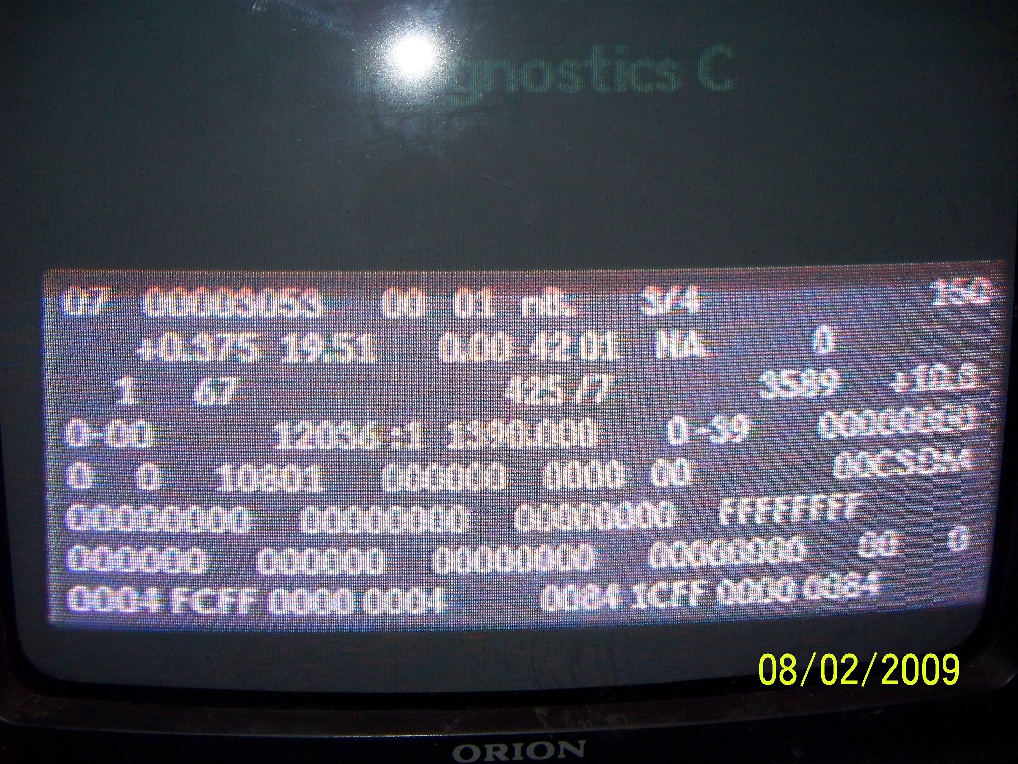

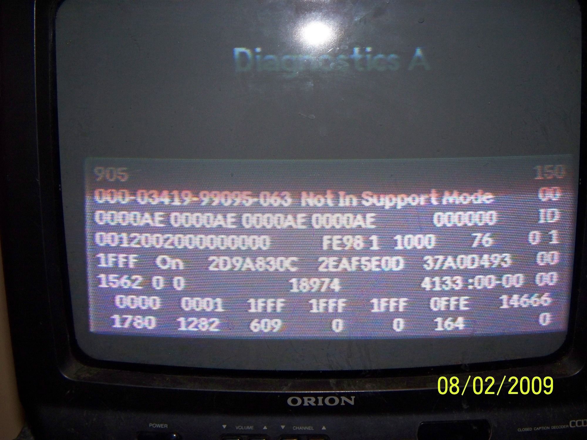

Hey anybody see a problem with my Unit ID in the pics, or does it look good. It's starting to look like I my need a new 905? I looked inside the box, but don't see anything wrong but when I killed the wife"s dazzle I did smell something.

In the Diagnostics G screen I see TDT above that is 882.After Master Reset that number was 698, Those #'s are channels that are mapped in,right? If so does my numbers look right? I have Not seen it go past 882, and I've M.R. the box 4 times in the past two days.
On my subbed 905, the TDT is ridiculously high then. I think it's 4800 something and works fine. One thing about a MR on a 905, it clears the monthly sub authorization if done, which a 922 doesn't.
