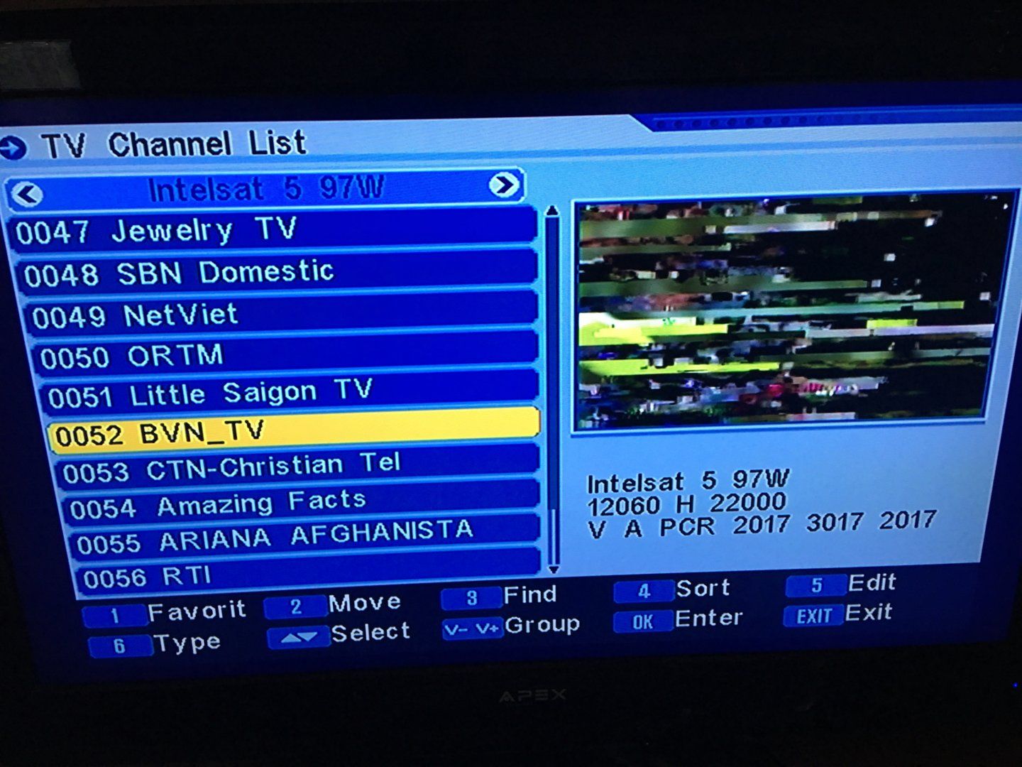

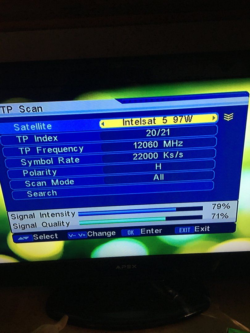

Trying to understand why I can't get clear picture. Signal quality = 70/71. Geosatpro 90 cm dish on a tripod on ground. Old traxis dbs3500 receiver. TP21 - freq 12060 and SR 22000 - Horizontal.
Any thoughts?

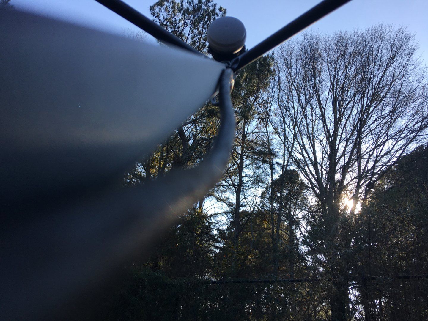

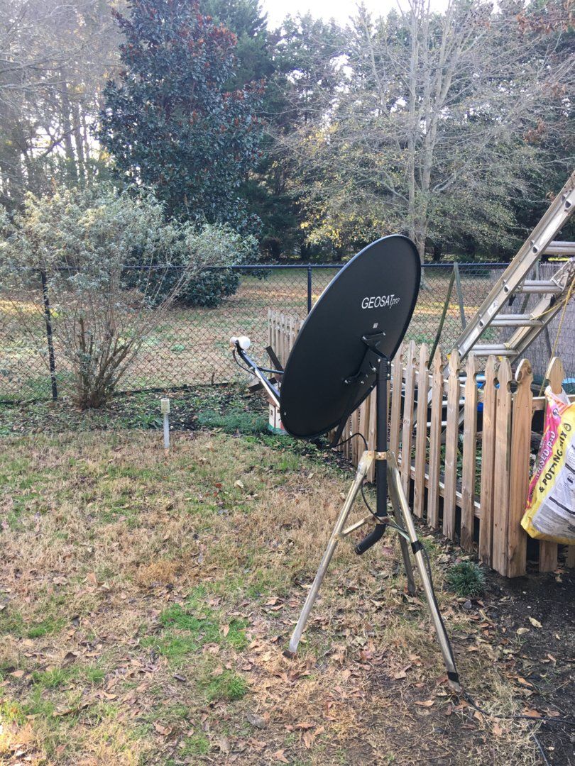

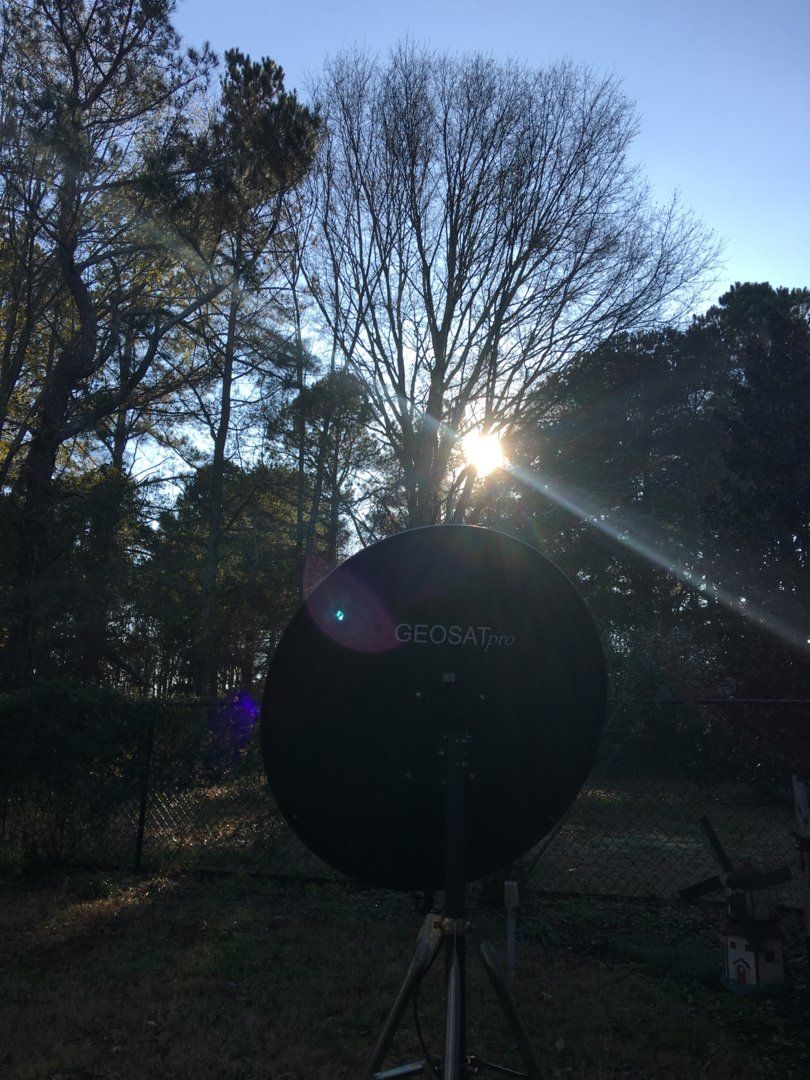

From my location in Bethlehem, Ga I can't seem to locate a spot on my property that does not have these massive trees in the background. Currently the dish is approx. 50 - 60 ft from the tree line.
What can I do?
Roof mount instead?

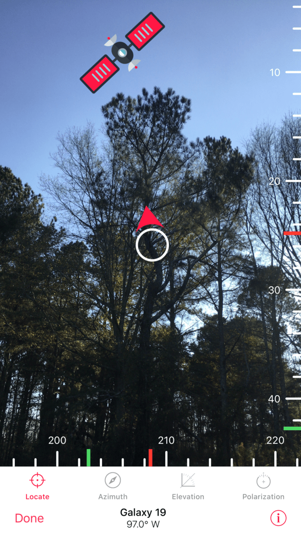

it is a new setup - new dish. Single lnb standard that came with the dish so I do not there is any lnb issue or drift. Traxis receiver is used/old one I used 7+ years ago with a different dish. I have never tried to get this satellite previously.
Thinking it is a line of site issue. Trees!!!!!
So where do I go on my property to get that clear line of site?

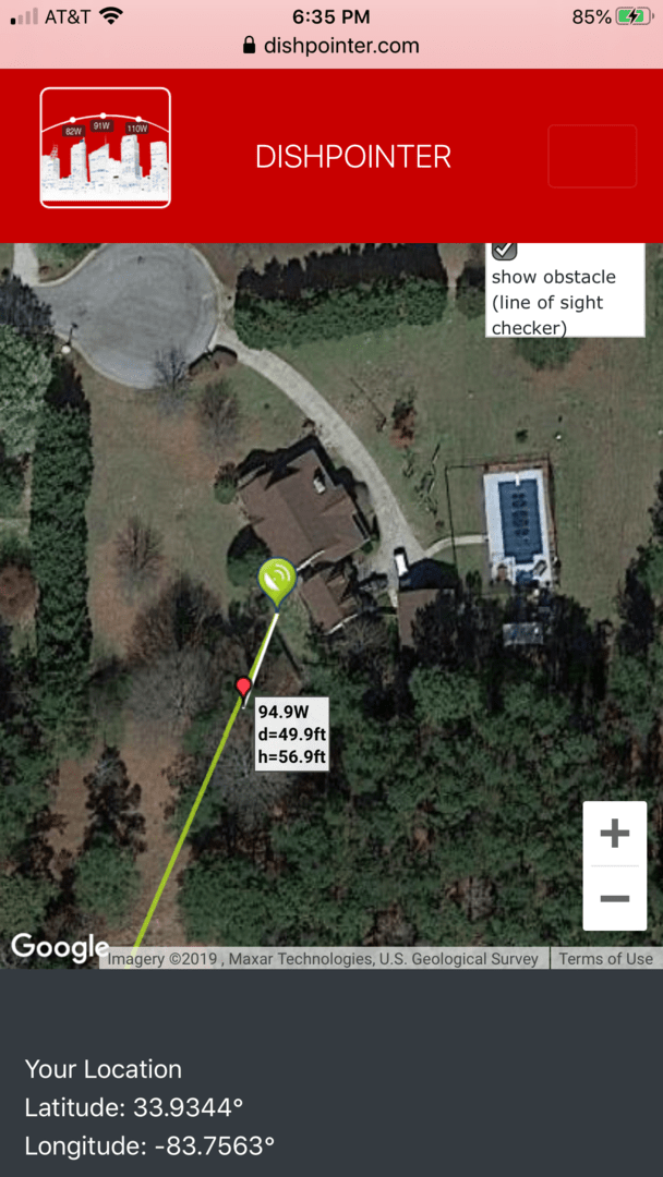

I think the trees have your number. But I would check at dishpointer.com and use the Line of Sight map tool. It helped me know the closest I could place my dish to the house without blocking signals to my west.
what do you mean the closest you could place it to your house without blocking signals? I am 5-6 ft from my house. Could it be causing interference?
Reactions: spongella
See where it says "H=56.9ft"? That means if the TREE is any higher than 56.9ft, you will NOT clear it to get sat signal.
IF you know the approximate height of the tree, IE say it's 85ft, pull back from the present dish location far enough to get ABOVE that height so it can "see" the satellite clearly in orbit.
Conversely, putting the dish on your roof (or tall pole) ADDS the height from the ground to the dish for clearance of the tree. Say tree is 85ft, and your dish on the roof is at 20ft height. That means 56.9 + 20 = it can now clear a tree the height of 76.9 ft... Still not high enough for the theoretical 85ft tree, but now you have the idea of how far you have to move the dish on your property to get clear line of sight.

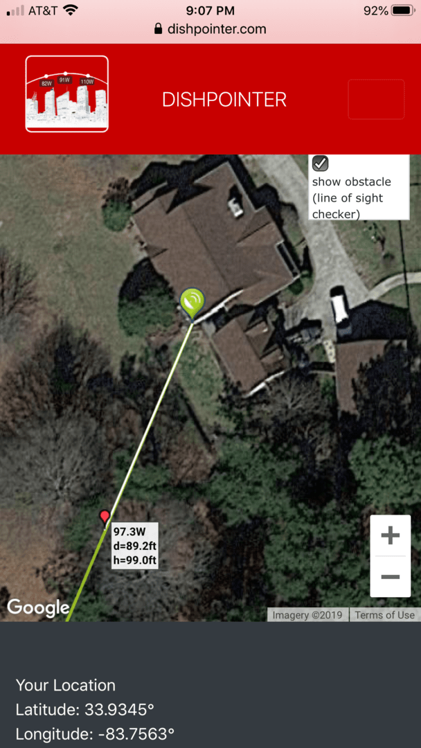

Skew is set correctly at 18.8 and the tripod is plumb at the moment! I do hear you on it not being the permanent structure. I have an old dish network mount on the roof to the rear of where the tripod and dish are currently. My best guess just now in the dark is I could get the dish 12 ft higher if I mounted it there and relocated 97 W. Maybe it would be enough to clear the tree/s.
I think I am dealing with 90 ft tree obstacle.
(90-12 ft higher dish = 78 - seems like it would work based on below line of site)

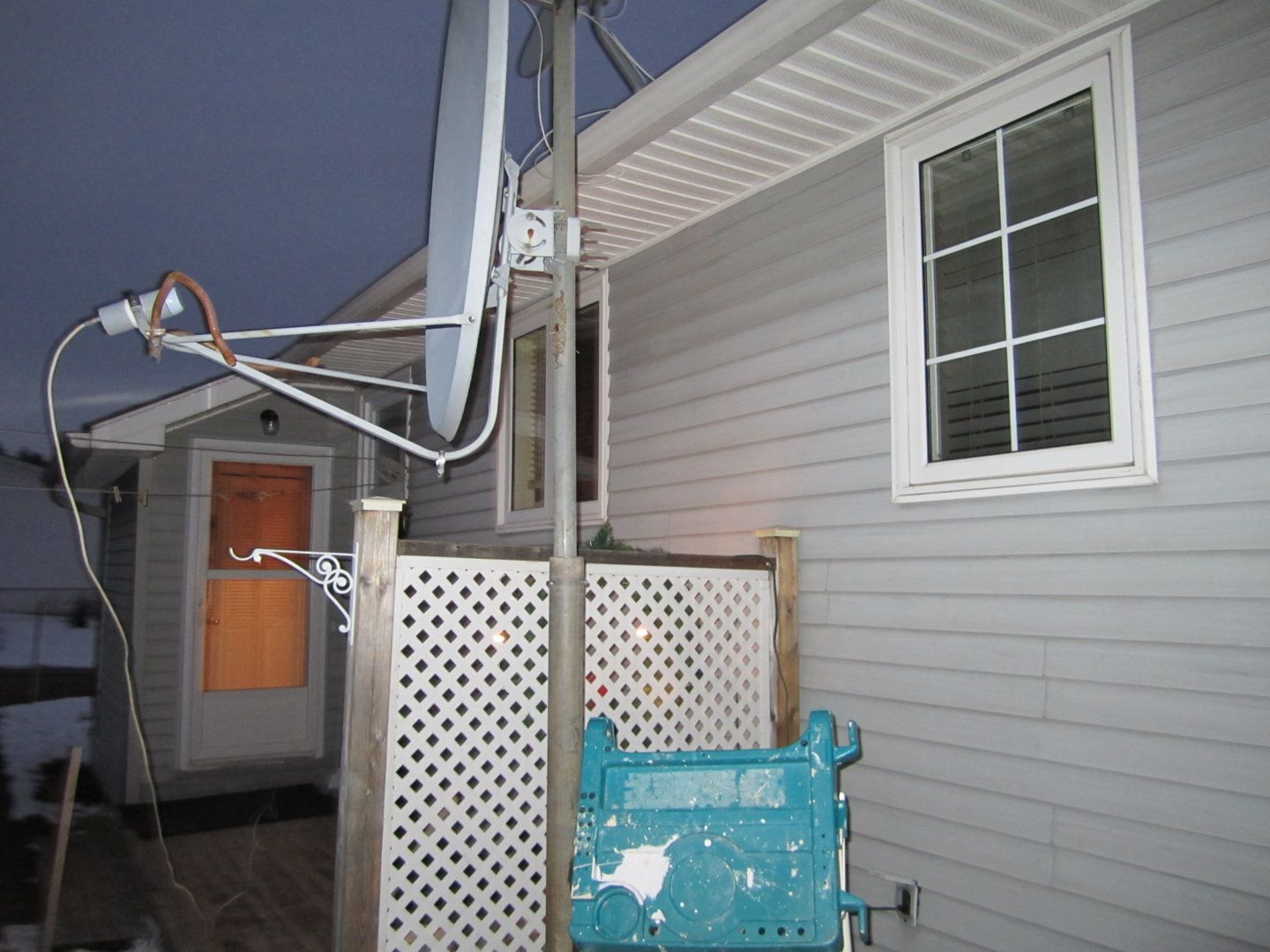

I've had three different dishes on my roof, but no more!! Put up a pole four years ago.IMG_0073.JPG
