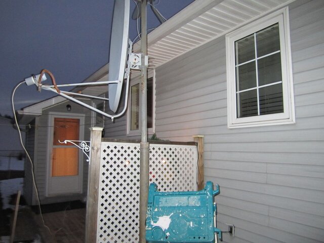

I've had three different dishes on my roof, but no more!! Put up a pole four years ago.IMG_0073.JPG

I've had three different dishes on my roof, but no more!! Put up a pole four years ago.View attachment 142306
