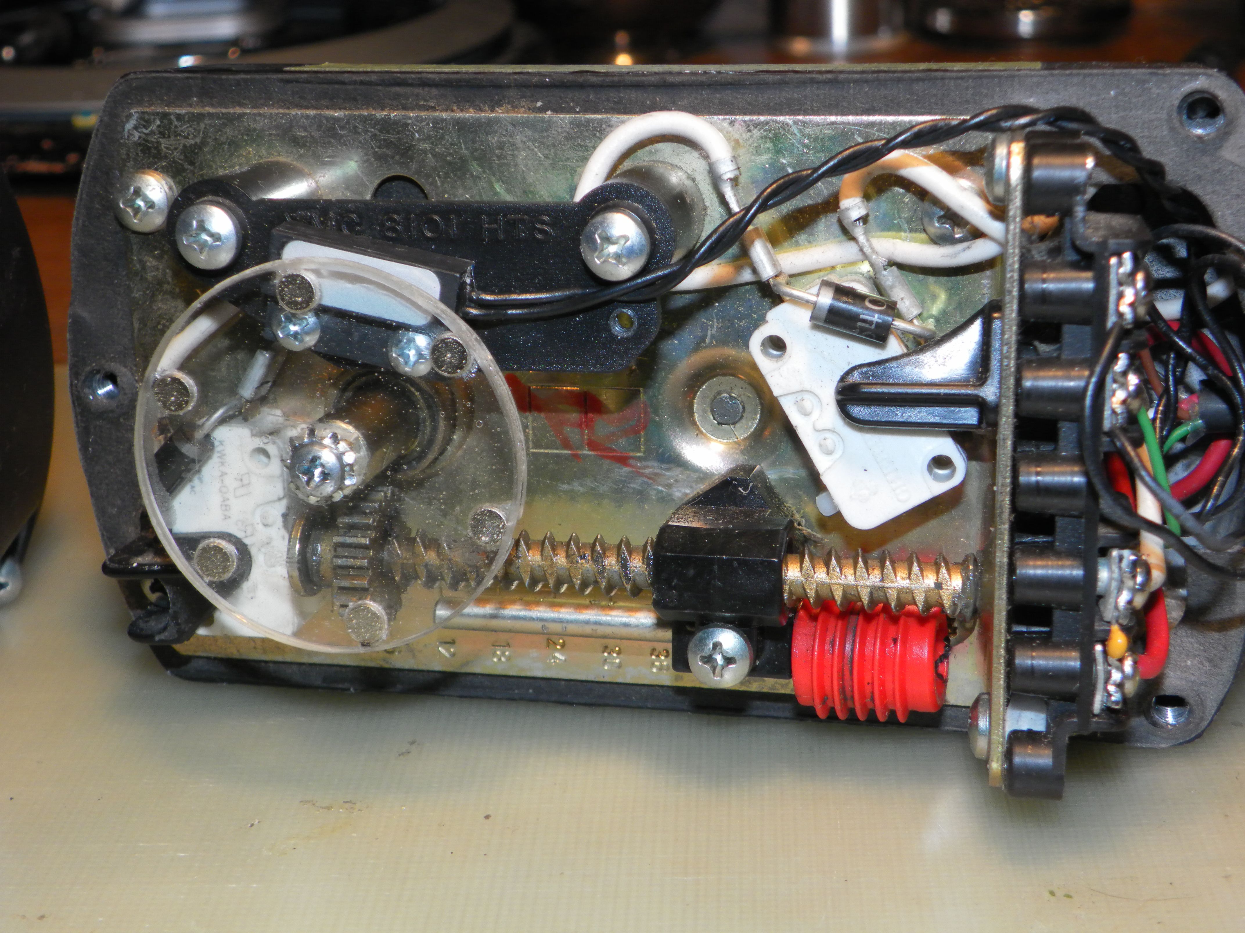

Found a picture of the desk motor with the other switch and a visible magnet wheel :)

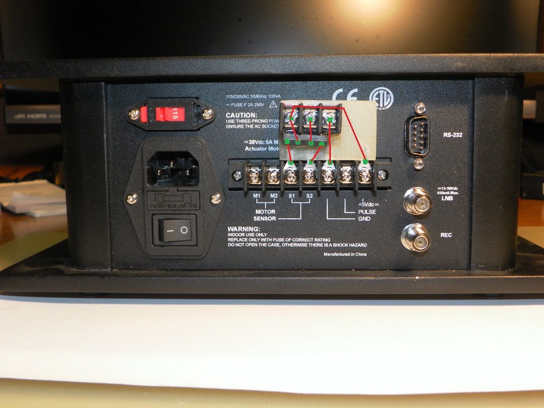

Sometimes I suffer Dyslexia it seems. Especially when working with mirror images. It has occurred to me the picture I posted in post# 16 is just wrong. It should be this.
