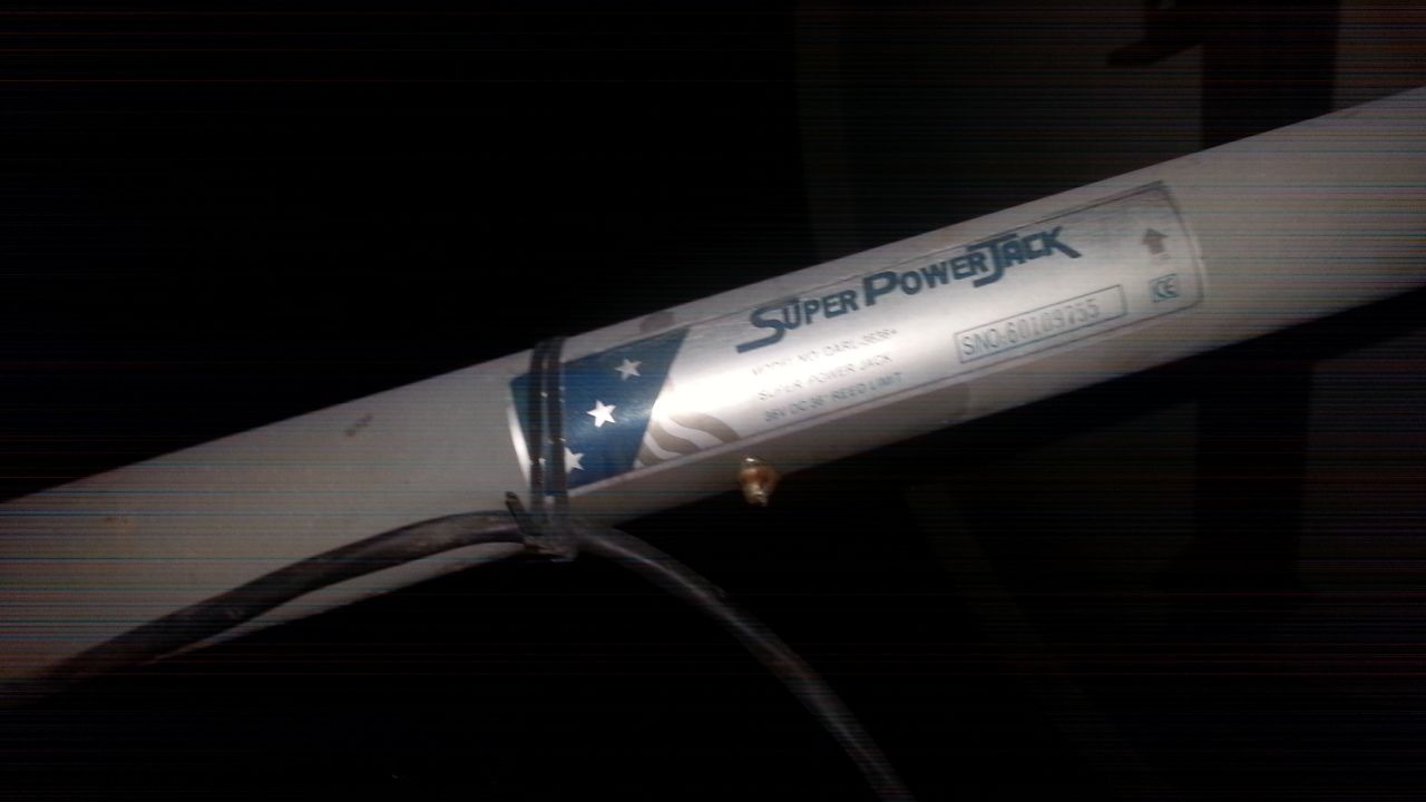

I did a bit of a detailed write up on what I found with a Super Jack that had given me nothing but troubles.
If the actuator arm needs lubed it surely isn't much of a job to carefully drill a hole in it and screw in a Zerk.
Motor slop is another thing. If the gears are toast or the coupling is worn where the motor meets the actuator, that's a good place to look at for your positioning error. More on that if you really want.

Dude. That's just geartrain whine. A good clean out and greasing up with some low temp synthetic grease will quiet it right down.
And what the other guy said about extending the actuator shaft and wiping on a coat of grease. Nah. Drill it for a zerk.

Saginaw, name your actuator...ball screw...acme...they all need greased.
Since you're not doing anything at all to remedy the problem short of tossing the whole schlamiel out in the dumpster, try the zerk and pump some fresh grease in it. You may even be a little surprised to see how much rust and crap pumps out.
For the motor. What you clearly recorded is gear noise in the motor. Don't want to, or lack the skills to do it. Get yourself a can of white lithium grease with the straw and ease the straw in the gear cavity and spray it in while someone inside punches the E-W button.
