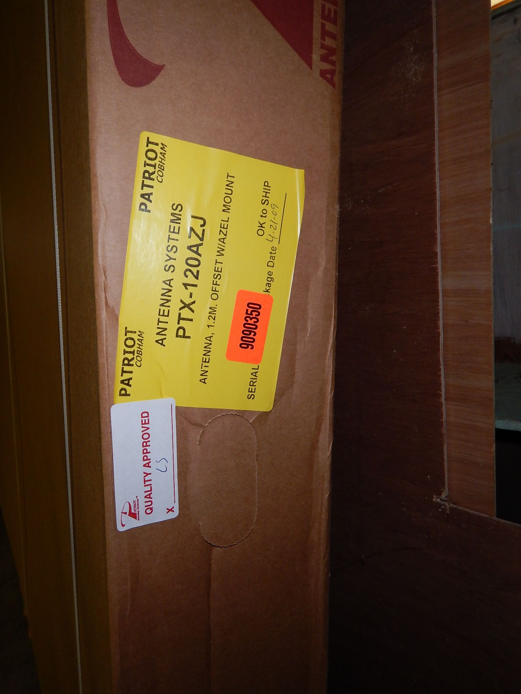

After careful consideration of everything recommended I was on the verge of ordering the 90 cm Geosat packages that included the LNBF. However, I decided to get another Patriot 1.2 m dish. The ultimate deciding factor was: 1) previous discussions with a professional satellite dish installer to go bigger; and 2) that I could purchase the larger dish and pickup locally.
