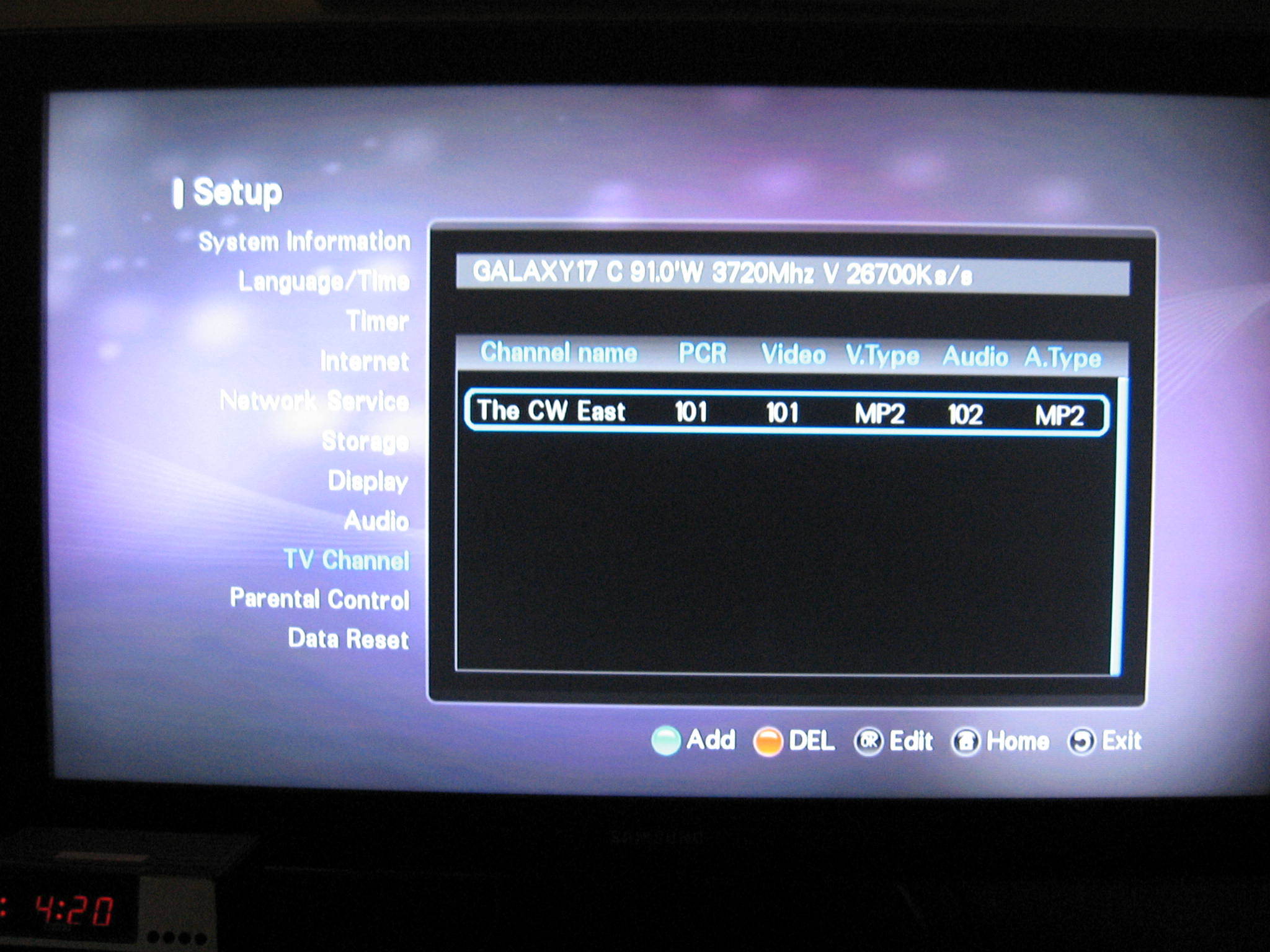

Sorry! im still missing something.When i press ok for save it goes back to what you see in the picture.How does it get added to my channel list? when i look at g17 channel list i see nothing new.
ok, according to your pic.
you have just one of the 3 channels in there, now hit the (Green) button on your remote again to add the second channel.
Then again to add the third channel.
After you have done this and saved each one like on your pic you took then hit the exit button on the remote and go back out to (TV)
Now you should either be on those channels or the receiver may revert back to channel #1 on your list, just go to the last channel on your list and it will be the ones you just entered here.

Thanks stargaze! I only entered the pids for cw east just to check it out.I have heard that i need to enter all three channels at the same time or only the last one entered will get stored in my channel list.Got the one to show up on the list but found it strange that it took a blind scan to do it!A single tp scan seemed to fail.In the future ill add multiple pids at one time if needed.
It doesn't matter whether the channels are entered all at once or one at a time. Just make sure that the SID values are different for each channel. Duplicate SID values will wipe out an earlier entry. The manually added channels should show up in the channel list immediately after exiting setup and entering TV mode. Scanning / Rescanning is not necessary.
What he is failing to realize is that a blind scan did NOT add this channel to the receiver. This mux has never sent out the PMT and pid info so it could not be added with any blind scan feature.
I believe the op was a bit confused as with a normal scan you see the channels that are being added, however doing a manual entry it works a bit different. The channel only shows up once you back out of the setup menu area.
Once you go back to the TV mode and hit the ok button the channel will be on the list.
Thanks all! Shows how much i need to learn about scanning.Just enter the pid and if more than one channel on a tp use sid1 then 2 etc etc.Just need to back out of the menus then it should show up on the channels list.
