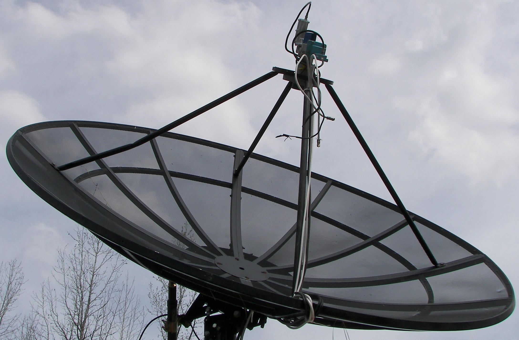

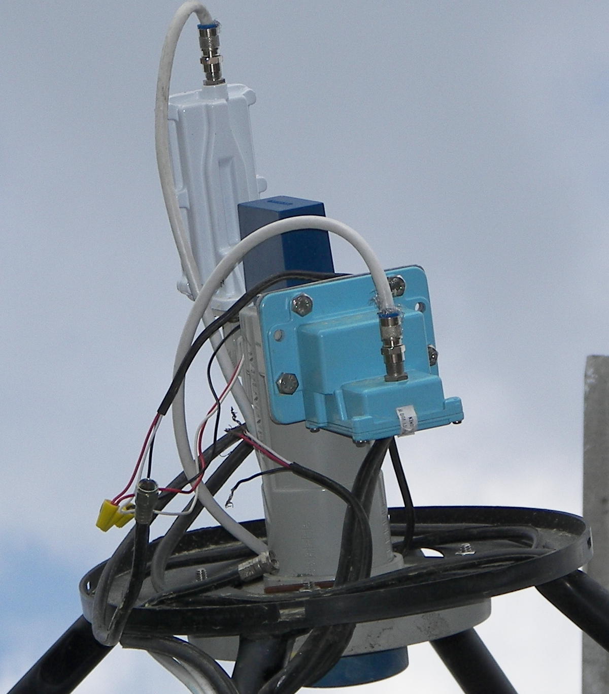

ok today got out and it was colder today so about 50ish got everything lined back up at 83%SL & 67% SQ cband of G10 and 60% SQ of 121 moved it around a bit nothing , placed it back to where i started and pulled up on feedhorn reading started going up WOW 97% SL & 97% SQ G10 C band nothing ku side so flip to ku and adjust on it some and bam 11800 on G10 @ 96% SL & 67% SQ

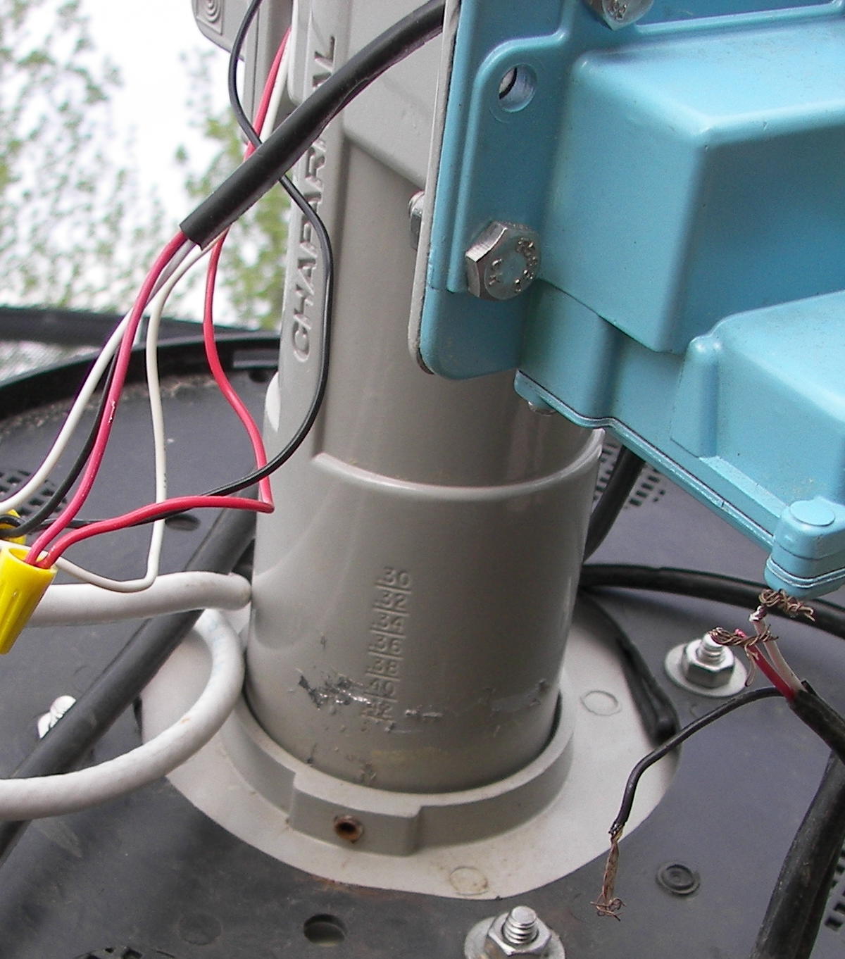

thats the best i could get it before running out of daylight lol i got several pic and you will notice my bent feedhorn bracket. the feedhorn is now adjusted almost out to the full length of the metal so its almost flush with the scaler. to adjust it back to its proper location i will need longer brackets as the scaler is at 35 inches from dish and needs to be 36 inches.
well at least its moving in a positive direction ;)
one photo is of bent bracket, one is feedhorn adjusted to 67% SQ and last photo is at 97% SQ

Hey George,
You're getting there.
Make sure that when the bent support arm is straightened that the scaler ring is parallel with the center plate of the dish, and that the scaler ring points straight at the center.
