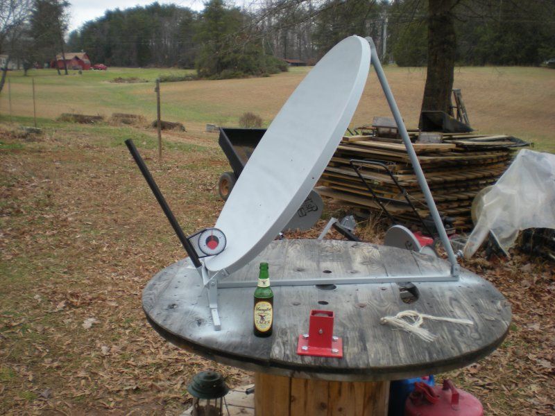

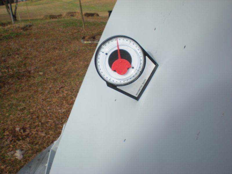

Now here is the max elevation that I can point this old dish with out any mods. Don't laugh but I wonder if I am even doing this right. lol
So the best way to explain is a picture. The angle finder points to 55...
Whaddyathink guys?

Several things going on here...
If that is an offset type dish, the elevation angle is the sum of the reflector angle plus the offset angle.
Do not place the angle finder (inclinometer) on the dish face. This is not an accurate way to measure the dish angle as the reflector is a section of a parabolic surface. The face of the reflector is most accurately measured by placing a straight edge on the dish edges, in the center of the dish aligned with vertical axis (6 o'clock / 12 o'clock).
That angle finder is measured the opposite of how you are currently reading it. If the dish is vertical (straight up/down) the reading is 90 degrees instead of 0 degrees. The actual look angle on the offset dish is likely closer to 60 degrees (90 - 55 (inverted elevation reading) = 35 (real elevation angle) + 25 (guesstimated offset angle) = 60 degrees.
BTW, those angle finders are not very accurate. They will get you in the ballpark, but the needle drop can stick and I find that they are usually a few degrees off.

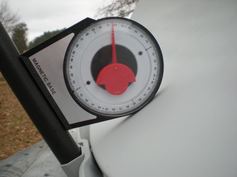

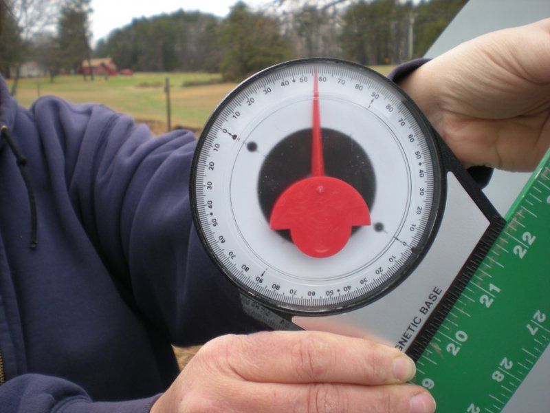

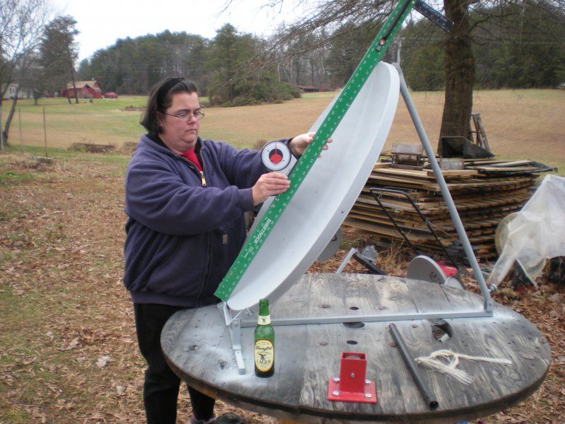

Welp since i am certainly a rookie at setting all this up. I have a couple more pictures just so I am crystal.
In picture three and four I added the measurements that Titanium said would be correct. They came out to be around 57...
Yea i know it's a piece of crap but it will serve it's purpose. If it can get me somewhere in the ballpark. I would be thrilled for the whopping $4.00 that it cost.

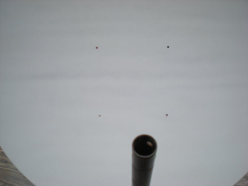

2) The secondary mounting holes that are kinda in the lower center of the dish. They are not in use and had plastic grommets plugging the 4 holes. Does this dish need those 4 holes blocked in order to receive a proper signal? I just don't know the answer to this...

Also titanium I think your saying I need to turn the angle finder. To one of the sides in order to get a proper measurements?
So, in pic 3 you are at 57 degrees. Add the 24 degree offset and you are pointing at a satellite 81 degrees in the sky?? Most offset dishes are betwen 24-26 degree offset. Pick a satellite. Take the elevation and subtract around 24 degrees using your method with the inclometer. This will get you in the ballpark

The effect of the unused mounting holes is cosmetic and will have no effect on the reception.

With the straight edge on the vertical axis of the dish, set the elevation to approximately 20 degrees tilted back from vertical, which is 70 degrees per your angle finder (90 - 70 = 20). Here is the math: Satellite elevation angle - Dish offset angle = Angle measured on the face of the dish. Slight;y tighten the securing bolt.
