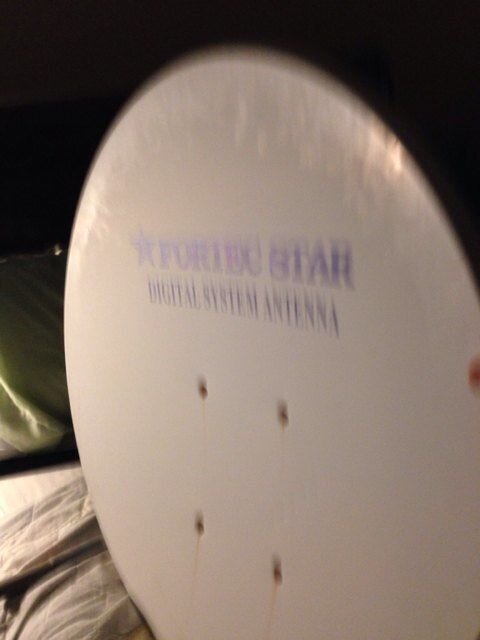

BTW - how wide is your fortec star dish

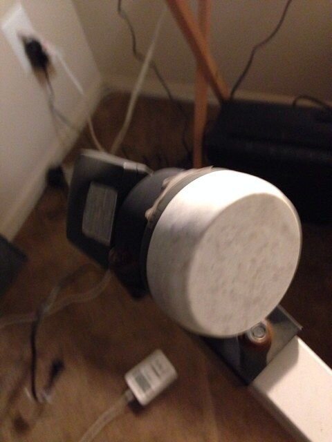

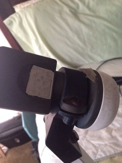

Sometimes people say "circular" and mean "universal" ... if you could take a photo of the label or write down the information from the LNBF, we can verify you have the wrong type before you spend extra money :)
ok I have to buy a different lnb and yes it's in the floor
Posted Via The SatelliteGuys Reader App!
Can you use an Avenger PLL321-2 LNBF? If you can I've got one new in the box that you can have for shipping as it was sent to me by mistake and I can't use it on a prime focus dish. PM me if you're interested.
It says in the label ku band single lnbf. I'm sorry that I bother u guys I'm so new at this lol. ImageUploadedBySatelliteGuys1384474276.996165.jpgImageUploadedBySatelliteGuys1384474290.694719.jpgImageUploadedBySatelliteGuys1384474305.056237.jpg

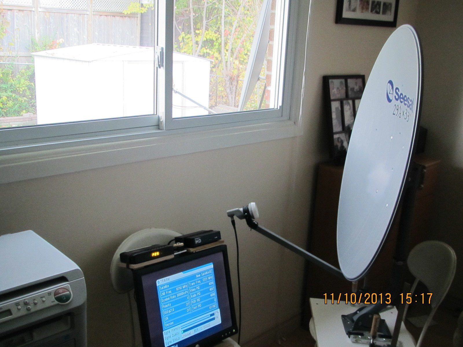

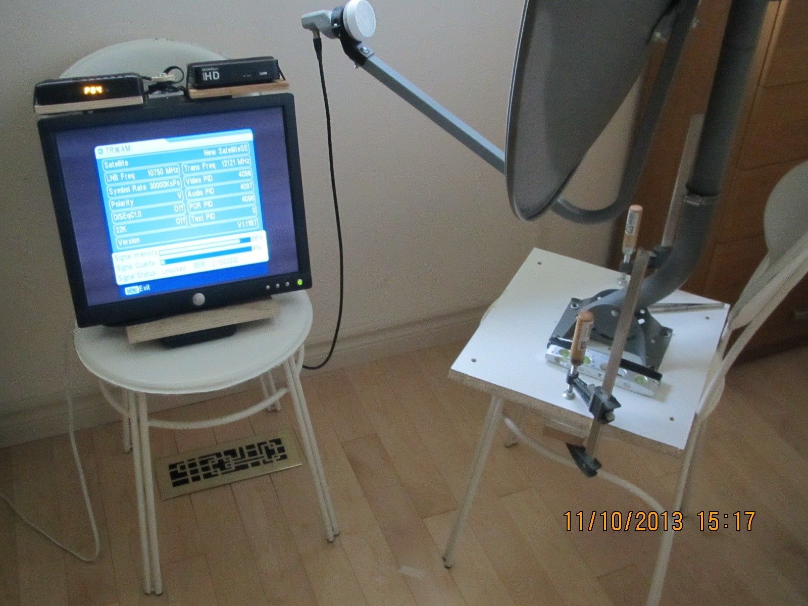

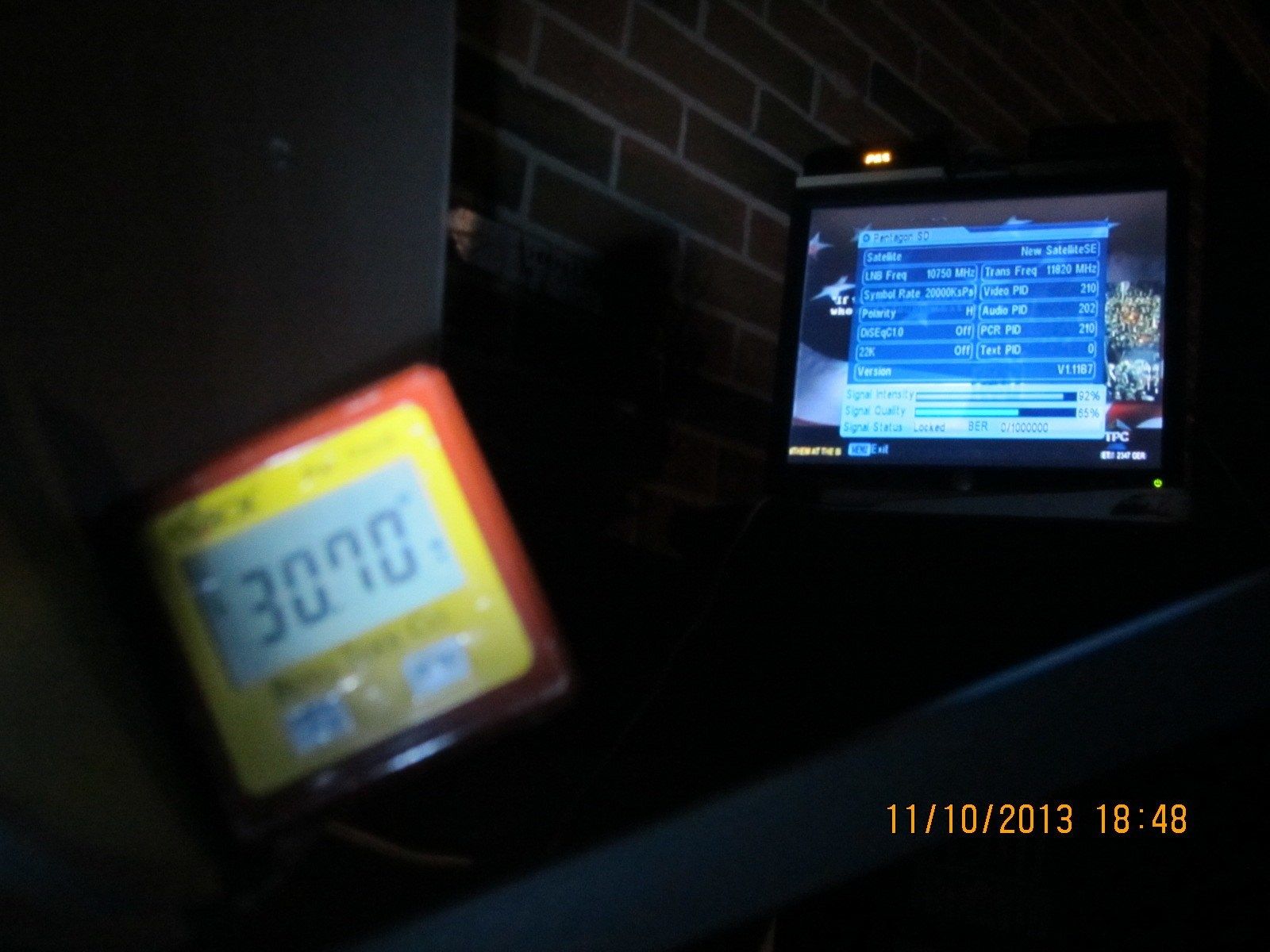

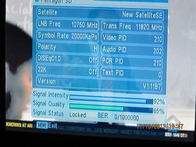

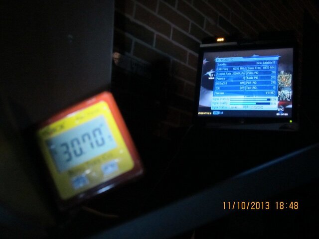

Hello, calmeidair,
I tried - without success - to receive Pentagon, with a dish behind the window, but, maybe, you will be more lucky with 97 W ? Try to catch a signal outside your apartment building, using power inverter or extension cord, with your dish on a chair, and "memorize" your dish elevation with a level or digital protractor. After you make sure that you got the reception, then, you can try to get the reception behind your window. A chair on level floor will allow you to turn your dish and find the proper distance from the window. In my trial, the "culprit" is the overhanging roof, substantially reducing the incoming signal. Will try to catch 125 W, later. Hopefully, your window is facing South ( mine is facing azimuth 255, and I need azimuth 210 for 101 W). Four pictures follow:
