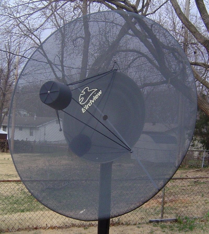

There she stood in all her glory! A full 8.5 foot Birdview dish. I couldn't believe that I had actually found one. I have read bits and pieces about them here, but thought no one around here would buy that kind of dish.

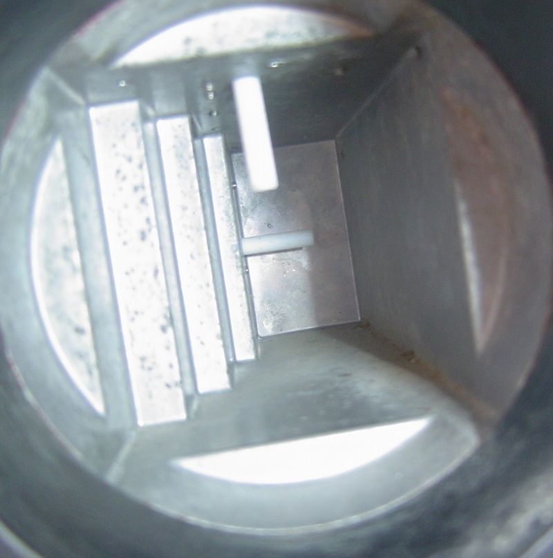

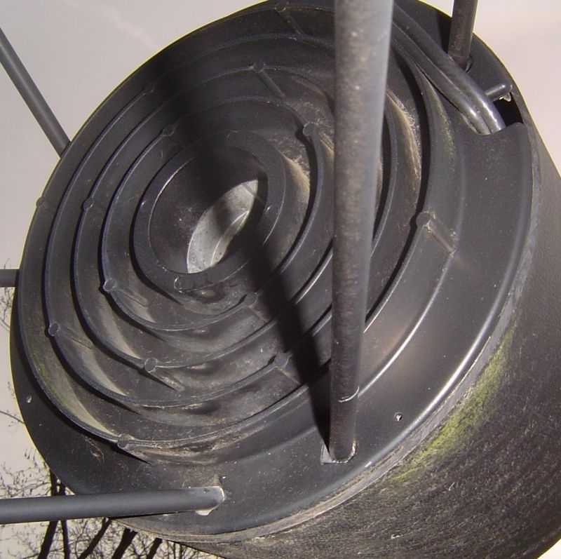

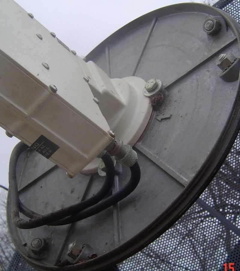

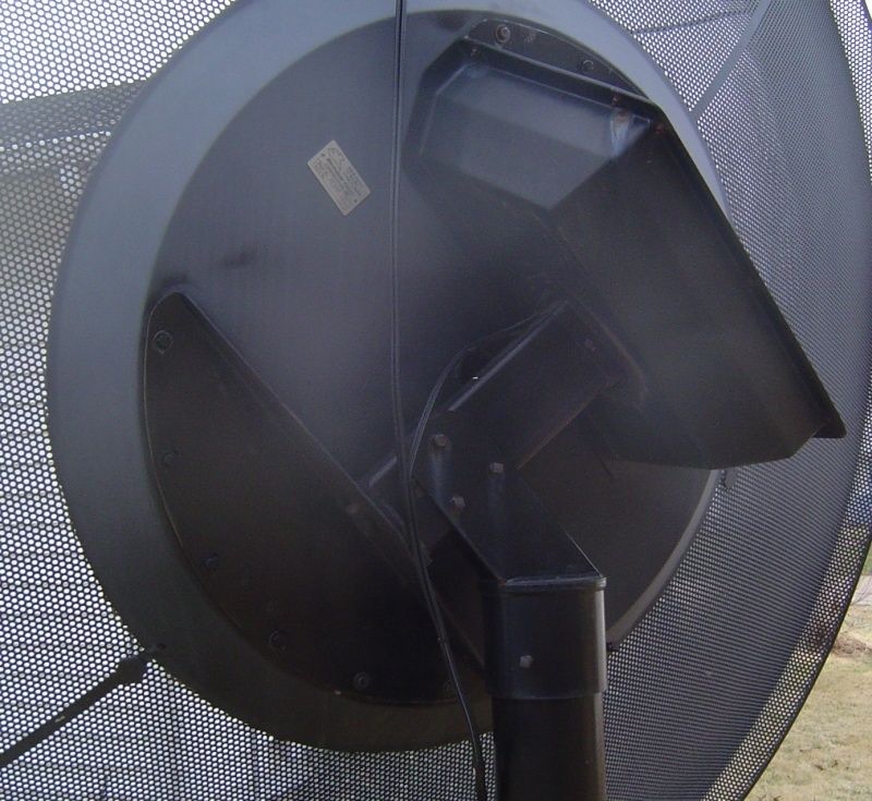

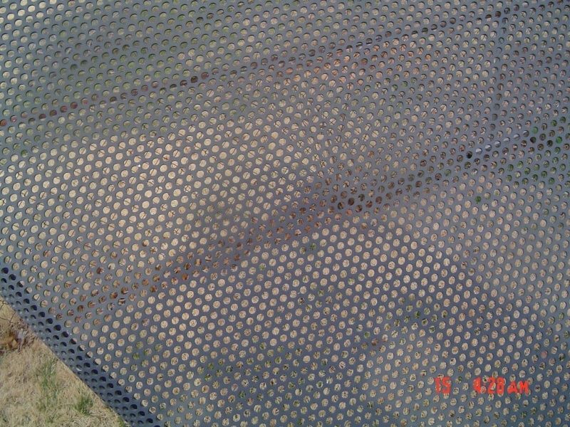

Here are the pics and then some questions.
First, will this dish pull in great Ku signal? I have read where the holes can't be bigger than a #2 pencil. These holes are almost the same size as a #2 pencil. 1/4"
Second, is this what they call a perforated aluminum dish? The aluminum is at least 1/8" thick.
Third, is the motor on the back compatible with what I think is called a reed-sensor motor?
Fourth, will it work with a VBox II?
5th, will there be less wind resistance with the size of the holes what they are?
6th, I assume the polar mount to be what is known as a true almost 180 degree H-H mount. Is that what it is?
7th, will a Co-Rotor II slide into the existing scaler rings?

You do have to purchase the birdview reed sensor from skyvision so it will be compatible with today's receivers with built-in dish movers. I wondered why they never integrated their receivers with dish movers. Humm...:confused:

It seems it will work with a VBox II if I install a reed sensor converter. :D

The thread also said it would work fine with Ku. :D
Wow, I'm excited for you! Shes a real beauty! Saw what you meant by standing in its glory, lol, wow. I'm sorry I didn't have anything useful to say, but that thing is in great condition!
