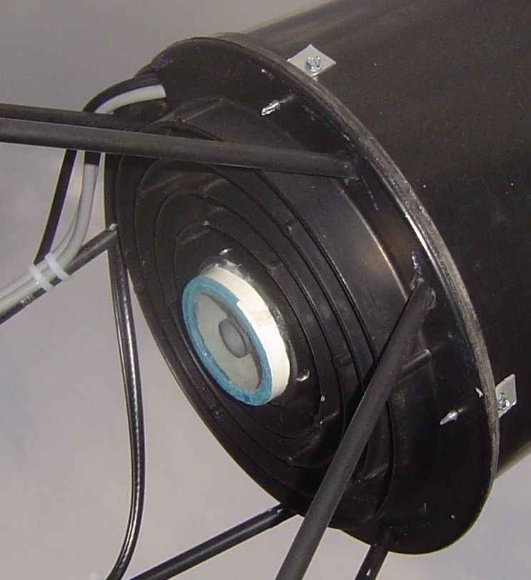

Found a temporary solution to the Feed Horn cover. I put the cover off the SAMI dish on it temporarily.
I also used a modified lens cover that I made as an experiment last fall. Siliconed it in place for now.
I wanted to get the original f/h cover off so I could find a substitute to make about the same size.

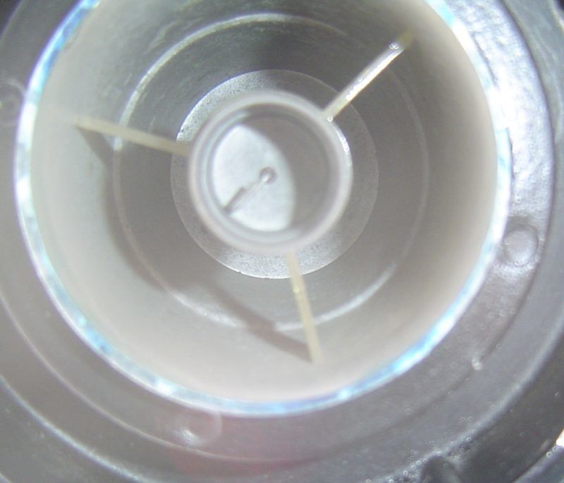

I wanted to ask a question about the co-rotor pictured below.
Is the off-white tri-part plastic piece that fits around the Ku cylinder, one of those dialectic inserts for circular C-Band?
Here's the pics of the modified parts:
From what I can see from the picture, I'd say no. It looks more like supports to keep the Ku waveguide centered.
Hey Stefan,
I think you are right. I don't think it runs deep enough into the throat to be a signal straightener. It is probably just a support arm. This co-rotor is at least 15 years old, maybe more. Got it off a dish I picked up last summer.
Hey George! You are right. I need to check Mike's stock. This one is 11.5" OD at the base. It needs to be about 2" taller than what it is.

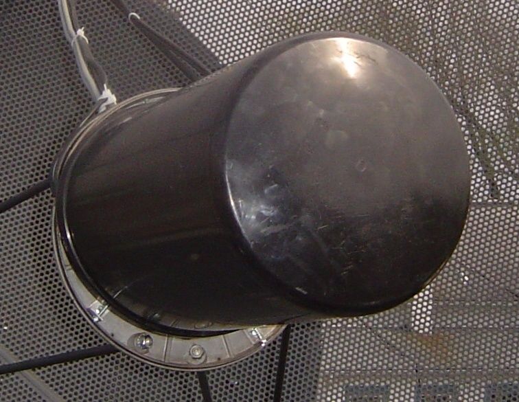

I did work in my shop and manufactured a new feed-horn weather cover. It will fit perfectly and look very much like the original except deeper. I painted it white and will decide after it is on if it needs to be black, or at least gray. The paint is drying now.

Fred:
A cap from a Countrytime Lemonade or Coolaid plastic container makes a neat lens cover for the mouth of a scaler feed. The containers are for the sweetened kinds of the mix. The lid is large enough to cover the throat and fits inside the first scaler ring with just a little trimming. Use a small drill (0.031" Dia.) or the tip of an icepick to make a few vent holes to allow some air circulation. A lense without some kind of vent will cause condensation problems inside the waveguide.
My experience with non-vented lenses dates back to my experiment days with homebrew feedhorns. Had fabricated a perimidal feed horn from copper sheetmetal and siliconed a clear lense over the end. Developed a "sparkle" problem that was intermittent. Found a tablespoonfull of condensation inside the waveguide. Always vented them after that without any problems with condensation or wasps.
A small styrofoam cup will also make a good temporary lense cover.
The Birdview feed support is an odd size. My weather cover was broken, so I fabricated one from fiberglass. Used posterboard to form the shape I wanted and glassed over it. I contoured the end of it into a bullet shape by orange peeling it into the curve I wanted. Made a good cover and the rounded end shape perked up the looks.

Hey Harold,
I'll give the lemonade lid a shot and see how it fits. The one I have on there now is working ok, but I'll have to see if it will allow me to drill some small holes in it. It is clear plastic siliconed into the rim of an old lens cap that had the center cut out.
I made my new feed-horn cover out of a new plastic 5 gallon bucket, trimmed down to 4 gallons. It is a perfect match for diameter, and about an extra 1.5" deeper than the original. I used my dremel to cut it off, and I ground off the bottom ridge and raised lettering. For all practical purposes it looks just like the original which is about a 3 gallon bucket, just deeper. I am going to pick up a can of dark gray paint later today. I decided I don't like the white. :D
