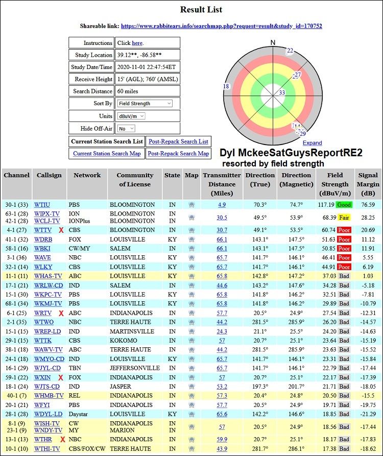

Thank you for then signal report. That would put you SW of the center of Bloomington, near Leonard Springs Nature Park.

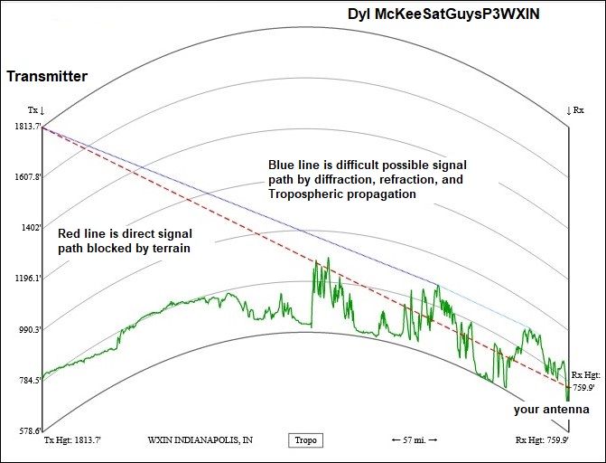

You are behind a hill for WRTV and WXIN if the report is for your actual location.

That chart is interesting, I know the farther signals are 2 edge so that makes sense. I must be in a sweet spot since the signals I get are great for the most part. I am getting 3 out 4 bar signals on all 4 channels usually. WXIN and WRTV get slight pixilation at times and go to 2 bar, the channel is mostly fully watchable but has slight break ups every so often during non clear days.

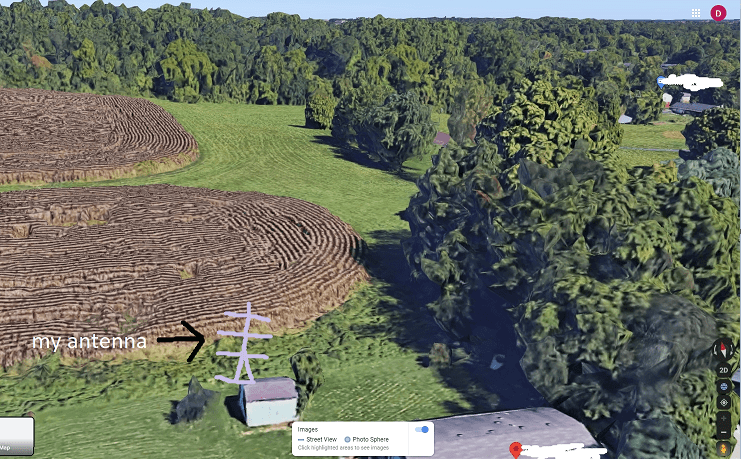

Yes the report is my exact location but not the exact location of my antenna, there's an entire row of giant trees past the field behind me so I tried to position it facing toward the least amount of trees possible. It's also weird how I get better signal pointing my antenna basically straight north instead of northeast where the towers are.

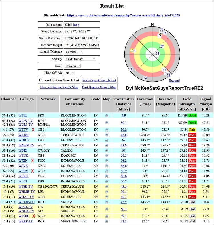

Here is a signal report of the literal exact spot where my antenna is
You can see the channels turned to "poor" instead of "bad" it says WTHR is bad but that's the most reliable station I get. It's always 3 bars with my winegard which is a great VHF antenna I was told. (I used to not get WTHR at all with a smaller antenna, now I get it zero problems, I'm only having a slight and I mean slight problem with WRTV mainly).
I find it so odd when I point my antenna directly at the towers, the reception gets worse but when I face my antenna directly north basically like 3° I get much better reception for WXIN. Maybe there's a reflection of the signal that's stronger coming from the north idk.

Thank you for the new report. That location is about a mile away from the previous report.
I find it difficult to use an address with the rabbitears.info reports, so I use coordinates from Google maps.
I was able to figure out your exact address which is a few houses away from your second report. The signals look more like your description of reception here:

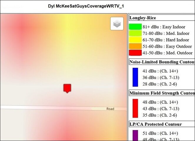

I looked at the satellite view of your location. You have trees at the NE corner of your house which block the signals from the NE. When you aim your antenna north, you are able to pick up the signals coming around the west side of the trees.
I was tempted to post a satellite view of your house, but wouldn't do it without your permission.

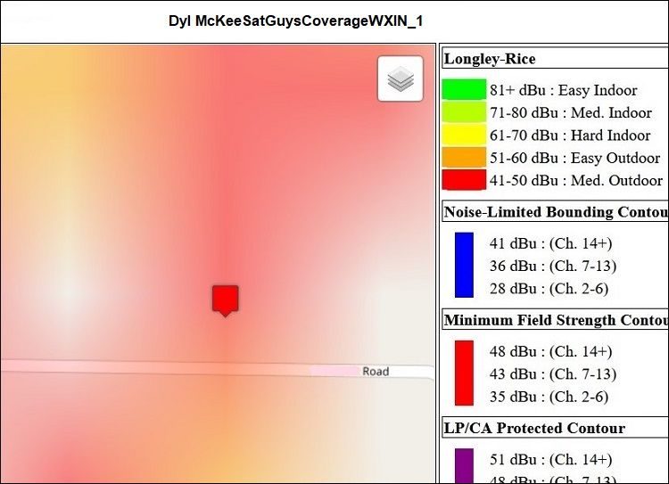

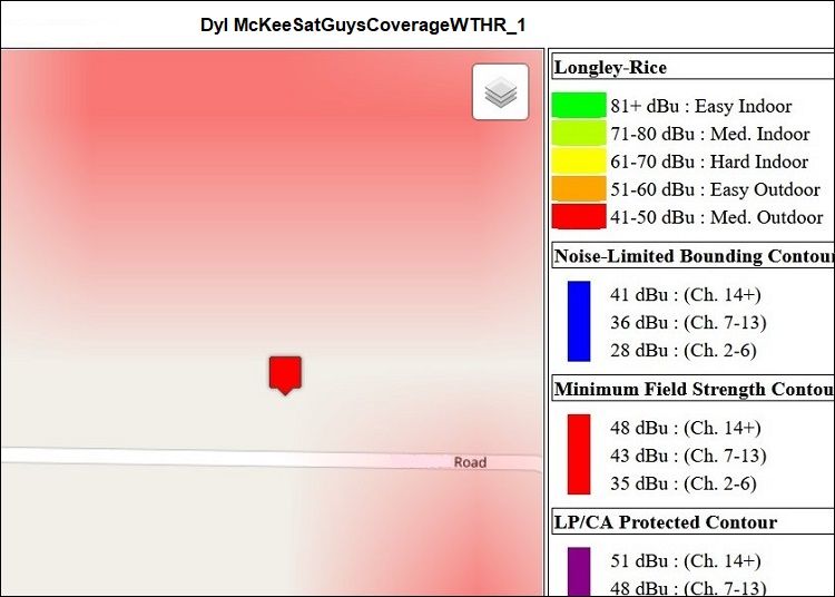

The best thing you can do for better signal at your location is get more elevation.

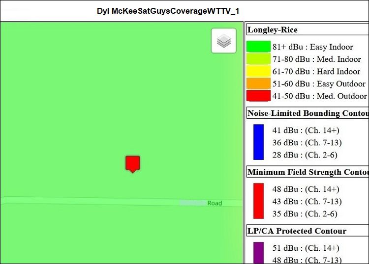

Going from 15 ft agl to 35 ft agl your WTHR signal margin jumps from 1.65 to 9.18, which is significant.
Get you a 35' guyed telescoping mast and put it atop the shed where your antenna is now.
