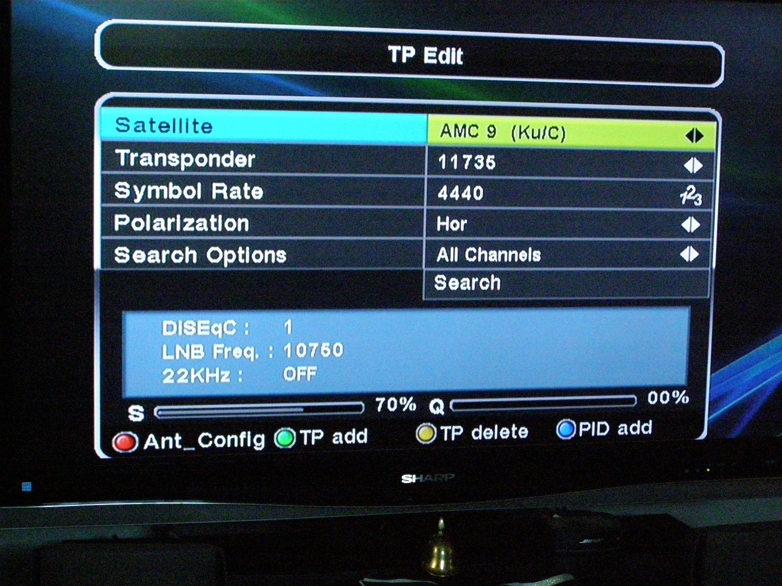

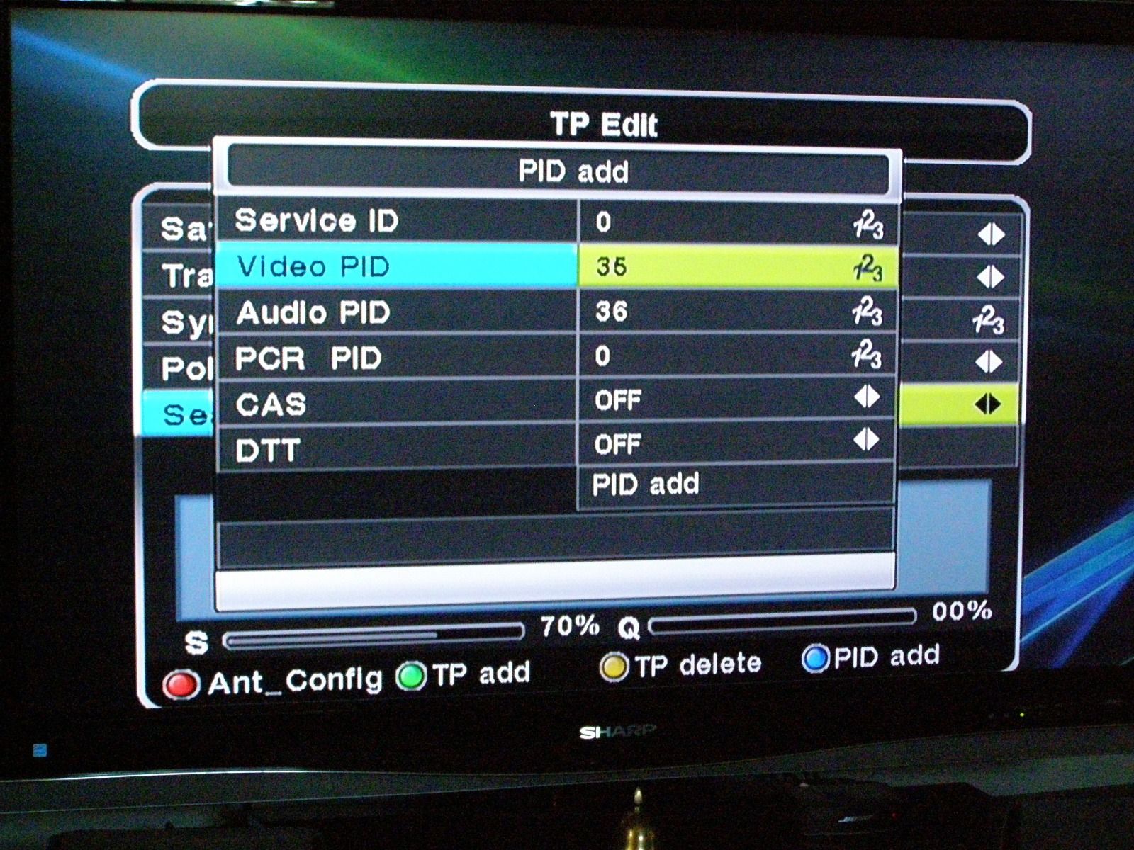

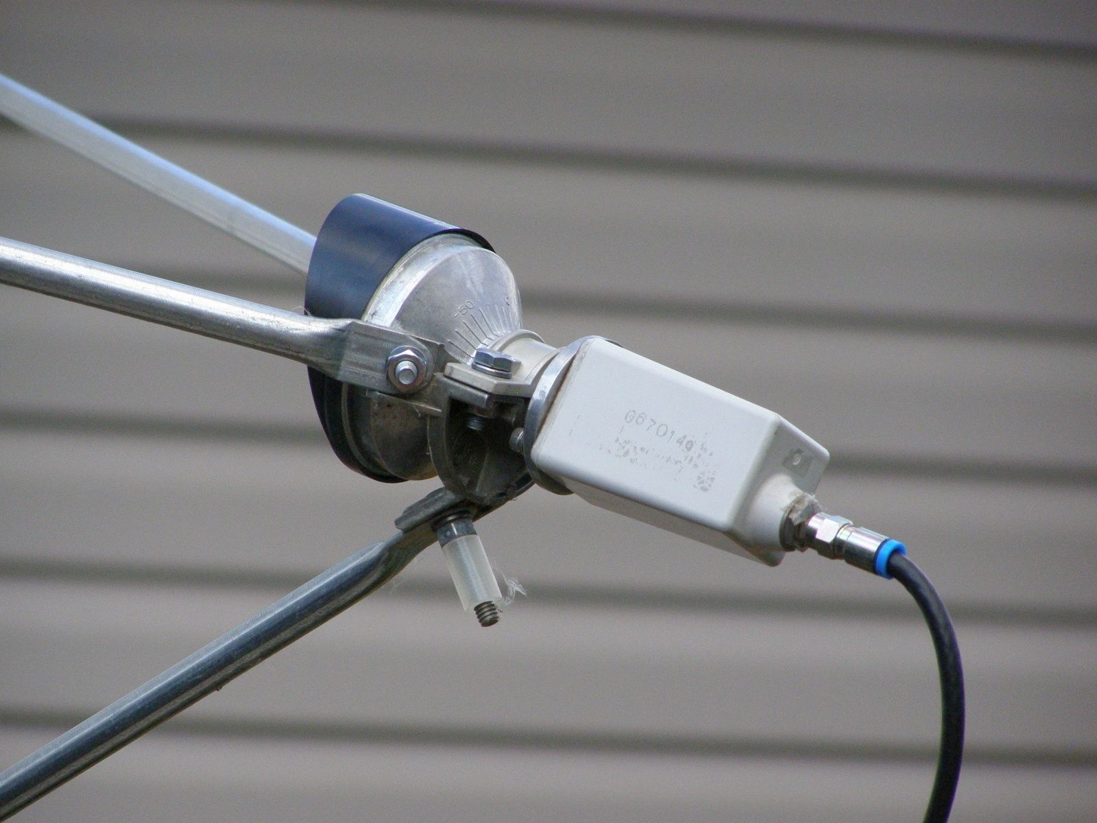

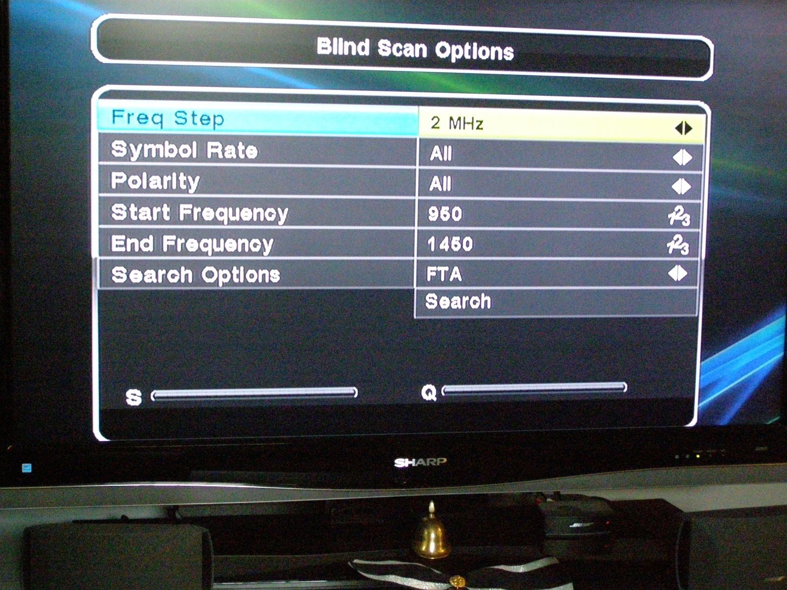

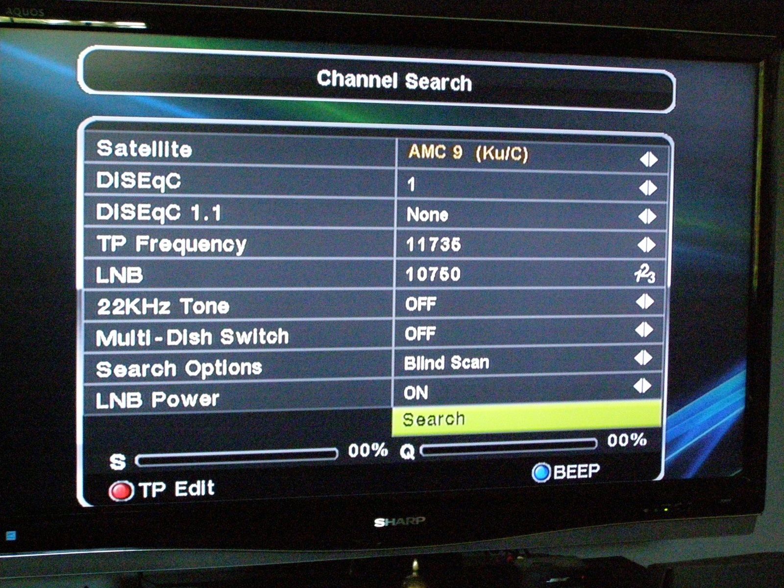

I provided 5 pictures of my current Nano Premium set up.
Still testing ...
Please review the uploaded pictures - maybe you can see something I can't that is keeping me from recieving RTV / TuFF.
1 - My LNB.
2-5 is the step by step set up.

Last picture appears to be a single polarity lnb and a feedhorn. twist the whole shebang 90° in the holder to get the other polarity. When/if replaced with a LNBF you'll get both H and V. Nice to use if only one polarity is wanted/needed. My spitfire died about 3 weeks ago, after being used for about a year, but it did work good. Back to some generic Ku LNBF's so some weak, barely locking, TP's are now unusable for me. Oh well, almost all were of the itinerant variety anyway.
