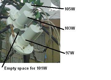

OK, You will need to use AMC 1 103W as main. You will need a Spare LNB ring. In order to get the 2 degrees apart you will need to modify or cut out using a jigsaw so the 2 LNBs end almost side by side (see the photo below)
AMC 1 103W
3840 H 26681 IONs Mux #1
4161 H 26680 IONs Mux #2
AMC 18 105W
3760 V 28068 NASA Mux
3920 V 30000 Bounce TV MUX
3940 H 30000 Telemundo MUX
3780 H 30000 NBC Mux (this is the hardest to get)
